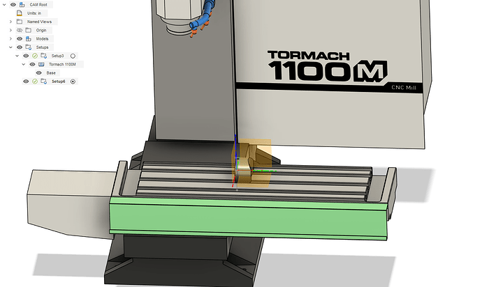

Hello Everyone:
I recently purchased an 1100 PCNC for a small business that we are buying. This is not a CNC business to be clear, but rather, the CNC will be producing some of our parts that we assemble. All of our parts are plastic, so they are relatively easy to machine.
What I am really (and I mean really) struggling with is integrating the 4th axis into my Fusion 360 setup. I have the older 4th Axis (6” motorized table PN 30290), but it is brand new. I have searched and searched on how to get this to work. For example: under “Setup”, it asks for machine. If I select my Tormach, it obviously does not allow me to “turn.” If, under “Operation Type,” I select “Turning or Mill/Turn”, I get a “All Machines Hidden By Filters” message.

Neil,
Nothing with selecting a machine is required to post a program, I’ve never set it up. Anything related to 4th axis is done with “milling”. The main thing is selecting the orientation of Z correctly so that A0 matches between the machine and Fusion, if needed, select the “tool orientation” box in your toolpaths.

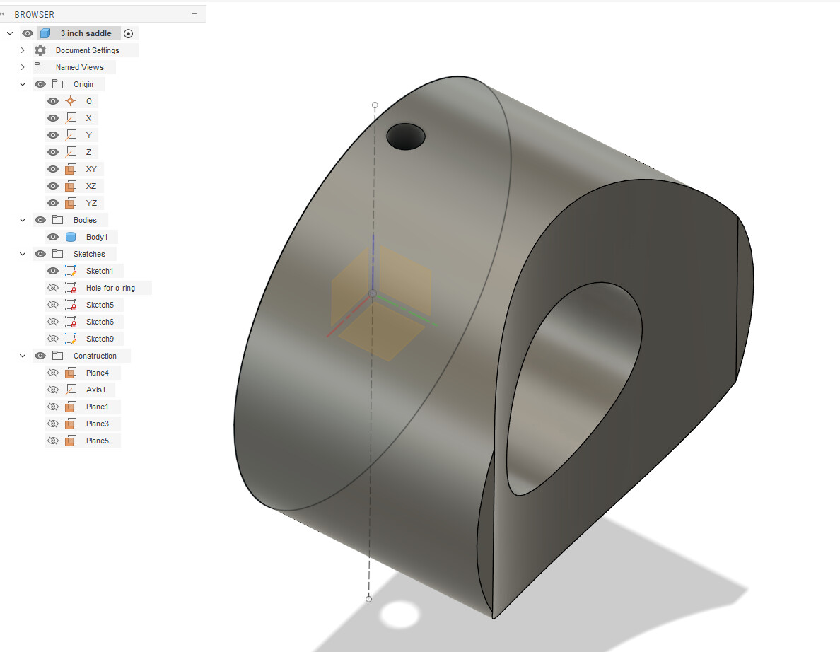

I have a number of other questions about axis alignment on the part and how to do only part of the milling operation (the concave feature) before turning the part 180 degrees and duplicating the process.

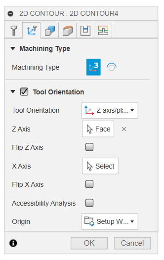

The actual “go here to make this cut” for indexing is setup per-operation. Here’s a contour cut on a part at 90 degrees– All I did was pick the new Z-axis (in this case another face that is perpendicular to the cut)/plane and Fusion (I use the Tormach post) outputs the G0 A90 before the cut begins.

I’m sure there are better answers to your question on how to cut the concave feature, but my first solution would be to just use the 2d bore toolpath. If the size of the part is too large to take it all in one pass (plus a finish cut?), you can just run it with radial stock to leave (Passes tab?) then run it again, or configure “multiple passes”. Of course, you would want to be sure that the Z orientation is correct under the Machining Type tab.
You could also probably use the 2d contour and just pick that bottom edge. Then you’d want to check the Ramp box (same tab as lead-in-lead-out), but the same strategy would apply as far as multiple passes.

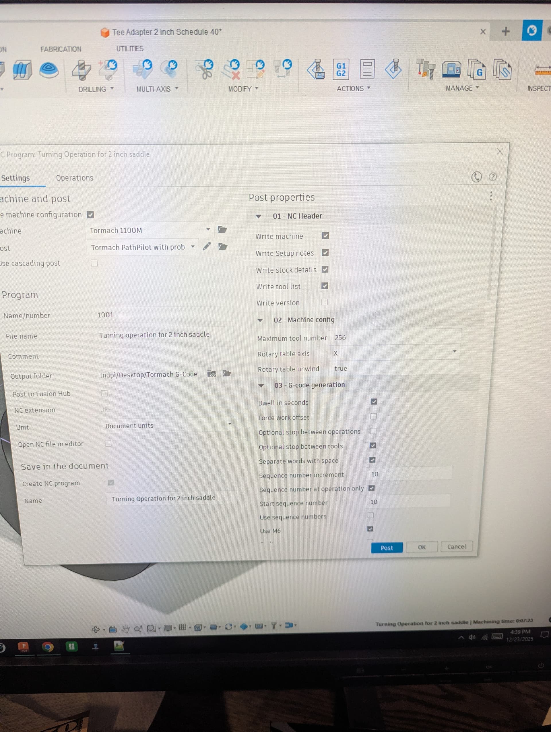

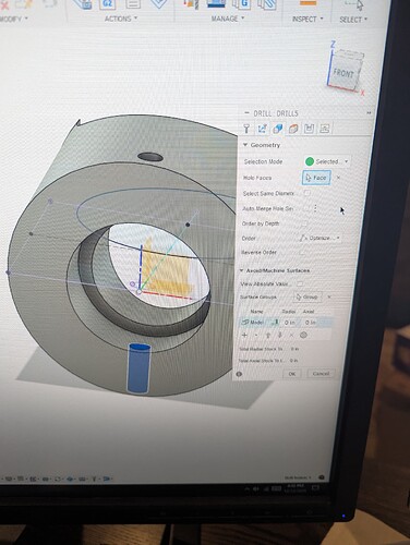

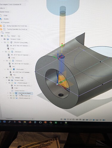

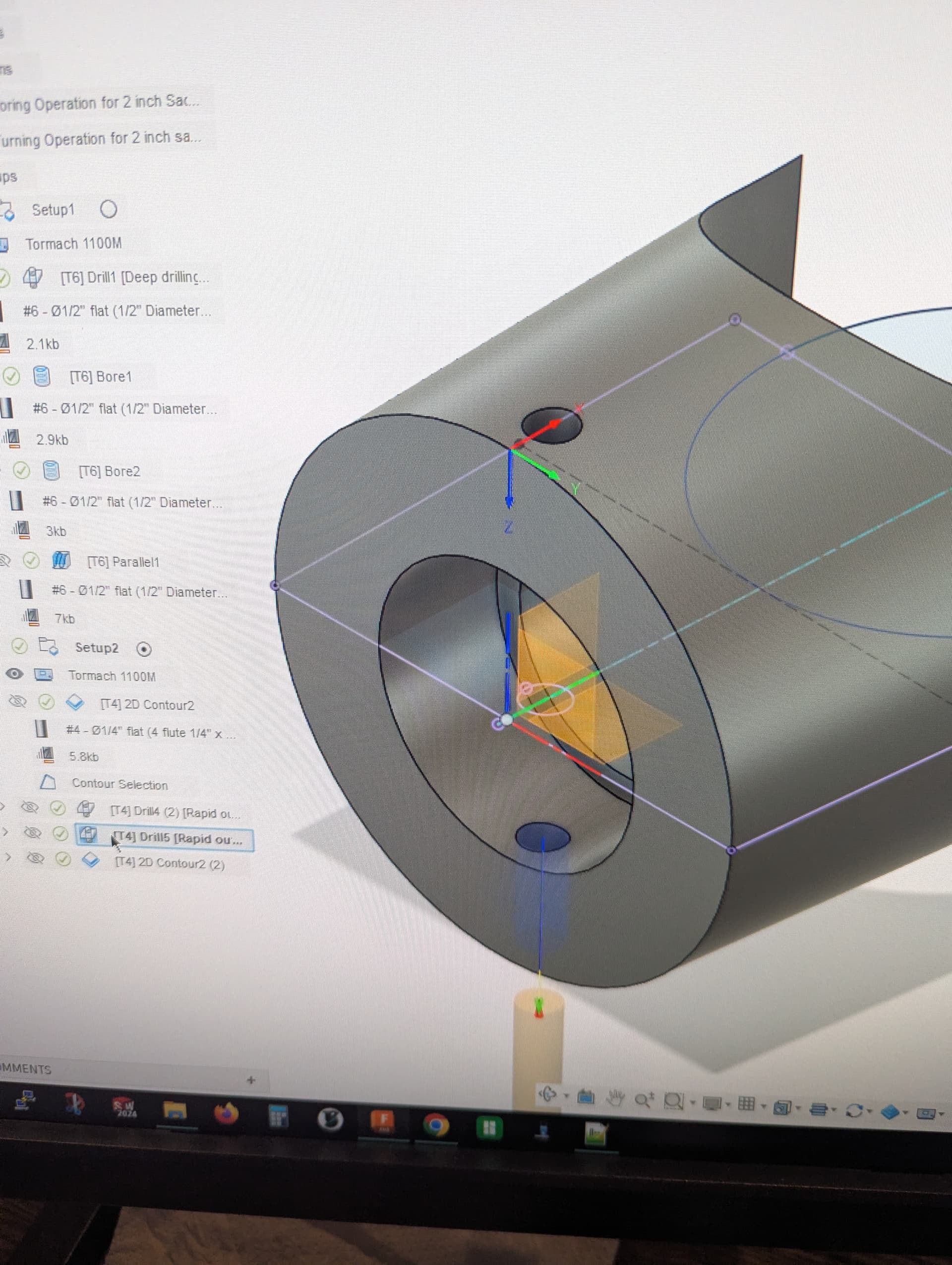

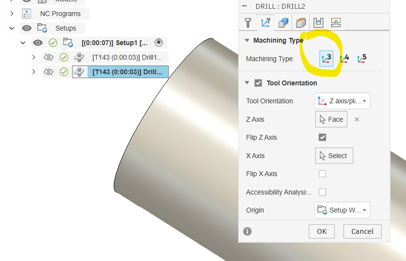

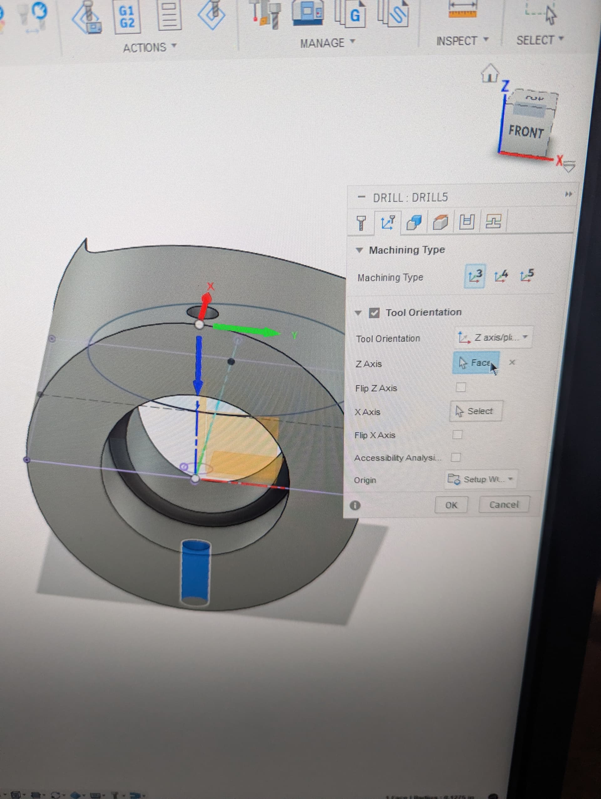

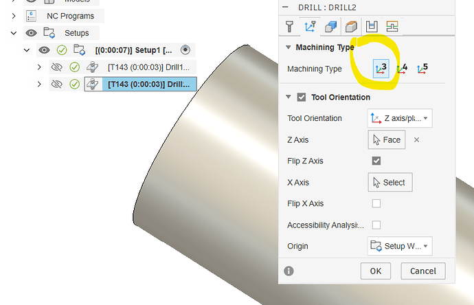

I am back to trying to set up the 4th axis in Fusion 360. I had a drilling operation on my round part, which is held by the 4th axis, to drill on one side, then spin 180 and drill again. I kept getting an error of “unable to generate toolpath”. After hours of troubleshooting I finally clicked on the red diamond. It said, “Your License does not allow generating operations using option “4-axis” for parameter “Machining Type.” Great. I do have the paid version, but apparently I didn’t pay enough. Or, maybe I am missing something.

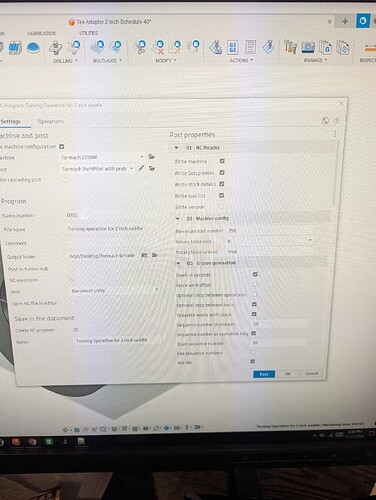

I downloaded xoomspeed’s postprocessor, but not sure if his post would change this outcome? If so, how would I integrate his post into my machine setup to essentially override the Fusion paywall? Maybe it can’t be done. Might have to had code the a-axis flip in the file….

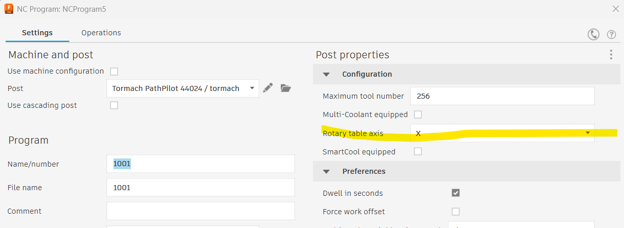

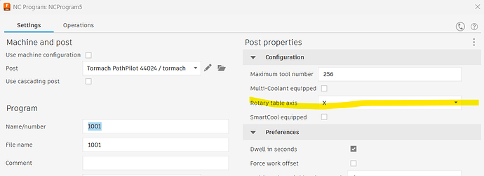

Try two ordinary 3D drill ops with tool orientation, one from either side. Be sure in the Post Properties to set the axis of the rotary.
Roger that. I will give that a shot.
EDIT: Now that I think about that Roy, that will drill the other side but I don’t believe that it will actually put a 4th axis move into tree. I can do a manual NC as a passthrough which would work, but any toolpaths with that move are not evaluated by Fusion, not that that is necessarily a big deal for what I am doing.
Seems like Fusion is getting right up there with Solidworks for their pricing.
My minimal-paid-for F360 seat pops in an G0 A180 when I do the above if the part WCS has Z the other way up.
N20(Drill2)
S8000 M3 M8
G0 A180.
G0 X0.8223 Y0.
G0 G43 Z1.6 H143
G0 Z1.2
G98 G81 X0.8223 Y0. Z0. R1.2 F20.
G80
G0 Z1.6
M5 M9
G30
G0 A0.
M30
I am going to attach some pictures. As far as I can tell, I have it set up exactly like yours. Mine is not adding the rotation.
