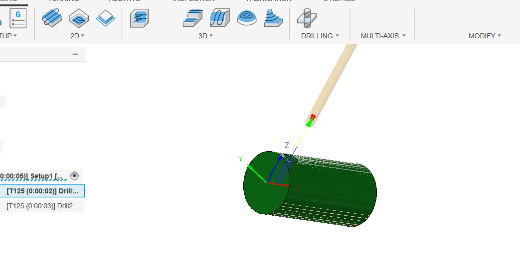

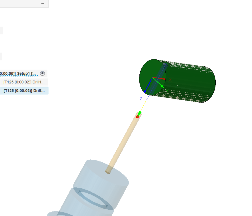

In the design workspace I made a cylinder and put a hole through it (using the cylinder and hole tools, no sketch needed), moved to manufacture and new setup. Set the stock WCS to the centerline at one end, then added two drill ops using a random drill in my library– the first drill op was at the original WCS, selecting the top of the hole, then the second drill op used the tool orientation option to only tick the ‘flip Z’ button. Selected the other end of the hole for the geometry and hit ok with all the other stuff just defaults (no machine selected in the setup). Posted it with Tormach PP Post (#44024 although I don’t think that matters much) and got the A0 moves. Maybe try copying that just in case there’s something in your geometry that is annoying Fusion. Should only take a few minutes.

2nd op, after ticking Flip Z and selecting the other end of the hole.

Well…. that worked Roy. Now I will need to try it out on that saddle part.

When you post out the operation for the second drilling op just search the NC file for an A180. That will tell you if it’s moving to the other side or not. If A180 isn’t there search for A0, if it’s A0 then the setup in fusion isn’t correct.
