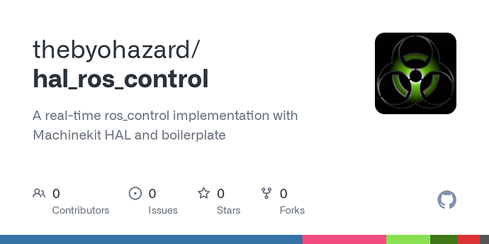

The launch process becomes a hal component in hal_ros_control, in the hal_hw_interface/launch python code.
  • hal_hardware.launch.py creates a HalRTNode and HalUserNodes.
  • In order for these nodes to check if hal components are ready, they try to access the hal system by checking if it is a registered component.
  • When performing this check, (self.hal_name not in hal.components) the launch implicitly registers itself as a dummy component.

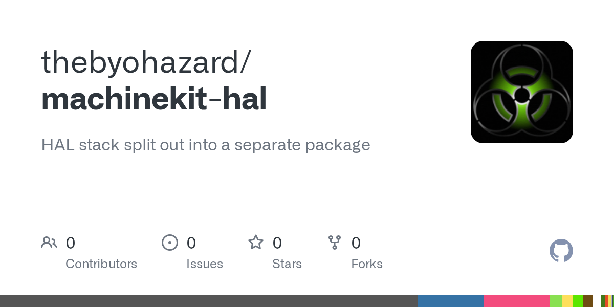

  • add the ability to de-register/disconnect as a component in machinekit-hal. Then have the launch de-register itself after it is done launching, since it doesn’t look like it needs the hal connection after that. This modifies the upstream machinekit-hal, but I am already using zultron’s fork anyway. But I am not sure if this makes sense in hal.

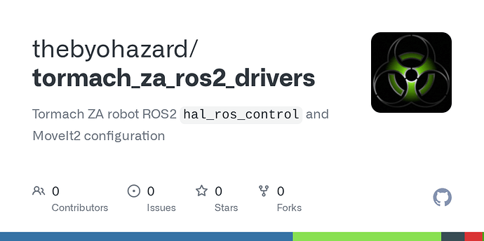

My za6 is now moving on jazzy/noble!!
All the code is pushed to my fork of tormach_za_ros2_drivers.
I didn’t do the demo stuff, but it’s in its own commit if you want to put that back.
Also, I had to build machinekit-hal and linuxcnc-ethercat from source, but all of that is in a separate commit for whenever the upstream of those for noble get released. Hopefully that’ll be an easier change since it’s all grouped together.
