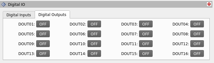

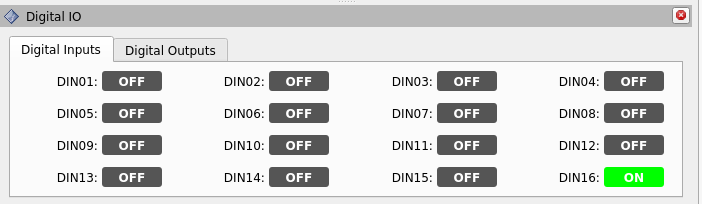

@John_Morris Apologies for the delay but I got tied up with other things. I finally implemented the RViz panel that shows the digital i/o. I generated a PR. For others watching, here are a couple of screenshots of the UI:
Edit: As an old coder, I absolutely love working with the help of AI. I also wouldn’t want to be a CS grad in 2025.
@futnuh Wow, helluva PR! Here’s the link for those watching:
Your IO panel screenshots look great.
I’ve only had a quick look, but your code looks great too, nicely done! We can continue the discussion of merging the PR there, but I’m betting we can merge it without much change.
Also, your panel could easily be generalized for use with any ROS robot that presents IO pins as ROS topics. It almost seems a shame to hide it away in the ZA6 repo. Consider announcing it on the ROS Discourse, and hosting it on your own GitHub so the ROS community can find it more easily. If you wanted to go that way with it, we could pull your package into the ZA6 project with a link from the repos.yaml and some type of integration into the za6_bringup package.
Thanks so much for the PR. Yeah, things are a lot different for kids today, compared to when I was a kid, sitting at the Sun workstation and cribbing from my copy of K&R. :smiley:
@John_Morris I just created a PR that implements the safety (quick) stop functionality that was present in the ROS1 system. The PR has a markdown description that gives the details. I verified that this works on my robot (with the older servos). Might be good to have someone test it on newer model servos. It might be that they need to plug into /din12 given that:
  • EtherCAT digital input IS620N: lcec.0.6.din-15 → hal_io.digital_in_16
  • EtherCAT digital input SV660N: lcec.0.2.di5 → hal_io.digital_in_12
For those wanting more details, see

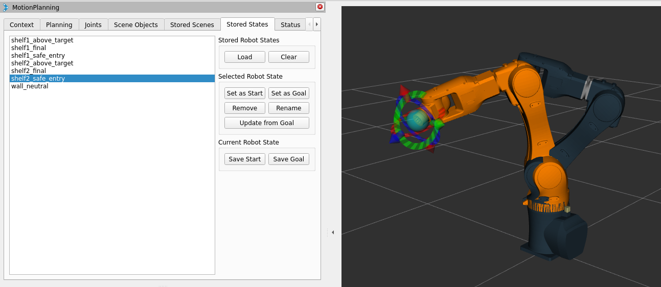

@John_Morris I’ve made a few convenience tweaks to the MotionPlanning plugin for Rviz. Specifically,
  1. Clicking on the state in the list visually updates the goal state in the 3D view. Seems obvious to me that you might want to see this rather than just depending on the waypoint (state) name … but it didn’t do this without hitting the “Set as Goal” button.
  2. Added a button to allow renaming of a state.
  3. Added a button to allow updating of an existing state based on the current goal. This is useful if you need to make a minor tweak to a waypoint. You just move the goal handles slightly in the 3d view and press update. For bonus points, a modal dialog warns if you try to make an adjustment that causes a joint/pose delta > 0.1.
I guess these are generally useful to anyone using the open source version of Moveit2. Perhaps at some point I can create a PR for folding these back into the upstreame Moveit2.
Oh, also, these changes are persistent in any attached warehouse storage. I’ve got that working and am currently using SQLite.
Git address for this work is:
P.S. For anyone reading, John contacted me out-of-band to say he’s watching these updates but is currently tied up. He’s not ignoring this sudden burst of energy at my end.

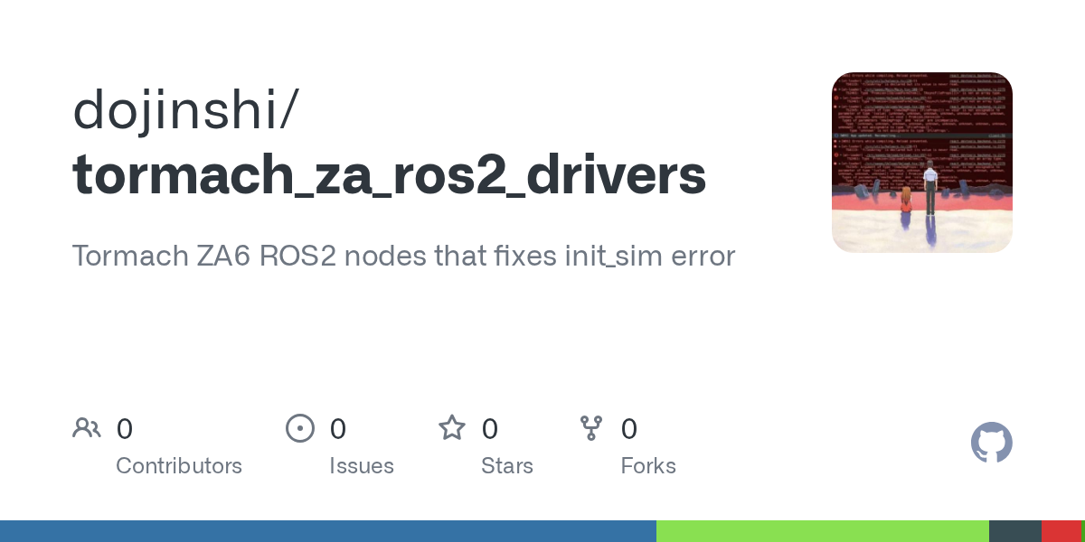

Quick update on this: I pushed a new repository that fixed my issues for me. Some classes were being called that my system could not recognize; if you’re running into the same issue that I am you can give my repository a quick look:
