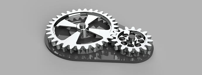

This image is not exactly what I will be machining, but something in this realm:
Link to model: https://a360.co/4rXNLEK

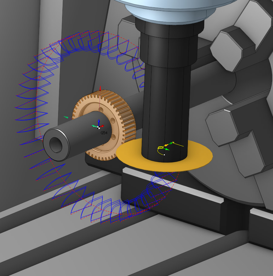

Then I install in a mandrel and mount in 4th axis and cut exterior gear teeth using a gear cutter mounted in a arbor saw tool holder.

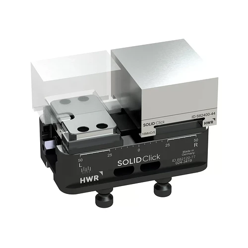

we use for these jobs a zero-point system:

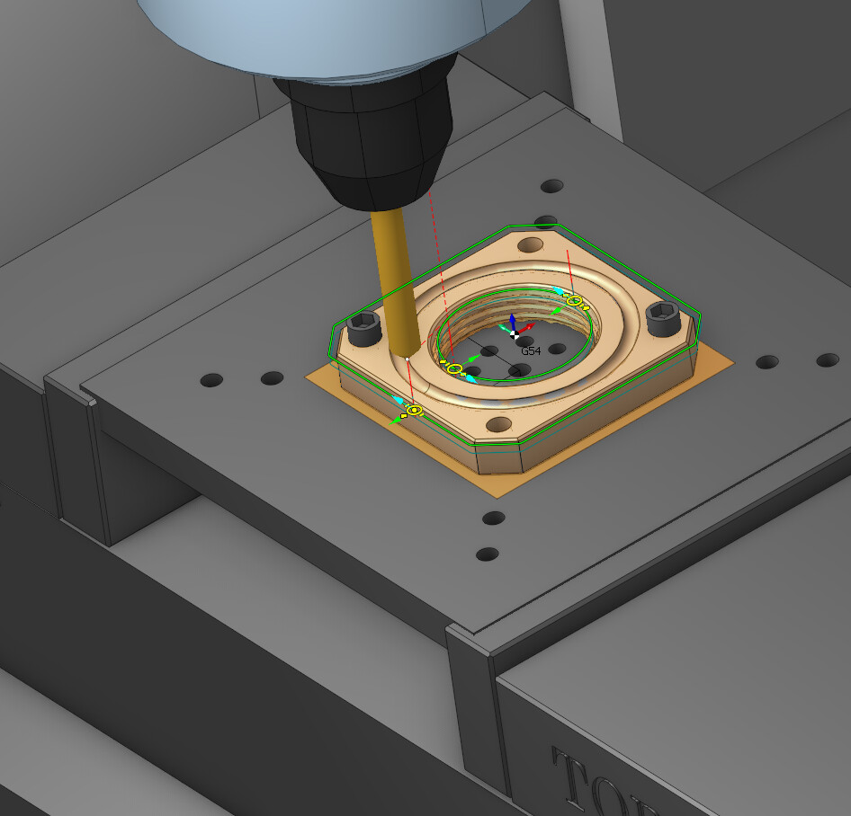

Quick question, with the first scenario where you machine the interior features, then flip over and use screws to hold the part in a pallet cut to the negative form of the interior, I follow the process, but don’t understand how the screws holding the part to the pallet don’t get in the way of machining the second operation?

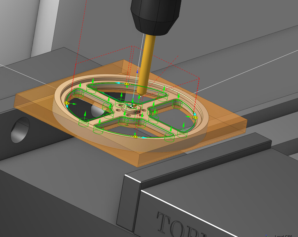

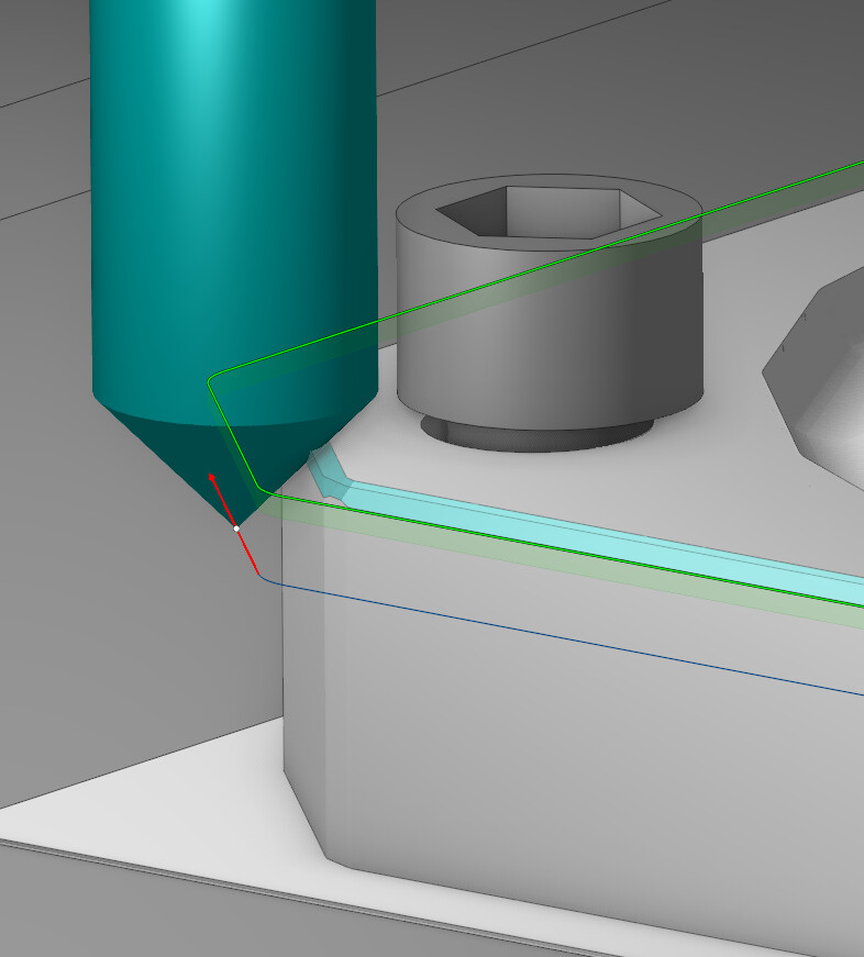

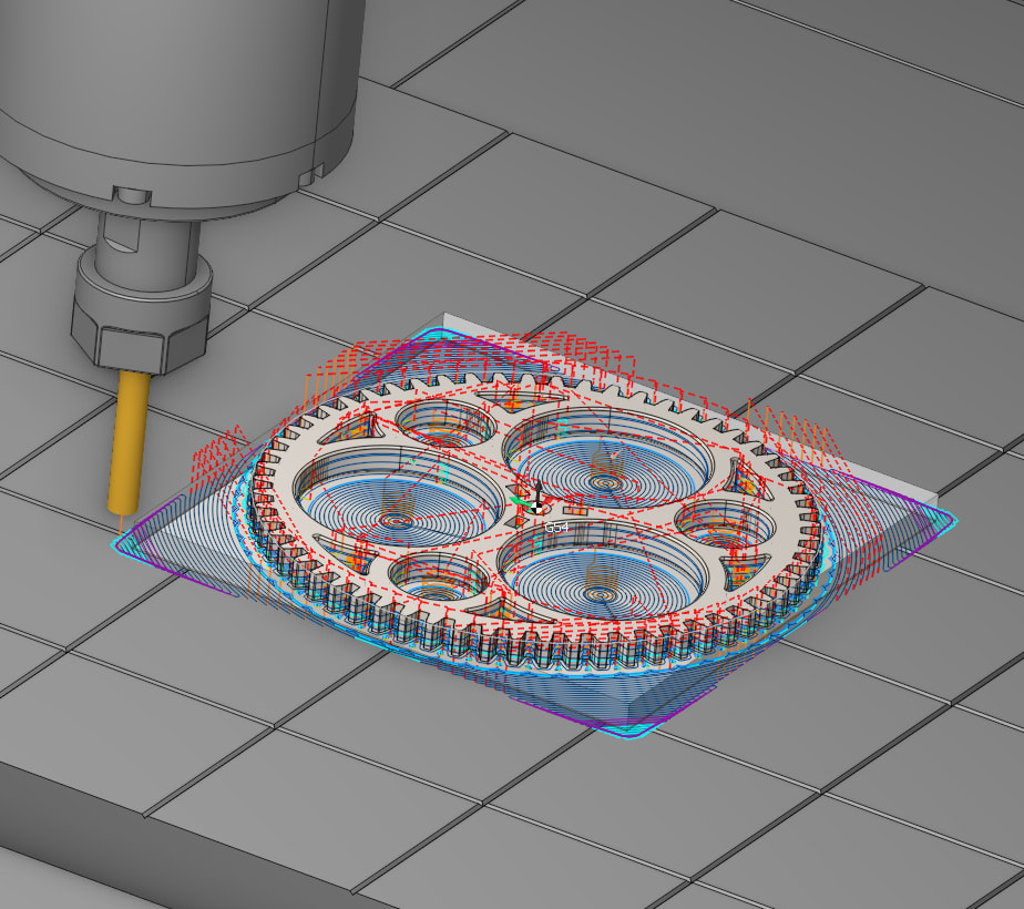

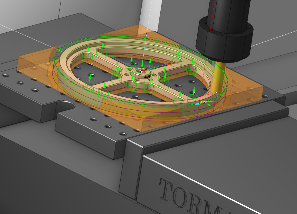

I included the screws in the fixture setup in my cam program setups. I use collision detection to see if I am hitting a fixture, plate, screw or clamp. With experience the extra time spent including all fixtures in cam setups will save on drama and broken tools . Shown below
running the simulation I can review and adjust tool paths to avoid or get very close to fixtures.
In this case the part was flipped an O-ring groove, perimeter milled, and edges chamfered with the tool paths avoiding the screws.
The main idea is the inside and outside fixturing method.
mill interior features with the exterior clamped.
Then mill exterior features with the interior of the part used to hold it.
This one fixture method can be used for making many types of parts.

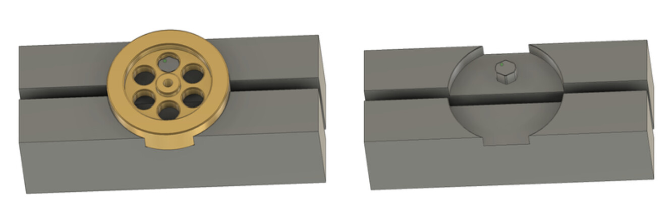

A cylinder bore will do fine with aluminum IME with aluminum soft jaws. Make the bore close to full-depth on the gear. You don’t need to index it if you are just cleaning off the extra stock for a flat gear, but if you do want to do something cosmetic that matches up to the other side (chamfering the teeth or spokes, etc), you can put an index pin in somewhere convenient or machine the jaws with matching teeth.
For a one-off however, I’d probably use a fixture plate over making soft jaws, even if that fixture plate was just a bit of flat bar with a few holes drilled to bolt the first op down.

Roy, I’ve made a bunch of soft jaws in the past but did not think of them for these gears. Below is an image of one I did for a flywheel that I think would work well for these gears.

Most of the time I keep this in mind and use a lathe to create exact center and diameter “very important”. Then clamp in mandrel or expanding arbor and cut teeth on 4th axis on mill.

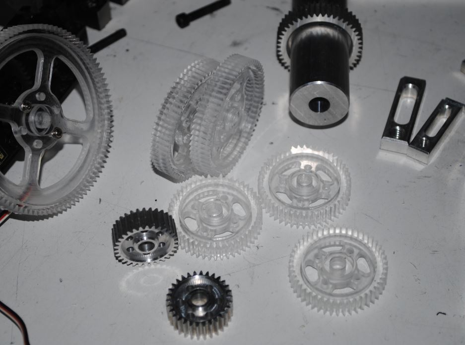

I also made a few different sized gear depthing tools “pictured below unfinished” to establish correct on Shaft center measurement verse theoretical. These are handy to fine tune shaft spacing and can be made in different sizes and styles.

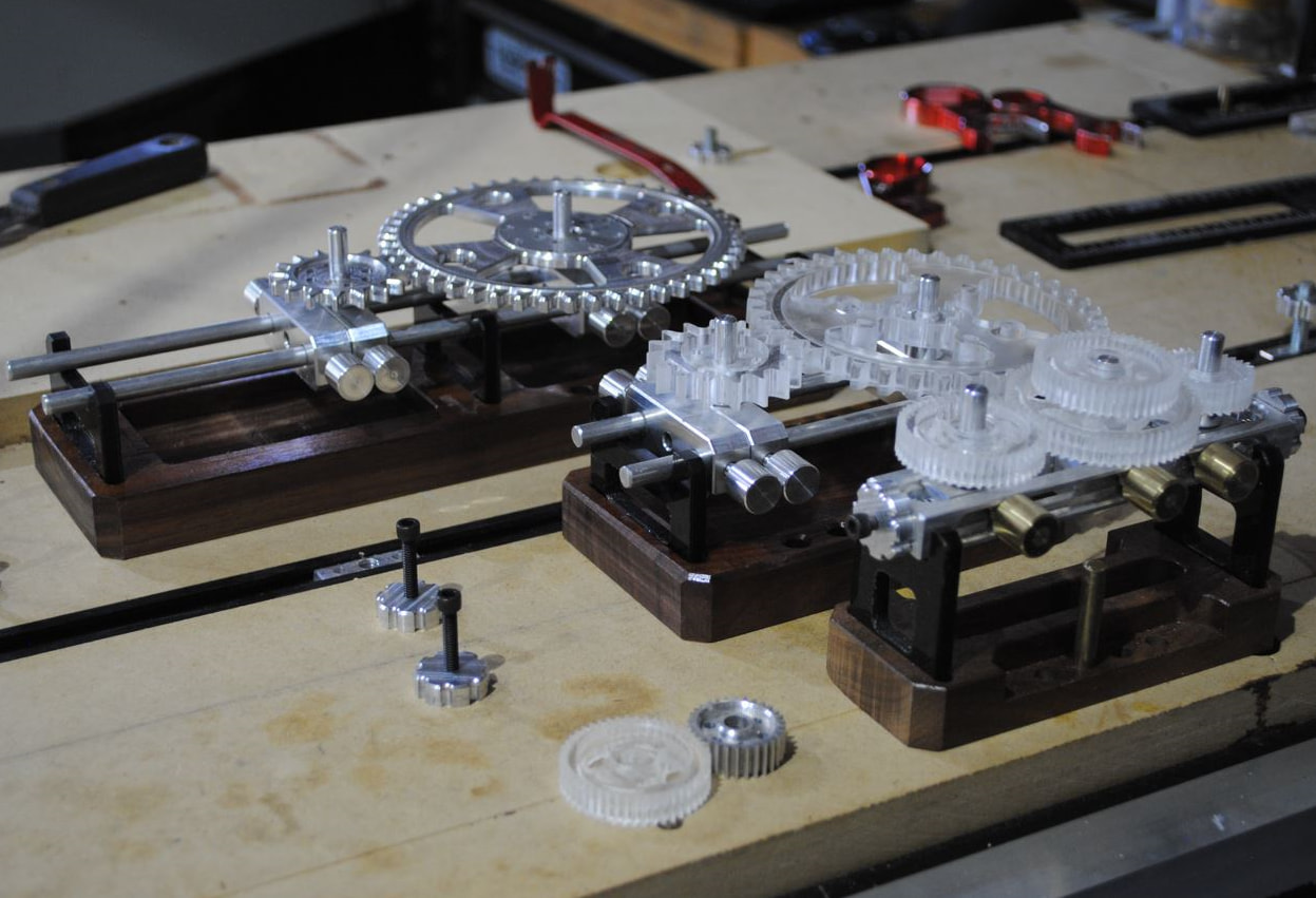

Some gears are to big like the clock gear show below.
I use router or mill depending on material and use any number of work holding methods depending on their design. I have done these in sheets where there is a half dozen different clock gears all cut on router at one time.
