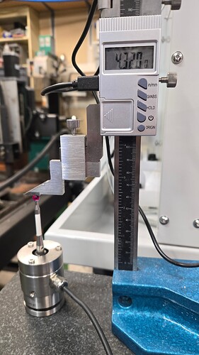

I have followed the directions to set up the probe… X & Y are good, yet I cannot get the Z to set correctly. Manually measuring the lenght of the probe I get 4.3215 yet when I use the “set-up” it comes up with a lenght of 3.45

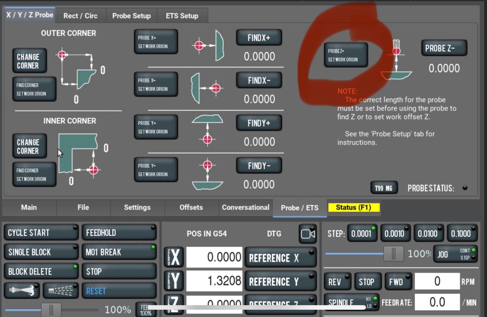

Did you reference spindle nose? And then set probe length? Third tab on probing menu page.

I mean set the probe length to the same 123 you reference the spindle nose to.

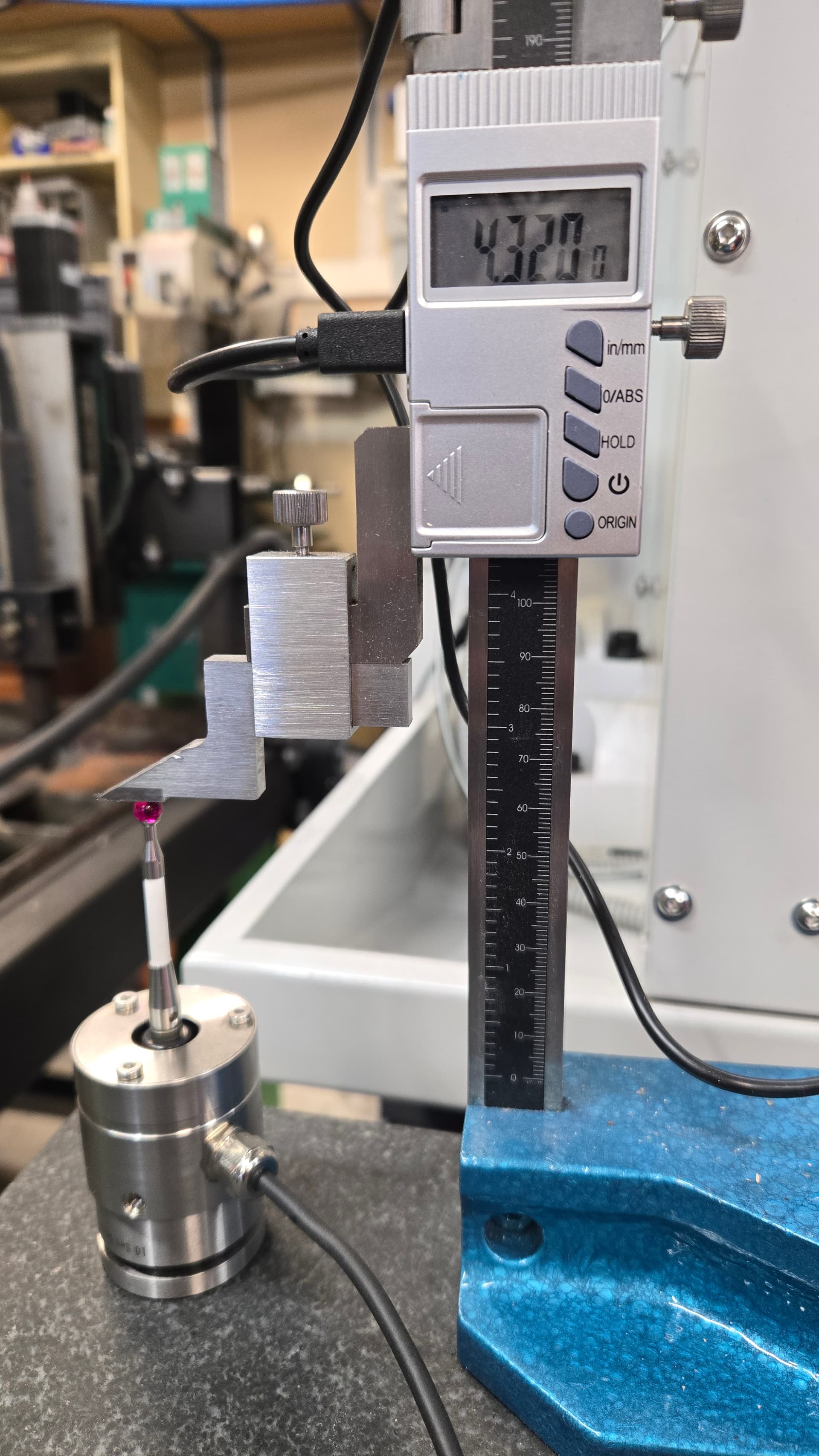

Exactly… but when I set to the same 1,2,3 block it gives me a tool lenght of 3.4548 and when I measure it with my height gage it’s 4.3215. When I use the probe on a program it does not bring the tool down to the work piece…

Also in the probing menu are you clicking the circled one?

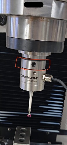

So far I have only probed the back left corner, then set the Z height using both of those buttons, when I try to run the program the face mill starts about an inch over the work piece. The difference I measure from the “set-up” process to my manual mesurement is 0.8667 difference. The stylus length difference is 15mm or 0.590 so I’m not sure exactly what to do here

I ordered an ETS but it has not arrived yet… for tool height I’m using the surface plate and a digital height guage for now. Using the height guage I get a tool lenght of 4.3215 just touching the end of the ruby… The machine when I do a Z setting using the “Set-up” is giving me 3.4548

How tall is your tool setter? You’re off by almost a whole inch so it’s got to be something that size. Something .8667 in tall

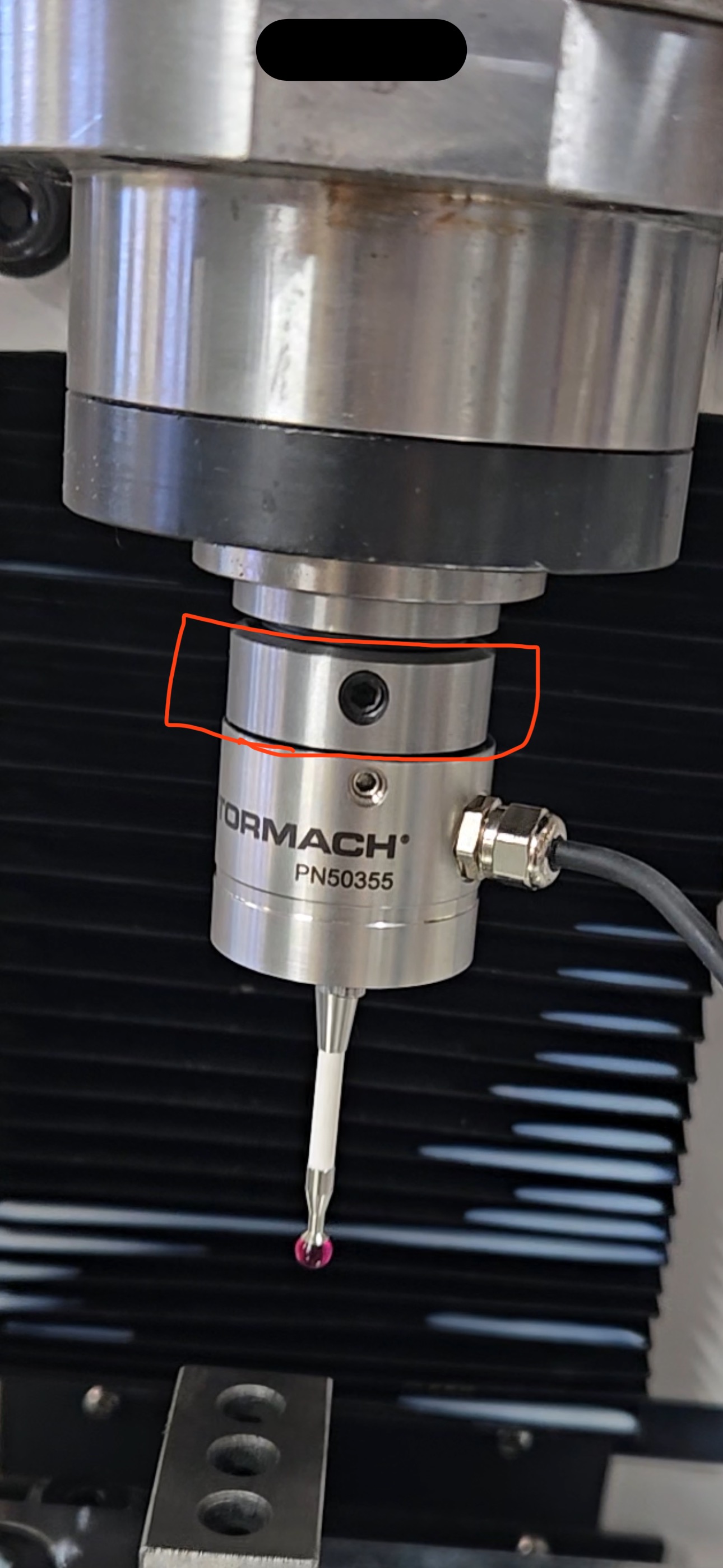

Must be something I’m not seeing. What spindle type is that? (It’s not bt30 like my machine.
Are you removing this from the spindle when referencing? The spindle nose?
And do all your tool holders have that same size (collar thing)?
Is it .8667”?
It’s the TTS set-up for the 440 mini mill. That collar is part of the probe as it came in the box, not part of the spindle or any of the other TTS tool holders.
