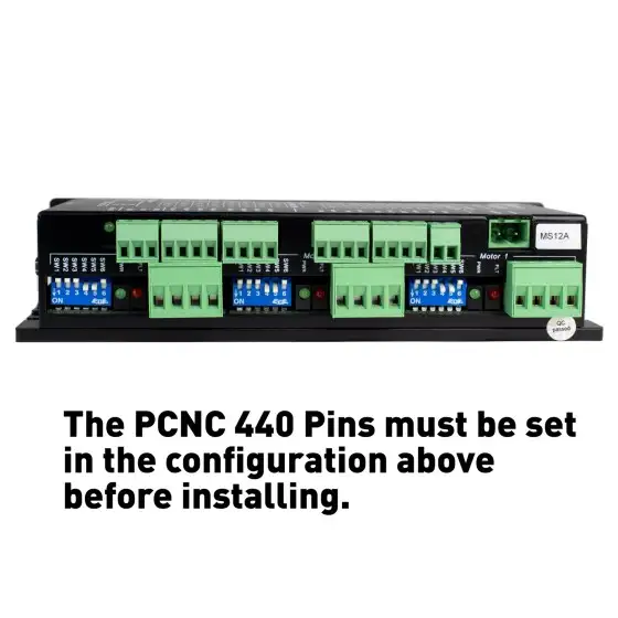

Hello everyone,
I was able to work with Paul on a virtual call today and we discovered that the MX3660 dip-switch settings were not correct from the factory. I understand that there were a few others on this thread having a similar issue so I wanted to make a public post that if you are having any kind of linear motion issues on a PCNC440, it might be a good idea to open the electrical cabinet and make sure that the little white switches on the three blue tabs look like this picture:
