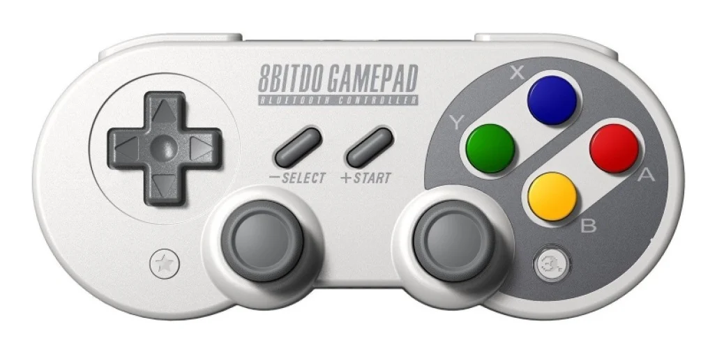

I’ve recently migrated to Tormach’s ROS2 drivers. Over the last couple of days I’ve been working to add teleoperation via a USB gamepad (in my case, the 8bitdo controller:
The end goal is to be able to smoothly move the robot around using the controller, setting waypoints, initiating playback, etc. Previously (under ROS1 using RCL), jogging was quite “stuttery” because it was a sequence of individual moves that all started and ended with velocity zero. The current approach should let us specify joint velocity (rather than position) goals.
