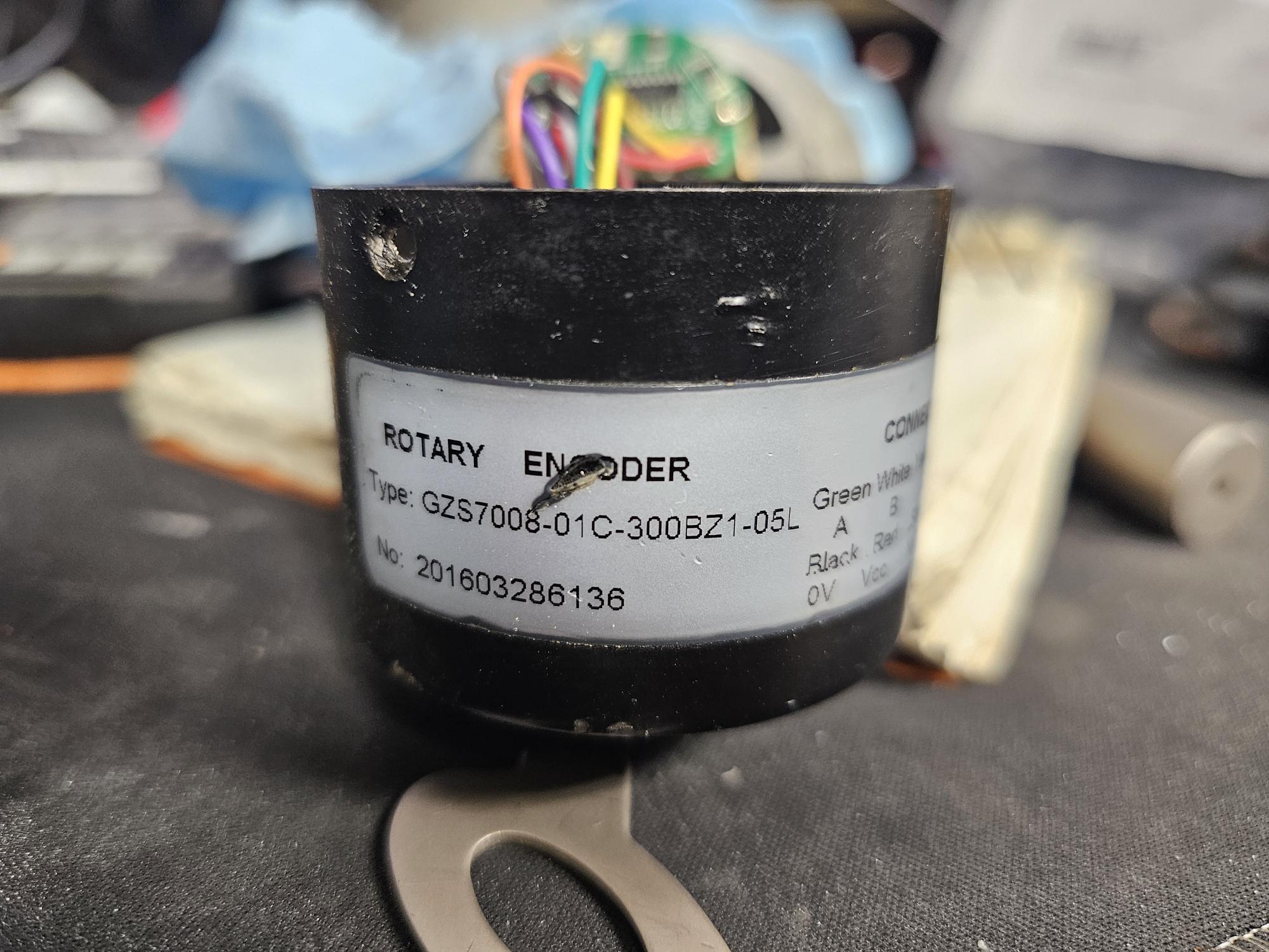

Hi, is there a way to test the spindle encoder, I had thread to do tonight but when the threading tool goes to the start position close to the part, the tool stays at this position and after a couple of second, I get an alarm that it can’t synchronize.
If I rotate the spindle by hand, I can see the A and B led from the encoder in the status page,
with the encoder DRO counting.
Thanks for any help, Jeff

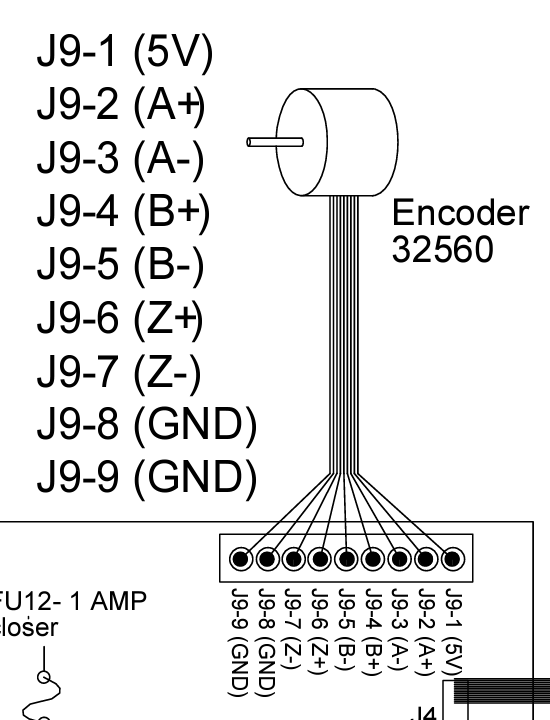

Go to here.
Spindle encoder
Type ADMIN ENCODER TEST
To run encoder test.
This admin encoder test command does not work on the lathe
Thanks, I tried with many programs, and it does not work.
ADMIN ENCODER TEST does not work on the lathe

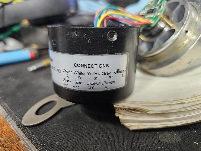

Ok, replaced the encoder and threading is working now, got some help from Tormach, Thanks
