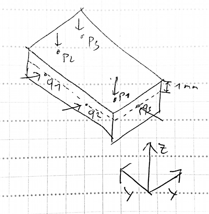

Creating a work offset from 3 points on a plane can be done using calculate_work_offset_3, I would use this for first measuring the top/Z plane of the vise. (p1, p2, p3 in the image)
Using this new work offset, you can then measure two points each on the Y and one on the Y axis of the vise, let’s say 1 mm below the vise top surface. Those 3 points (q1, q2, q3) will be on a 2D plane, which makes it possible to calculate the origin point of a rectangle containing those 3 points. Add 1mm in z to the calculated rectangle origin point and to let’s say q1 and q3 to create a new work offset aligned with the vise top surface, origin in the bottom right corner.

If that is correct, if probing a (perfect) plane should always result in the same amount of deflection. This would make it possible to create a work offset and then approach aligned with the Z axis to measure the actual Z tool offset, including the probe trip offset.
Good point. It could be a 2 step thing (which I also see in the post below). Once you’ve established the plane, then you can approach at a known orientation to do an accurate measurement on a known axis.
Smart! Yes. I like this approach a lot. Once you have the plane determined then it’s a fairly straight forward process to grab the corners and set up the origin.
