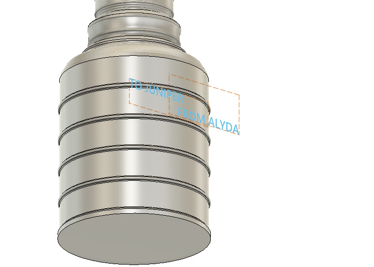

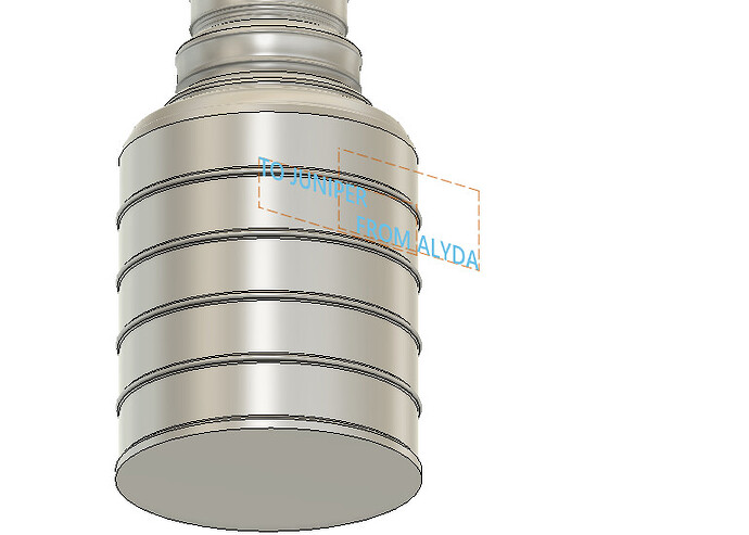

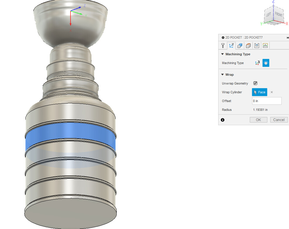

I was curious so I dug into the last 4th axis engraving project I did.
I did a 2D pocket and used the Wrap function.
I also didn’t model the lettering, I just drew them as a sketch tangent to the round surface.

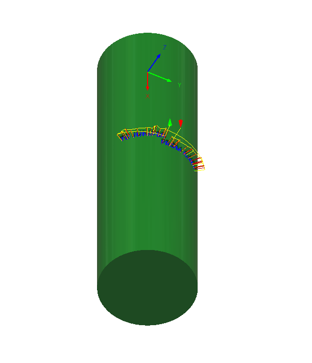

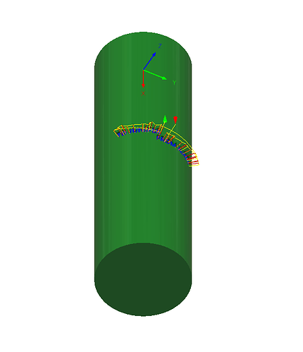

Hello again. Well, its September and we are still trying to get this Microarc working properly in fusion. Obviously we have doing other things but really need to get this working. We are trying to engrave cylinders. we need the A axis to rotate and the Y axis to stay still. Every time we post the A axis turns and the Y axis moves to counteract the A axis so all we get is an engraved straight line.
My guess is that the setup is wrong, or we are missing something. We have had it work by using a model and program downloaded from NYC CNC. Works perfectly. Can’t figure out what they did that we haven’t. So, we know it CAN work but have no idea how to GET it to work. If anyone can help out with this it would be greatly appreciated. Neat (expensive) addition to the machine, NO use in path pilot and NO instructions on how to get it setup in CAM software.
Off the top of my head, I’m going to guess that you have it set wrong in your post processor or your Fusion setup WCS. If the NYC CNC program works, that tells me you have your MicroARC setup pointing in X- (microarc on the right side of the table, with material sticking out towards the left side).
When you build your setup in Fusion, make sure that you set your WCS such that the Y and Z zero are somewhere on the centerline of rotation (which should be the centerline of your cylinders). X zero can be where ever you like but I typically put it on the end of the part furthest from the microarc to make it easier to probe. X axis MUST point along the centerline axis of the part.
The other option is your post processor settings. When you enable the rotary, make sure you have the correct direction set. Again, assuming it’s setup like the NYC CNC videos, that means selecting X-. If you have the correct axis but the wrong direction (+ vs -) it will seem to work but your engraving will be backwards. If you have the wrong axis selected (Y vs X) you will end up with a similar result to what you’re describing.
