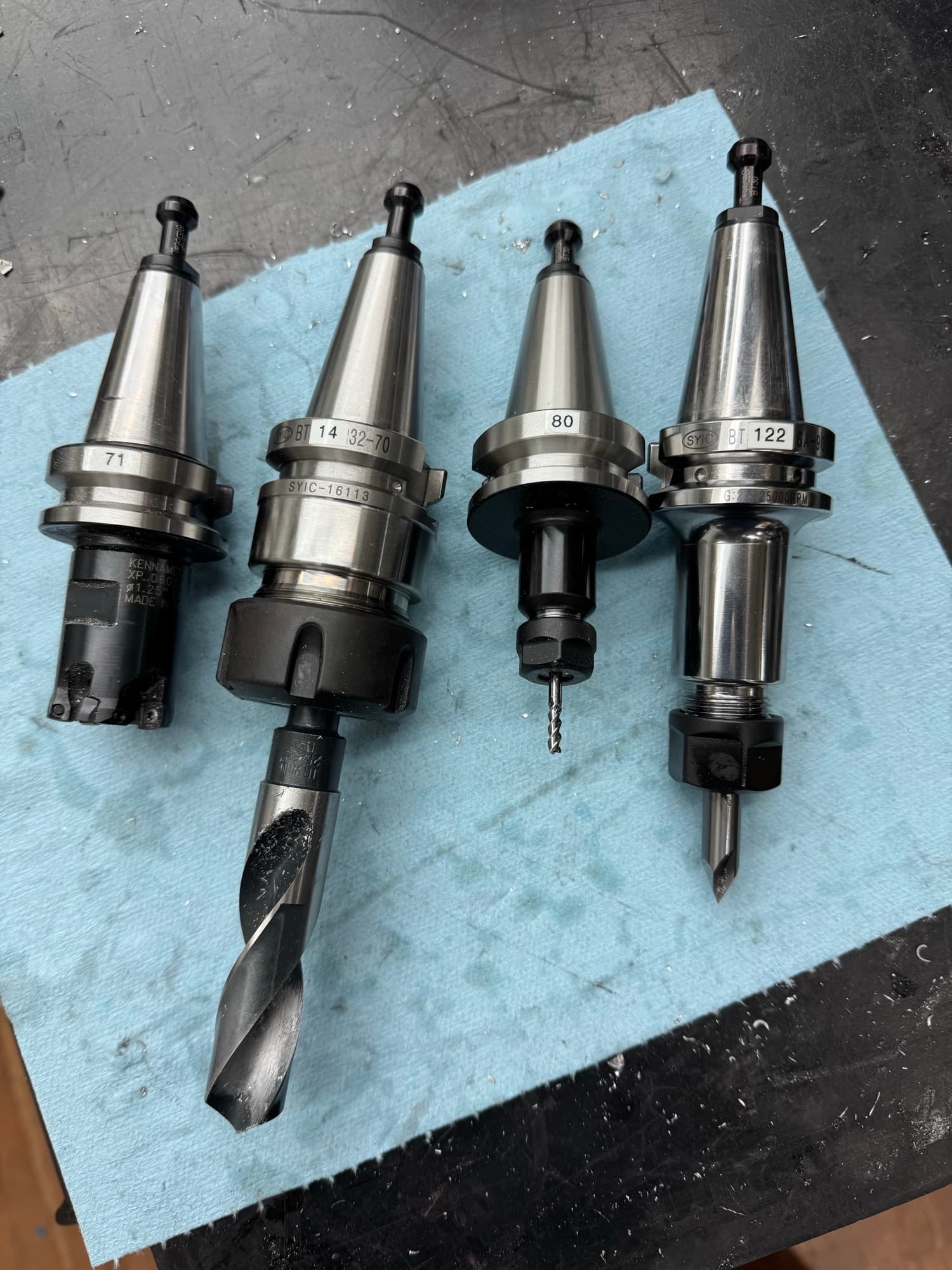

Label wise - I have a Brother PTR-2040C and use TzeS211 - 1/4"(6mm) Strong adhesive labels
those are black print on white background - they make the same with yellow background
that’s the skinniest label they make - I dont have flood coolant - how they would hold up IDK
I think if you properly clean the holder and your fingers before applying the labels I think they will hold up

Here’s a sample of some holders and labels

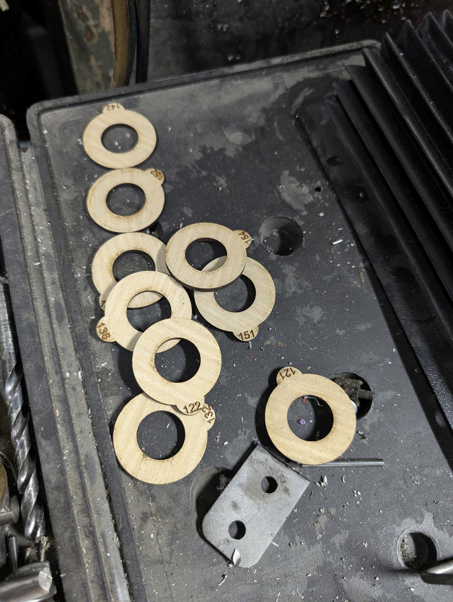

For the poor TTS users we tried paint markers, sharpie, CO2 engraving and now have a fiber laser (that would do great but it’s a lot of work), we ended up using the CO2 laser to cut little ring tags that slide onto the TTS shank and stay with the tool:

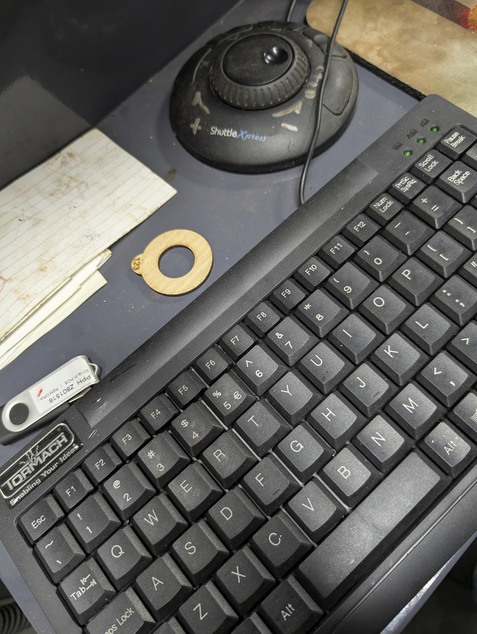

Whichever tool is in the machine has its ring by the keyboard to try to minimize setting the wrong tool:

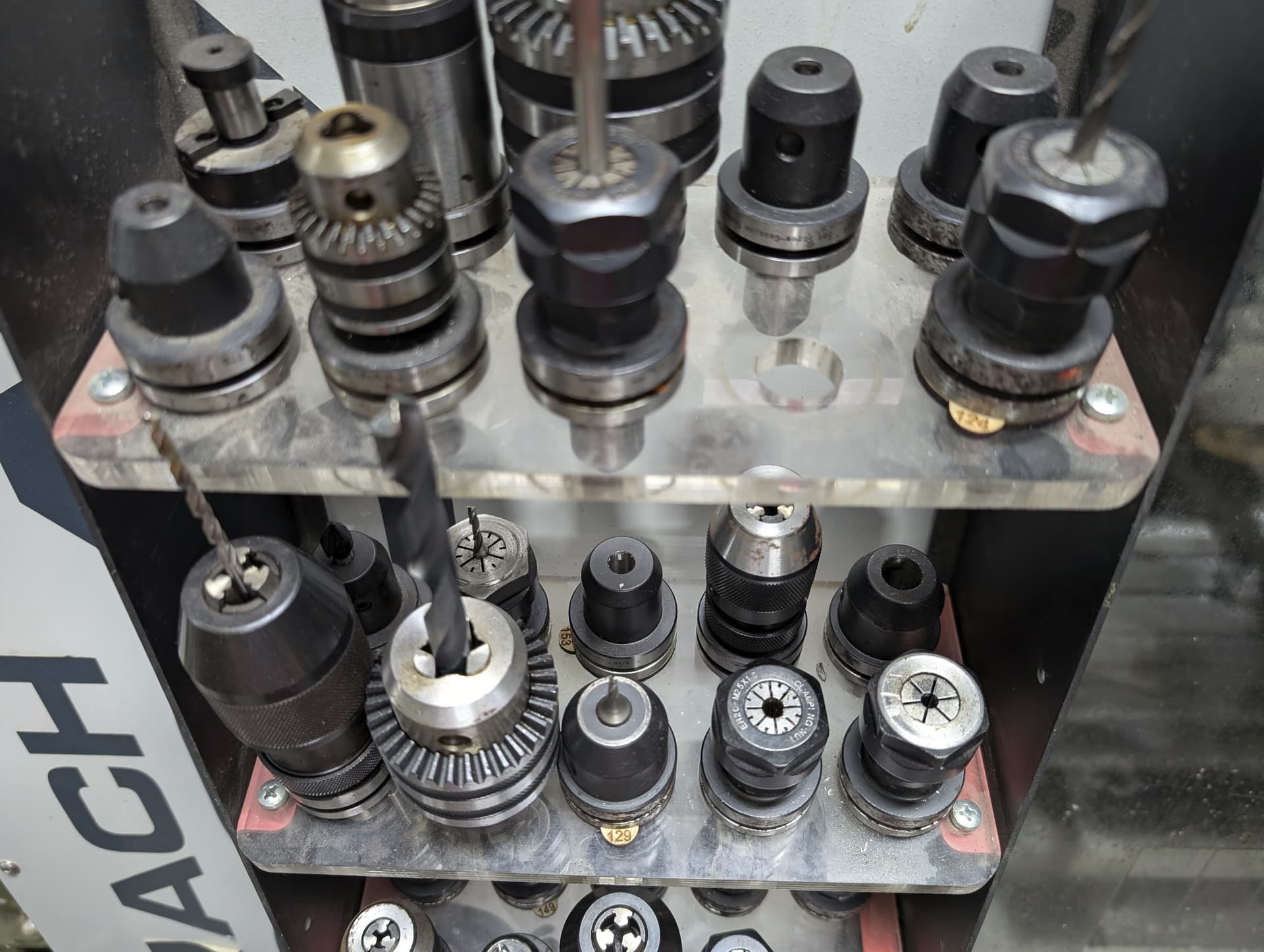

it’s pretty easy to spot the tags when they’re on the shelf but still easy enough to migrate tool numbers around:
The ONLY deficiency to this approach is the chance you leave the collar on the tool, which should be easy enough as the ring should have been left by the keyboard! ||| DO NOT RUN THE TOOL IN THE MILL WITH THE COLLAR INSTALLED ON THE TTS SHAFT |||
I made this DXF file years back if it’s helpful to have a template feel free to use it:
Tormach Tool Tags.dxf (585.8 KB)
