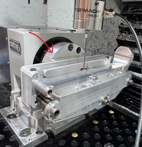

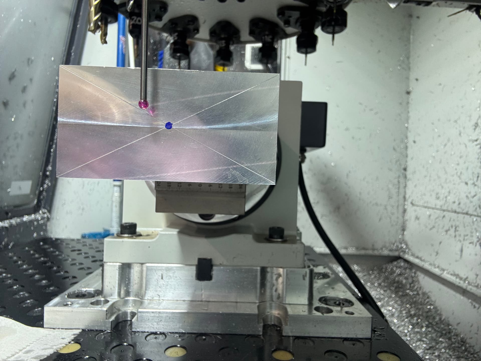

Ok here is round 2, I did 2 tests tonight with the same failed results. WTH is going on here? The procedure totally makes sense to me now after doing it a few times. IS there something you’re forgetting to tell me? Is it possible that Im doing something different than you might be doing since Im using a probe and you’re not? IS there an initial step Im not doing?? This should work, LOL!

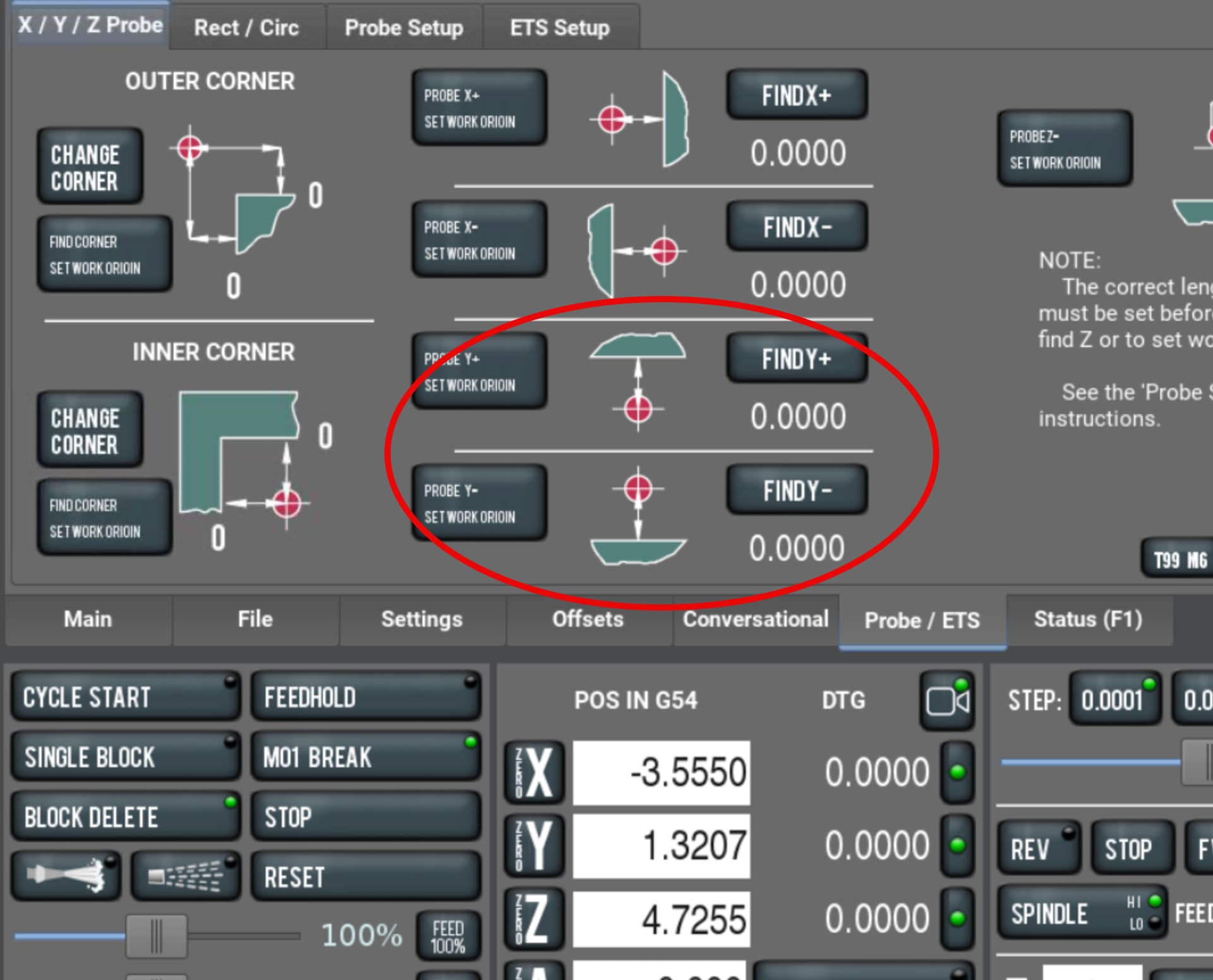

Before I start, I level out the fixture or part with David’s script. My 1st hit Im using probe Y- set work origin, 2nd hit Im using find Y+, 3rd hit Im using find Z.
1st test probing off the fixture, here is the results. Same as before. :roll_eyes:
2nd test to verify if there was something with the fixture causing issues. Not the case as you can see I did this one in the self-centering vice with stock that has been faced on all sides.
Is the script supposed to move the probe to the center at the end of probing? What your showing looks like where the probing script ends and parks the probe. Or the last photo is your showing is where 0,0,0 is calculated from the probing?

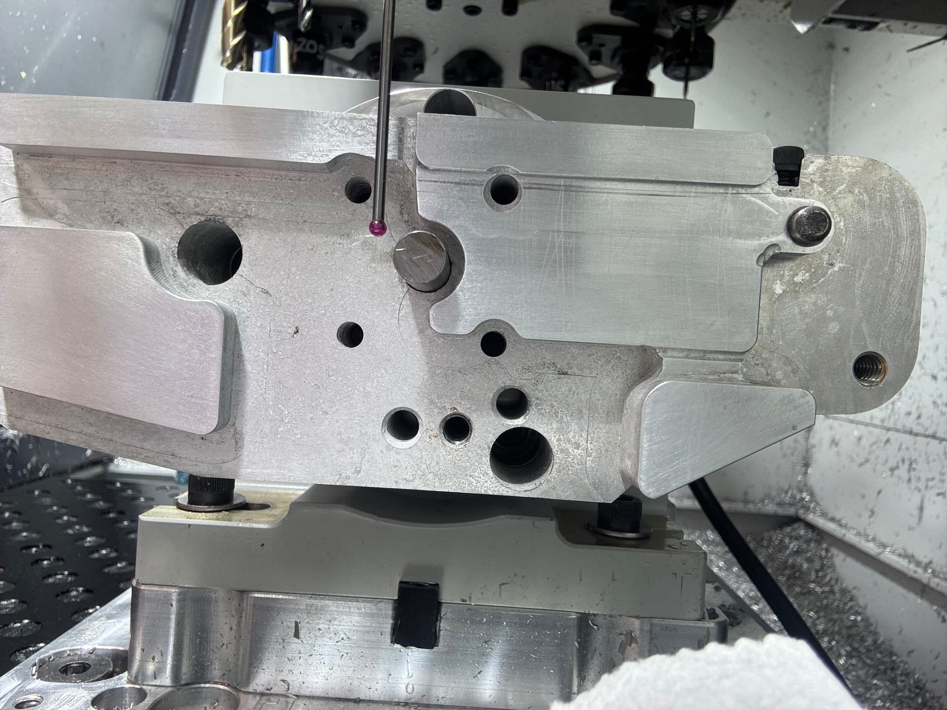

All the probing routines Im using for Ian’s procedure are all basic Path Pilot routines. The positions the probe tip is in, in the pictures, are from me using GOTO Z0 Y0 manually by entering into MDI after I have performed all the steps in Ians procedure.

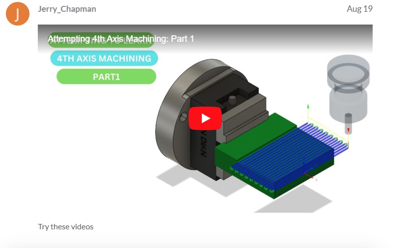

My original plan was to do just that by following the video in the screenshot below and David Loomes scripts. SO, the reason I’m not using the built in find A center is as I understand it that “could” introduce additional variables in accuracy in my final setup. You even suggested this previously in one of your posts to me in the fact that swapping out fixtures in a single set up could introduce positioning issues down to the play in the screws. You did not say exactly that BUT it stopped me in my tracks making me realize that “could” be a bit issue. The reality is swapping out multiple fixtures in a single set up is the issue, RIGHT???.

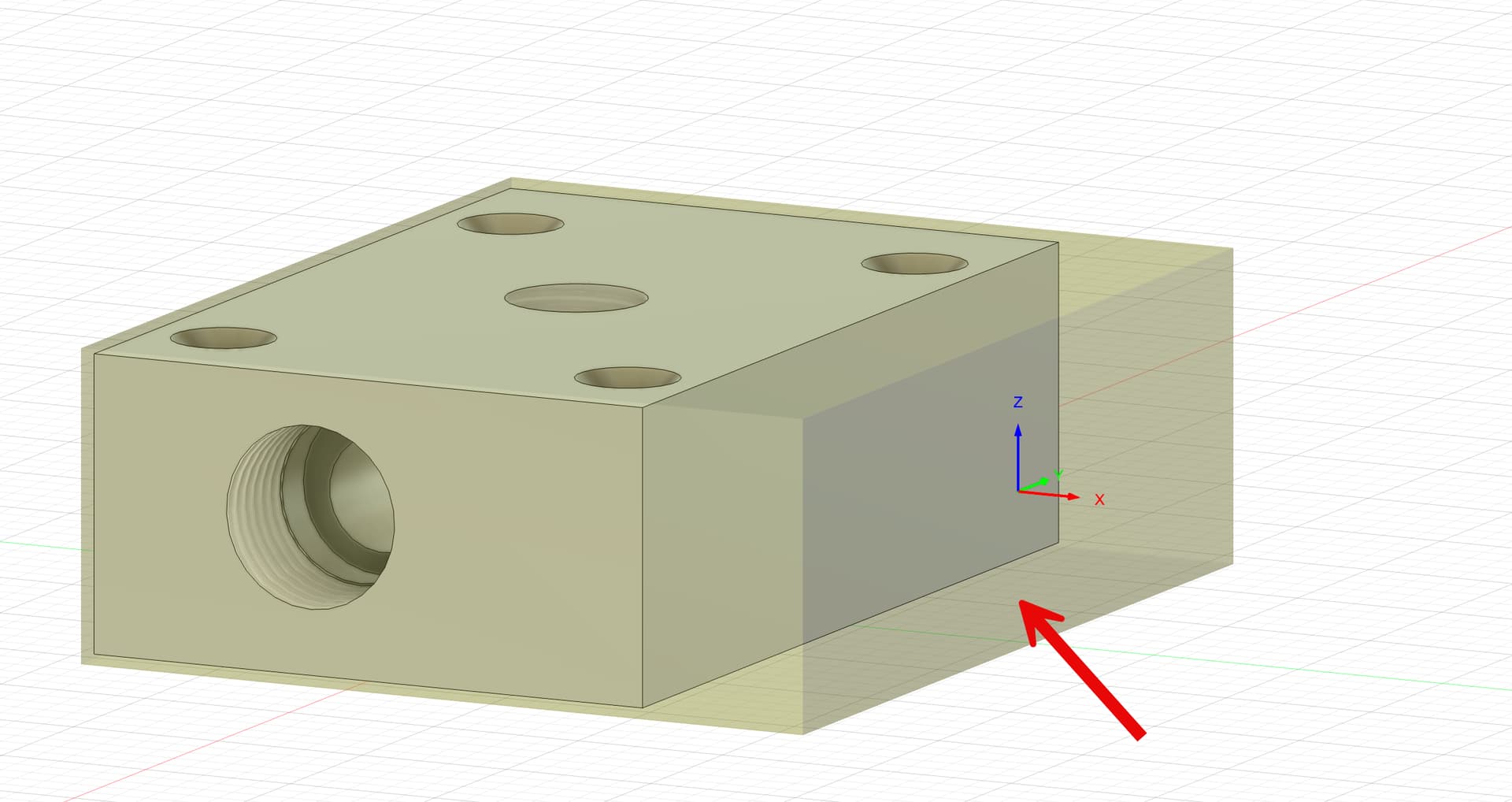

Here’s a thought, Kind of a crazy one, yesterday I started thinking about using the outer diameter of the Micro Arcs mounting ring OR the GTM adapter plate shown here with arrow as my probing surface and running the Path Pilot (probe A find center) I checked the clearance in CAD, and it looks good. Quesion is, if the OD would be mounted absolutely concentric to the Micro Arc’s center. ??? I even reached out to Steve Strange of GTM Manufacturing to get his input on the OD probing, have not got a reply yet. IF there is clearance, I could do this with my fixture mounted and I would be good to go. I have my doubts the OD is a good option to probe. I guess running an indicator on the OD would tell the story right?, I did not think of that last night. WHAT do you guys think of this method? It would be a simple solution for future milling of this part for sure!

In this pick the arrow is point at the extra stock I have to provide clearance and space for the vise jaws. My MA is on the right side of my machine.

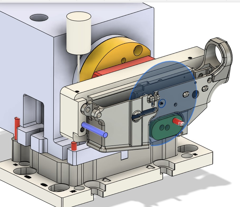

To clarify, my work offset is here. Do you still feel a benefit to setting it on the main fixture body after seeing this? X is on that outer face and is accessible to the probe when the part is in the fixture.
Could you elaborate on your probing using “find Y+ Y-“? Are you saying you’re only using find at both ends and not setting an origin at the 1st point?

Is the small circle inside the bigger circle what you are calling your WCS? Where are the axis arrows?

On probing Y I would go to the front of the work and probe Y+ and set origin, the go to the back and find Y-, that gives you the length divide that by 2 move to that location and that is you zero or middle of the Y.

Yes that is my work offset, I was in design when I took that screenshot.

In regards to the probing you explained that’s exactly what I’m doing, but I started at the back of the part. Im going to do a test tonight on a 123 block and see if my centers are correct.
I usually start from the back to but I was trying to figure out the easiest way to explain it. Front to back aligns with the probing screen screenshot a little better. Let us know how you make out.

Hey Guys, A quick update on my progress. I think im over the hump on this and have a good understanding of how to get set up for the MA and the necisary steps needed I needed for this type of setup. A BIG thank you to Scott Dube for taking the time to talk to me yesterday and help me confirm my setup, which was a big help for my confidence.

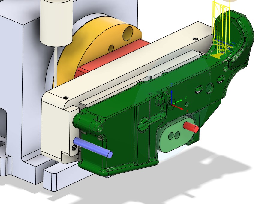

I set up Path Pilot to find the center of A rotation with ER-40 Faceplate and 1’ precision gauge pin, attached my fixture and part, then David Loomes Probe A to level the part/fixture perpendicular to the end mill/table. I now understand, I will need to do this each time I set up this part for milling and can not rely on the stored G59 Micro Arc location. Just to point out Im on an 1100M machine (steppers).
So the next step was to test mill with one of my 3D prints to verify that everything seemed to be milling in the correct locations. It did this, and this was a perfect method for verifying everhing was correct. Shout out to Scott for the suggestion, great idea. My son had suggested that as well. I was going to print a solid one but this turned out to work very well cuz the cutters are not really even touching the plastic, other than some flex in the plastic part from being clamped in my fixture.
I verified all indexed sides of the milling on the 3D print, and that gave me the confidence to go in for the kill and run it on the actual part. So I was able to mill, I’d say 75% of everything. What I could measure looks ok, but the proof is when the part comes off the Micro Arc and is inspected. AND ultimately built out to a functioning airsoft gun for testing. Will post pics when I get it done.
