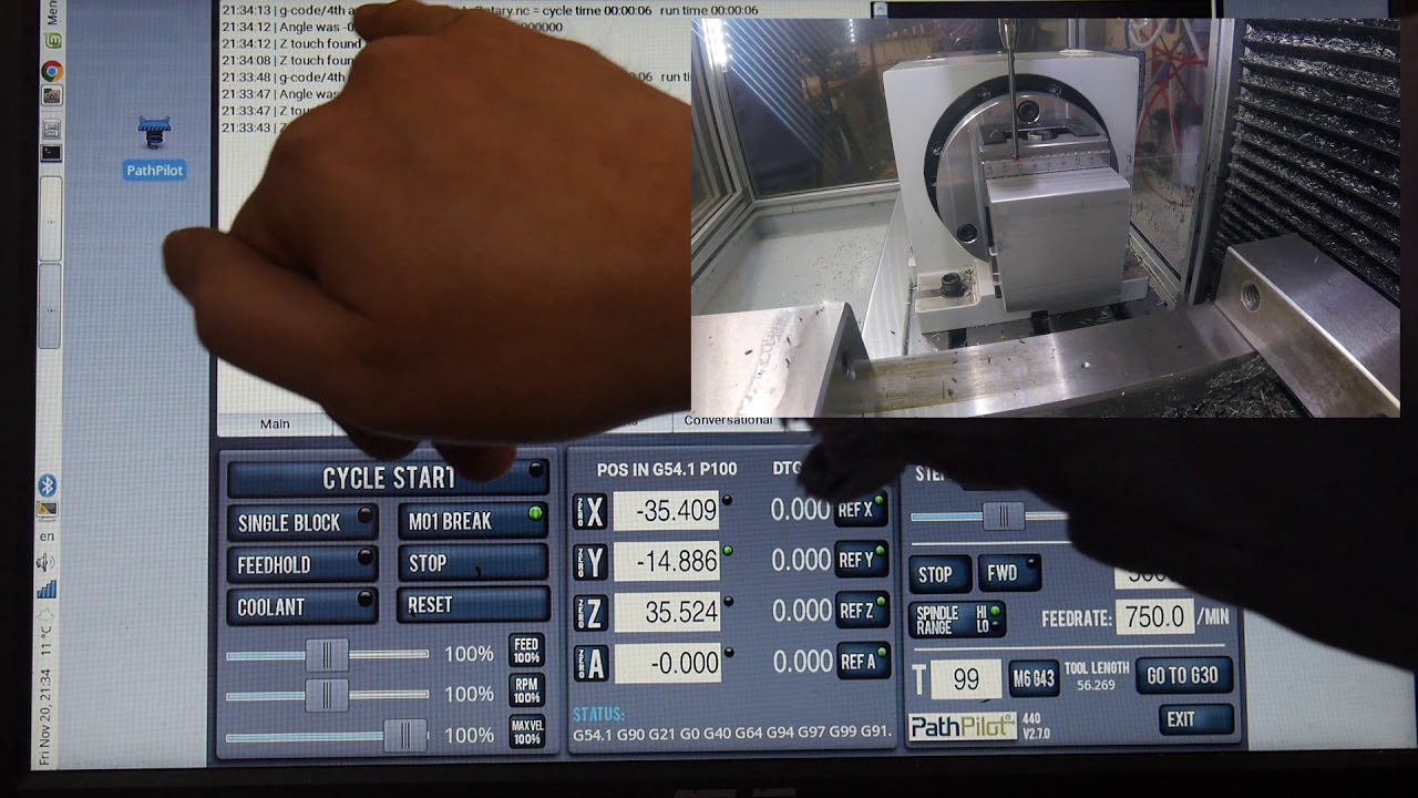

For a clearer picture of this watch Davids Video. (7 Min video if you have not watched it yet)

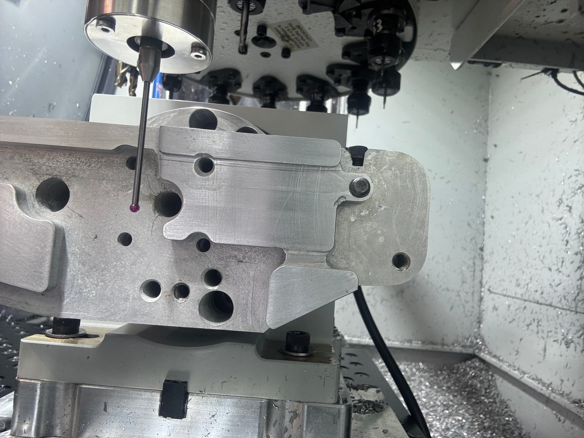

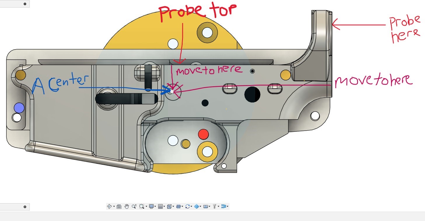

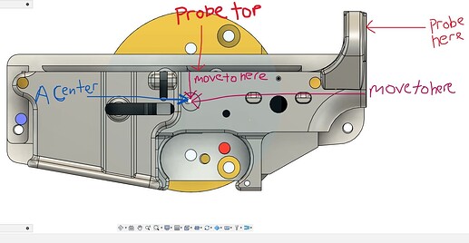

Guys, since I can not use David Loomes Z&Y probing script to set my Z0 Y0 center of rotation, can you give me thoughts on this to place my Z0, Y0 center of rotation on my Micro Arc.
BTW: I did not mention before that the lower is located to the fixture on the 1 tare down pins.
  1. Boot up and home as normal.
  2. I run David Loomes (ProbeA_Rotary) to adjust the rotation of the Micro Arc to get the top of my part perpendicular to the tool face. I probe the pre-machined top surface of the part, NOT the fixture.
  3. I now probe that same top surface of my part in Z, and then adjust my Z by -0.65775996 in. and zero out my Z DRO.
  1. I now probe the pre-machined surface of the buffer tube surface.
  2. I now move my Y +3.82150784 in and zero out my Y DRO.
I now probe my part in X per my CAM origin and Im ready to mill.
RIGHT? :thinking:
IS this the solution, or is there yet again something Im missing?

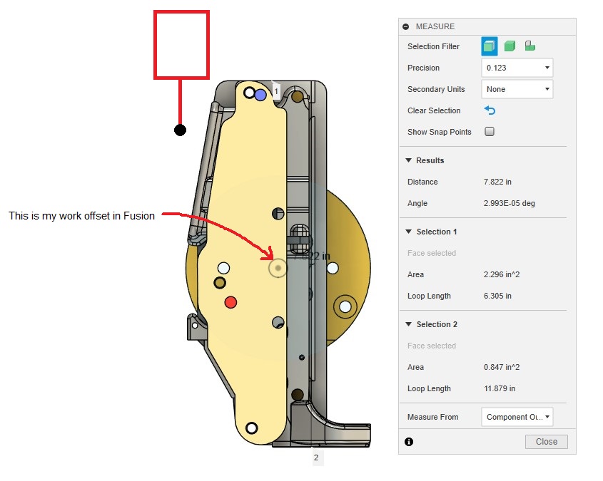

The part and fixture measure 7.822 long so If I rotate the part -90, pointing up I can not probe the last point or anything beyond the length of the probe tip as my probe tip length is only 2 inches. Alos the bottom profile of the part is not flat like it is on the top thus further complicating any probing.

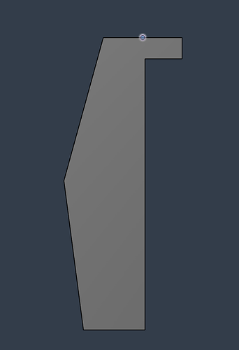

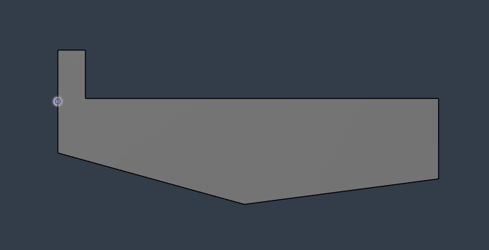

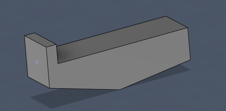

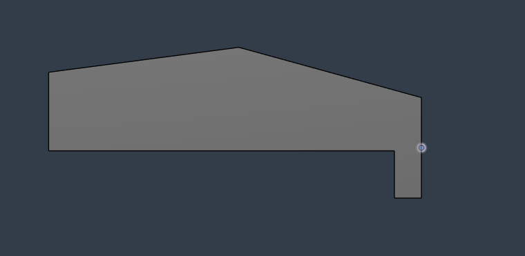

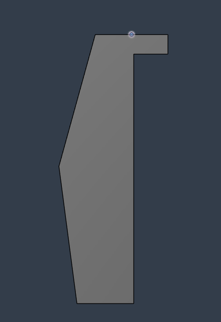

I think you may be misunderstanding the method a bit. I’ve attached some (very crude) images to hopefully explain better. The idea is to touch off on the same point in every orientation. The specific point isn’t important, as long as it’s accessible from all three orientations. By checking the same point in 0 and 180, you’re finding the exact Y center of rotation. Then checking the same point again in 90, you have a established reference to the center of rotation but now it’s oriented in Z allowing you to set the Z center as well.
Note the highlighted point in all four images. Again, this can be ANY point on the part, as long as you can access it from all three orientations.

I have a couple of new questions.
Before I do any of the probing you have laid out, I would need to make sure the part/fixture is perpendicular to the tool face/table, right? Seems like this is KEY to getting all 3 hits dead on. IF it’s not, and the probe is hitting a face that could be rotated, and the probing would be inaccurate, right?
When you say probe the same point, are you literally saying I must hit the same “EXACT” point on all 2nd & 3d points when I rotate? Seems like this is KEY since Im milling an existing part and positioning is critical to making this as accurate as possible. David’s script hits the same exact spot every time, but how to do this manually?
One way I could see to do this would be by making a Sharpie mark on the part itself and hitting that same point in Z BUT this would not be an absolute position for hitting the part in the same exact spot, since it’s still really only a visual point of reference.
SO, how would I make sure its hitting the same spot for Y+ and Z as my 1st point?
Any input here would be helpful. Thanks

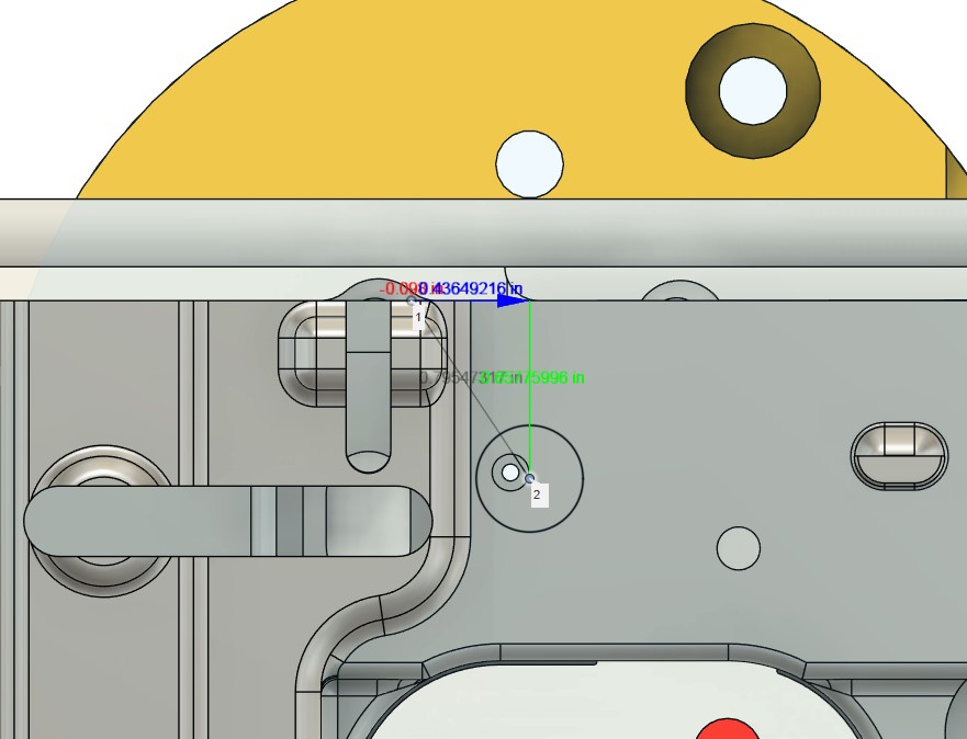

You can measure from the setup in fusion. You can align the part any way you want and then make the points in the cad, write them down and then verify them in the machine.

Have you thought of having the part 3D printed and then tuning the test on a few of them? I’m assuming upper receivers are expensive to experiment on.
What matters is relative positions, not absolute points. However, using the same absolute point does ensure the relative positions are correct.
The part does not need to be perpindicular, but it helps, probably more so than hitting the exact same point. Think it through in terms of what is actually being done. Touching off one side creates a reference point in space for the Y axis. rotate the part and touch the same point creates a line in space that exists on the YZ plane. Since you know the length of that line along Y, you can find the center point of it in Y (center of rotation).
In an ideal world, you would be touching off at Z zero (Z center of rotation) but you don’t know that yet. So the key is for the virtual line to be perfectly flat on the YZ plane, at some unknown position and angle in Z. The BEST way to get that line is to touch the same point in both orientations, but, if the point exists on a plane parallel to the XZ plane, then the exactness of that point is not terribly important.

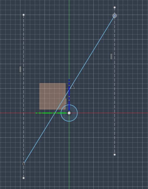

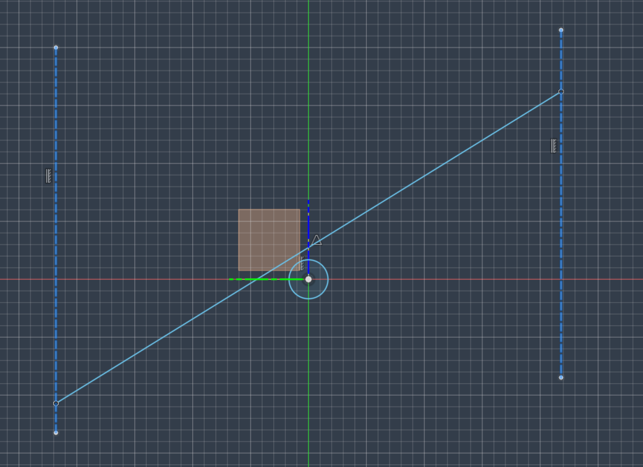

In the images below you see two points in space on the YZ plane representing the two points checked on the part with a line between them. Note the line is not at the Z center (shown by the circle) BUT the center point of the line is directly above the center of rotation. In both you’ll see that the Z position of the points is irrelevant as is the actual distance from the center in Y, the only thing that matters is that they exist on parallel planes. I’ve also included an ISO view just to clarify YZ and XZ planes
So, with that in mind, if your part is oriented with one face that is aligned with the Z axis, you can touch anywhere on that face and you will find an accurate center point. If that’s not possible for some reason (a round part for instance) then the proceedure changes but I don’t believe that’s a concern for you with this job.

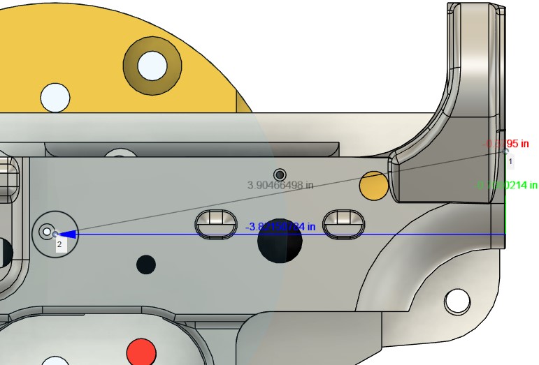

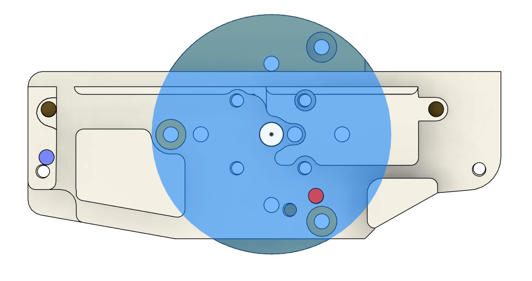

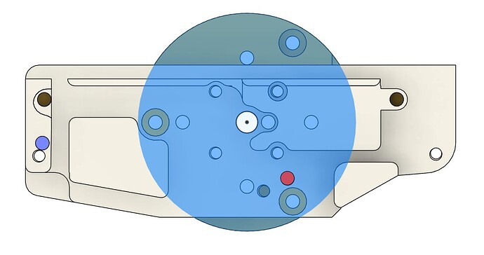

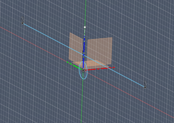

Here is my part/fixture in Fusion to show where the center of rotation is for the Micro Arc.

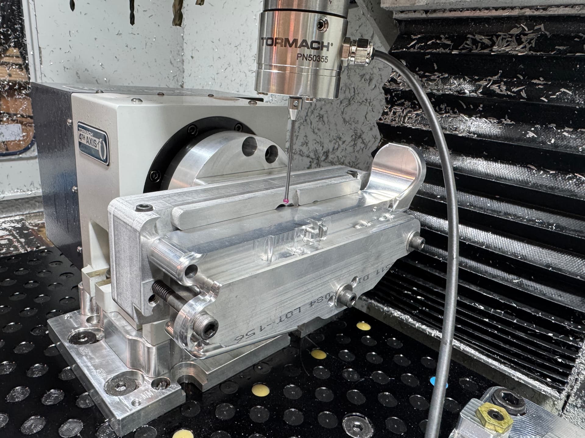

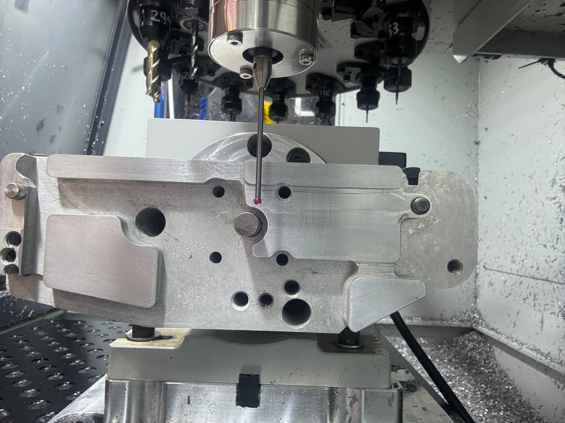

Here is my 1st test probing on the part (buffer tube end) looking at the probe tip that is sitting at Z0 Y0 in the picture. You can see how off I am. Just to point out, the 3/8 hole shown with and without the round bar is my Micro Arc center on the fixture.
And my 2nd test probing off the fixture. Again im off, but it’s shifted in a completely different
Why are the orientations completely different for both?
