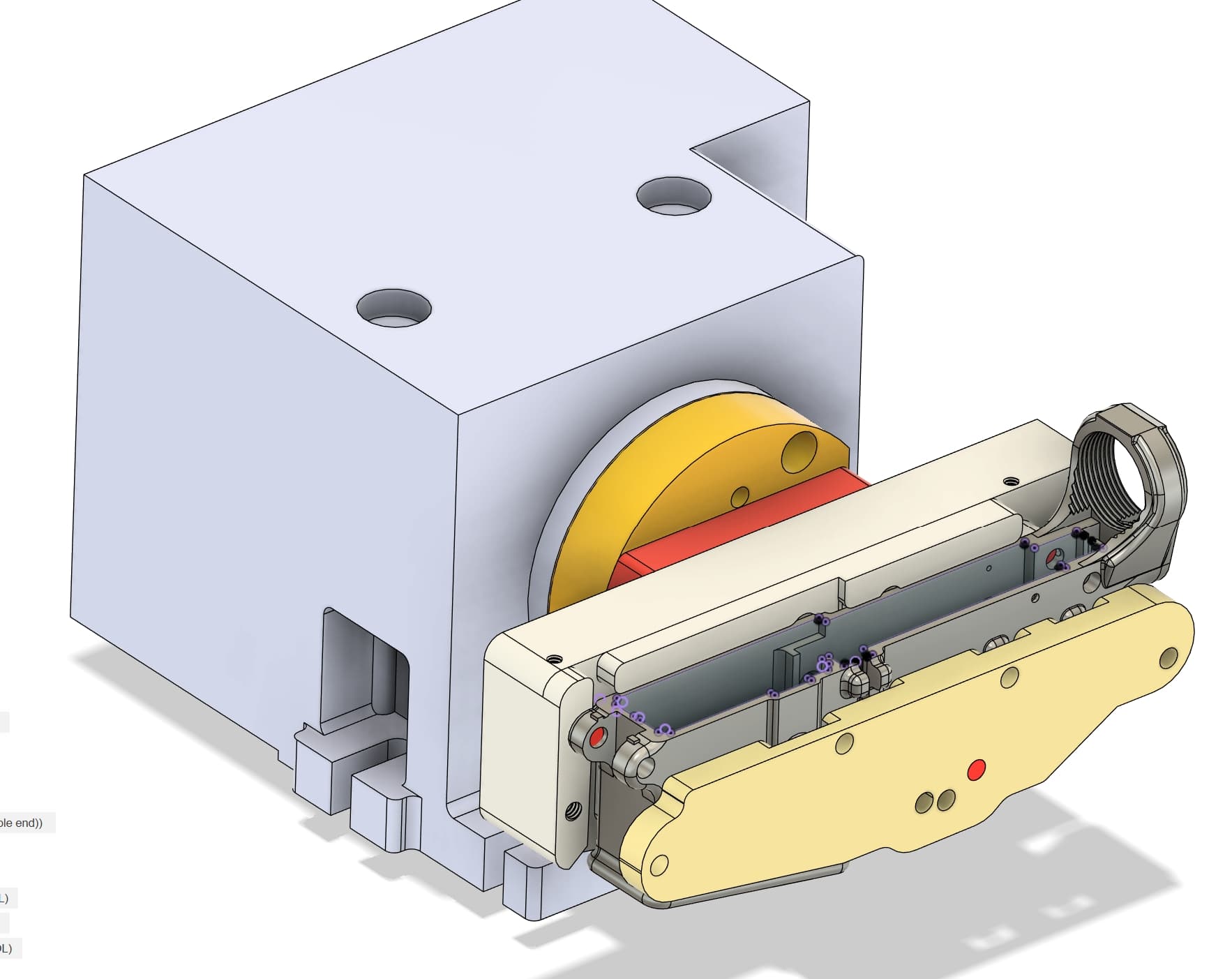

Im working on an AR-15 (airsoft) lower receiver and Im finally getting close to making chips on it.
Quick run down Op 1 & 2 are 3 axis, and Op 3 is indexed Micro Arc, Im on an 1100M with a Tormach Passive Probe, doing CAD/CAM in Fusion. I need help with the practical probing setup for my work offsets for the Micro Arc. Ive been thinking about this for weeks, but im not exactly sure how to set up for the 4th axis. And because this is a specialized set up there are no real resources out there I can find as a step-by-step guide. Norm at Tormach has told me just that, and I have not found any videos on indexing. I think its pretty lame there is nothing on this! The part will be indexed on all 4 sides, top, bottom, front, back, plus the angular rotation to drill and tap the hand grip threads. Here’s a picture of everything as well as a screenshot.
Questions.
• How do I establish my starting rotation of the Micro Arc so that my top part face (as seen in my screenshot) is perfectly parallel to the table? HOW do I probe for this?
• Once I get the rotation exactly where I want it do I just hit zero A axis?
• Currently in Fusion, I have my work offset at the center of the Micro Arc in Y&Z with X on the face of the GTM adapter in (part in yellow). I know that when programming for parts that rely on the center of rotation for 4th axis, this would be the typical setup aside from where I have my X. SO, would this be a common OR a standard setup for an indexed part?
• I want to establish my work offsets by probing existing milled faces or features. Im not sure I want to rely on the actual fixture. BUT if you have input on how reliable that would be let me know.
• How would you guys approach setting the work offset for this setup?

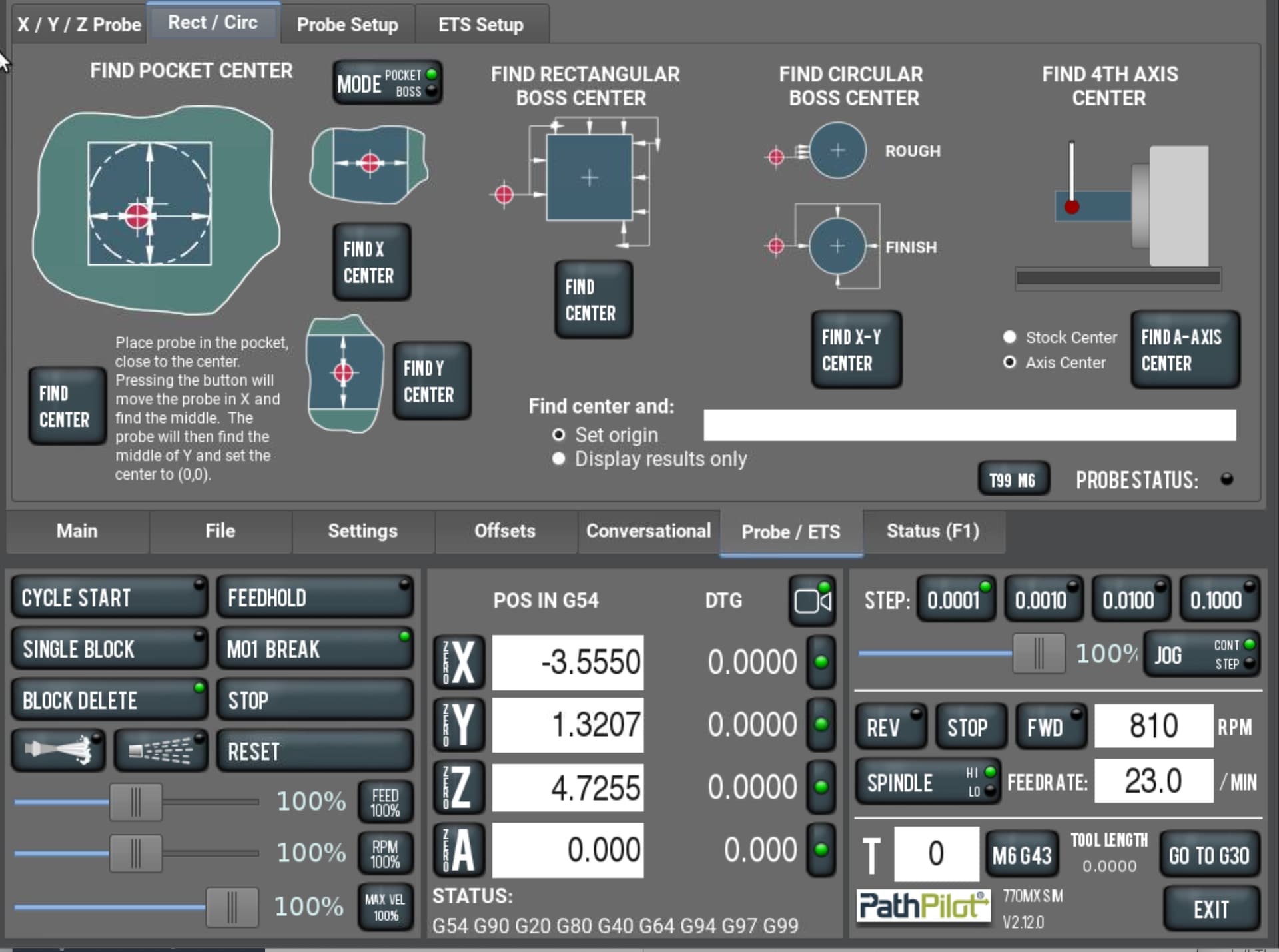

There are probing routines in the latest PathPilot. Not sure when it got added.
None of those do what the files discussed above do, unless I’m missing something. This finds the center of round stock to locate the center of rotation. The files above are to get a rectangular part flat or square to the table. The other is used to find Z&Y…
I see. You are correct. I was recently surprised that 4 axis probing was in PathPilot.
Looks like it would be nice to add what those scripts do in PathPilot.

To establish your initial level A position, as Harold said, you can touch off the two points furthest in Y from each other and adjust the rotation angle until you see zero on both. Think of it like tramming a vise, only on it’s side. It’s generally a pretty quick process.
Since the machine doesn’t have TCPC, your CAM and therefore your physical WCS should also be set to the center of rotation in Y and Z. I’ve tried not doing this and the results are always bad. That said, you can probe any feature you want to find that centerline as long as you know exactly how far away from center it is. For instance, once you’ve mounted your fixture, first time around, touch one end of it in Y. Then rotate the fixture 180 and touch the same surface (which is now facing the other Y direction). Divide that number in half and you have the exact distance from that face to the center line. Next time you need to locate the Y center, assuming you haven’t removed and reinstalled the fixture, you only need to touch off on that one face, and offset by the previously measured distance.
Similar for Z, once you’ve established the distance from centerline to the top surface of the fixture, touch off on that surface, and offset to center and your done.
As for X, zero can be wherever you want it to be. It has no direct relationship to the rotation center so it can be totally arbitrary.
I get that you want to use the part as your WCS reference, and that is probably the better approach to ensure features are sized and positioned correctly. BUT, bear in mind that if the part moves in the fixture from one cycle to the next, the center of rotation moves relative to the part. So unless you are willing to change the setup in CAM to match, you’re still going to make a bad part. This is the big difference between 3 axis and multi-axis setups. With 3 axis, if the part position changes between runs, the machine still makes the same movements, just in a slightly different position. With 4 axis, if the part position changes, the actual center of rotation does not so if you try to tell the machine that the center is now in a different place, you end up with a mess.
The better approach is to use the fixture as your reference, and make sure the fixture has 3 good surfaces (XYZ) to repeatably locate the part.
I have the newest version of PP and as per Scott Dube It does not do what I need.
