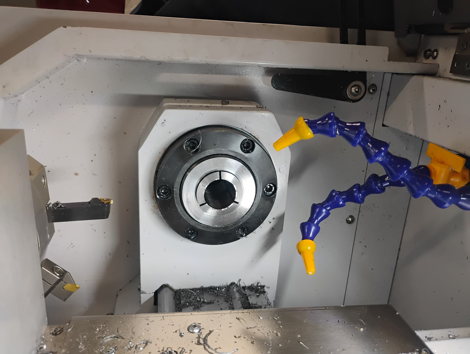

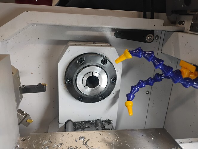

Here is the progress. I had to mill 8.4mm off of the base for proper alignment of 10mm tool holders. It is mounted. Solenoid valve that came with it was DOA. Need to oder another one. The is a pretty nice piece. I think I am going to build one purposely for this machine soon. This one will work well for the time being.
I milled a pocket in the side for mounting as well.

What’s the control of the turret like? Are you going to use the USBio module to control it?
Yes it’s all controlled by pathpilot. A lot of work, I had to disassemble and machine 8.4 mm of part of the base, and other things. Making the blocks for drills, boring bars and such today.
This is really cool, what is the max diameter you will be able to work with?
With the lathe bit sticking 1.6 inches out, about 6 inch turning diameter. This turret is way better in rigidity than the crap tool post it came with. I am not a huge fan of the turret construction, it has a very complicated design and a bit finicky. If several things aren’t adjusted perfectly it doesn’t work correctly. I have had it not rotate when it was supposed to. I am going to build a better one the end of February.
