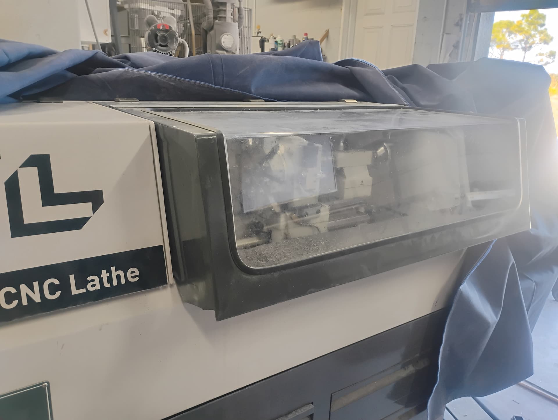

My shop has been swamped. I finally got the turret I bought to work decent. I made the cabinet extension.

Couple questions if you have the time: how did you set up the tool change control in pathpilot and how did you wire it? Do you use a USB I/O, or some unused output from the controller? I haven’t looked into what kind of signal Pathpilot sends for a tool change when “Turret” is specified in settings, but I assume it won’t be exactly what the Altaros needs with its single solenoid. I can probably figure out how to code up a subroutine or put some manual pass through NC/g-code in my Fusion programs to send the signal it needs (something like a 2-3 second pulse that opens the solenoid then wait a second and repeat for every position it needs to rotate through, I assume?)
Also, any tips or more photos of how you did the cabinet extension? It looks great, almost like it was built that way!
Edit: oh yeah and somewhere you refer to the “10mm tools”… but isn’t the Altaros sized for tools with a 12mm shank? Or am I misunderstanding?
