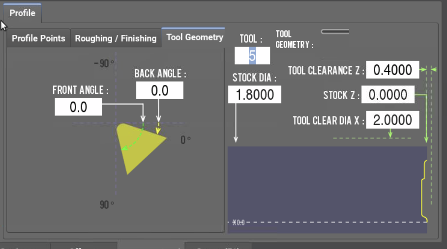

Well, I came back here to cheat off of my own test and struggled to understand what I did a while back. Therefore, in case anyone else is using this or for me in another year when I need this again, here is what I stumbled on:
  • the selected tool needs to be setup with tip 2 or 3 (I am doing this on an 8L)
  • Tool Clearance Z needs to be set to 0.4
    • This is because I hard coded 0.4 into the G10 L20 moves. If you need to set this to some other value then you need to update these commands on lines 73 and 85.
  • your tool geemoetry needs to be defined correctly:
  • Once you create the tool path then copy the F&S and the Finishing pass into the example code below.
