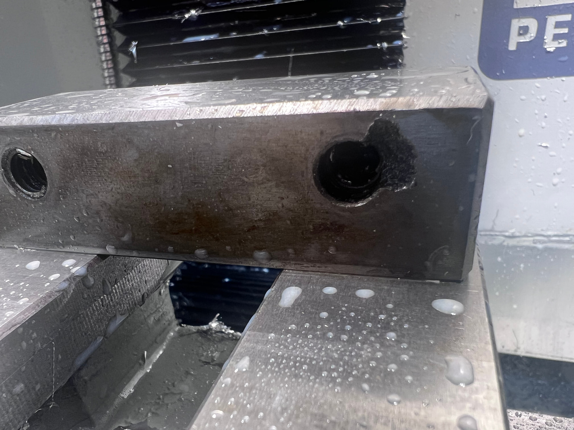

I had a part come out “wrong”. I started to check over all sorts of things until I finally made it to suspecting the thing I would have never suspected. I was checking that the Talongrip jaws were secured and parallel. I loosened them and when I started to tighten, they would not snug, so I took everything apart and found this…
I have not over-torqued (using a standard length 3/8” ratchet) or can think of anything else that would have caused a failure like this.
Anyone else have this issue?
I would imagine that this individual part is not for sale, so it looks like options are:
  1. Buy a new vise (ouch)
  2. Attempt a thread insert operation
  3. Machine a new fixed jaw from the provided CAD - but out of what type/grade of steel?
Helicoil both of them. Should have clearance in the hard jaws for a maybe not so perfect locating job. Sink the helicoil 1/4 to 1/3 turn below the top. Use Red Loctite. Stone surface for high spots.
All better!
Oh, use 1 1/2 diam length helicoil.
I had looked at this and was initially discouraged of it being a viable option. Thanks for the vote of confidence and notes. I have the inserts on order and I’ll report back with results.
Step the drill size up to req’d diam if you’re doing it by hand. I’ve been told by engineers that the heli coil is actually stronger set in base material. Plus threading bolts in and out takes a toll on metals. And, clean excess red loctite out with a Q tip. Let it set for an hour or two. Otherwise the bolt will unthread it. Both locked together. No fun.
Make a new one out of 4140 PHT

Most of the fixed jaws are tapped through. May be possible to reverse it. Depends on the keyway.
