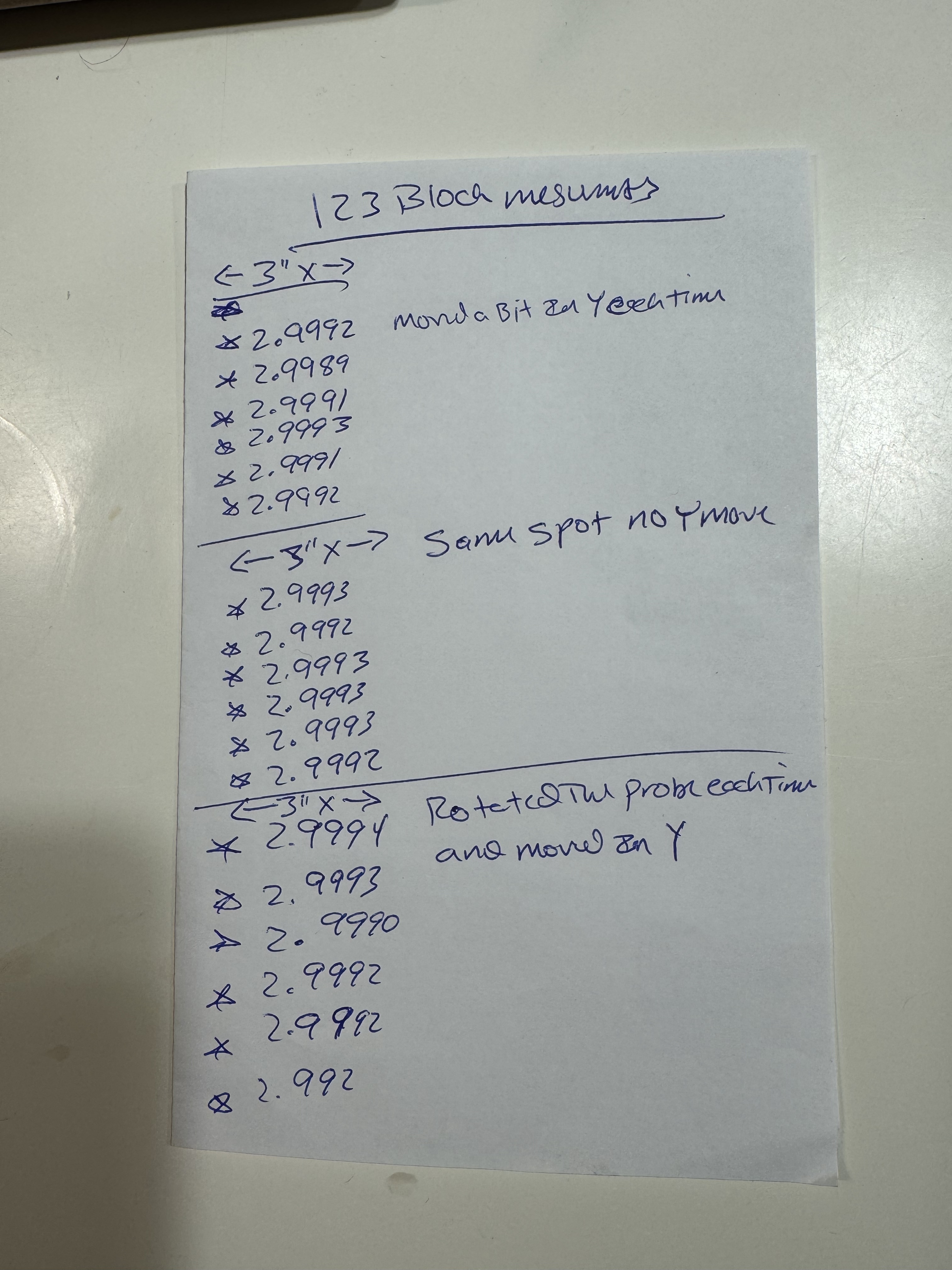

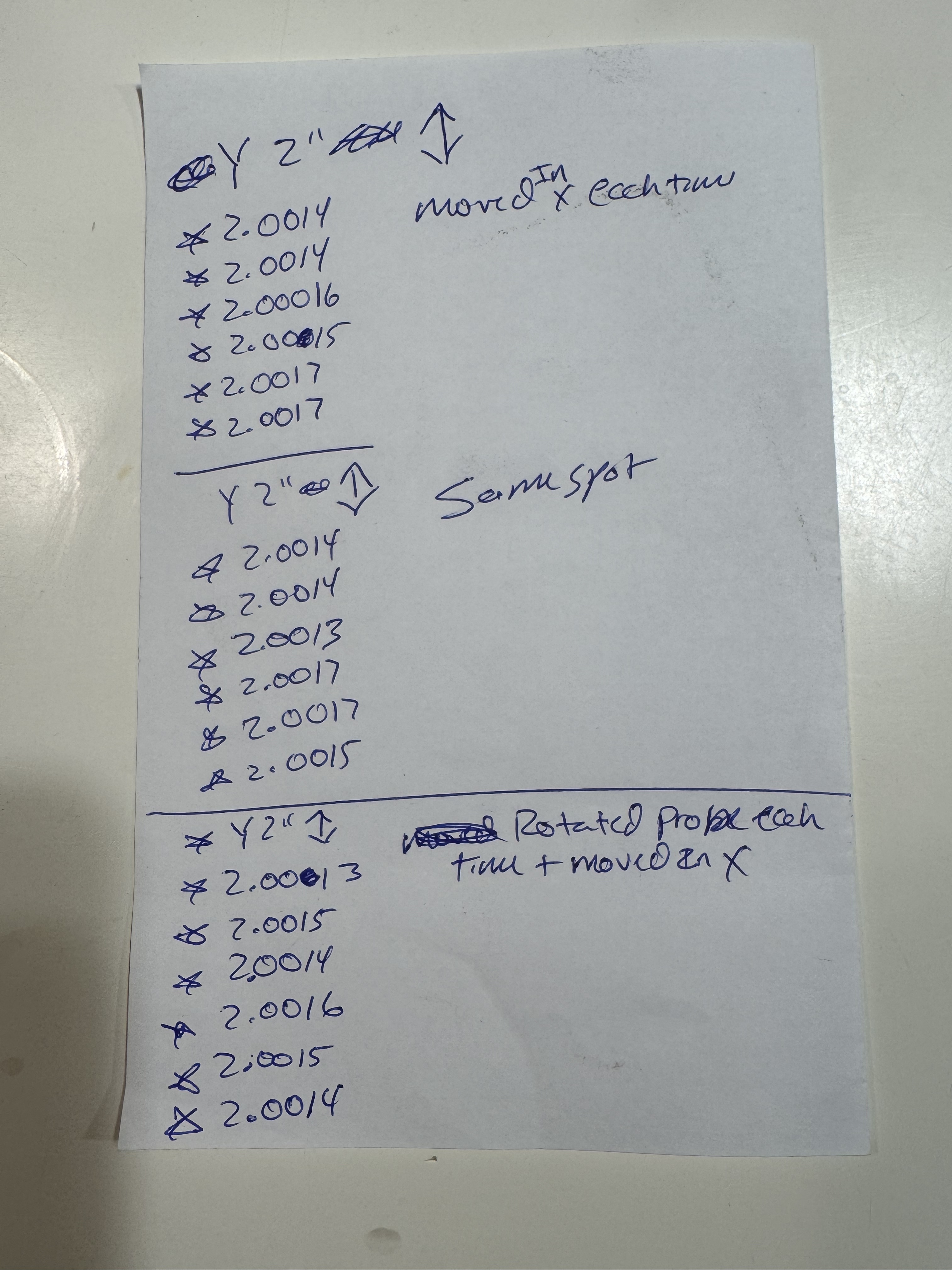

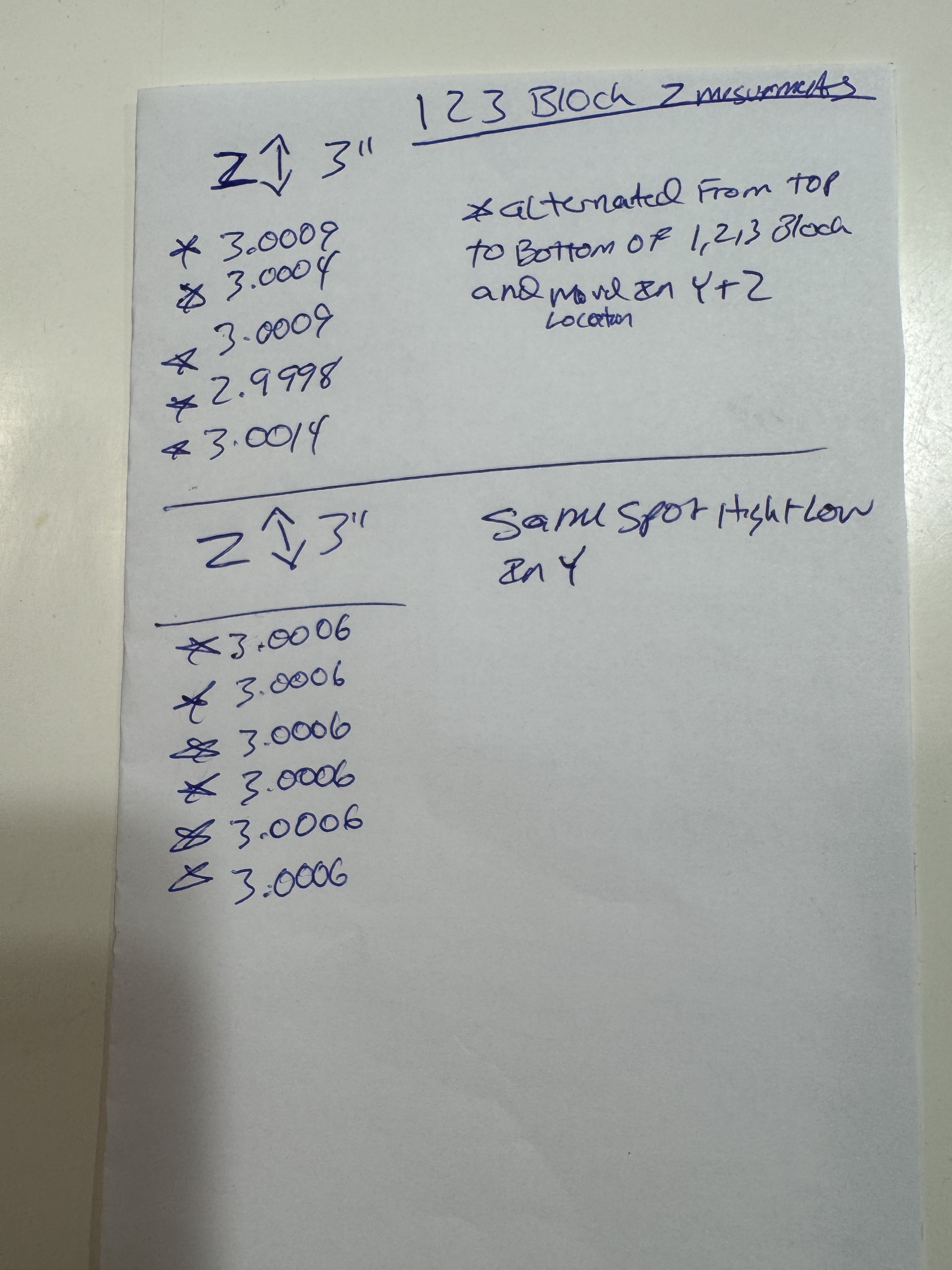

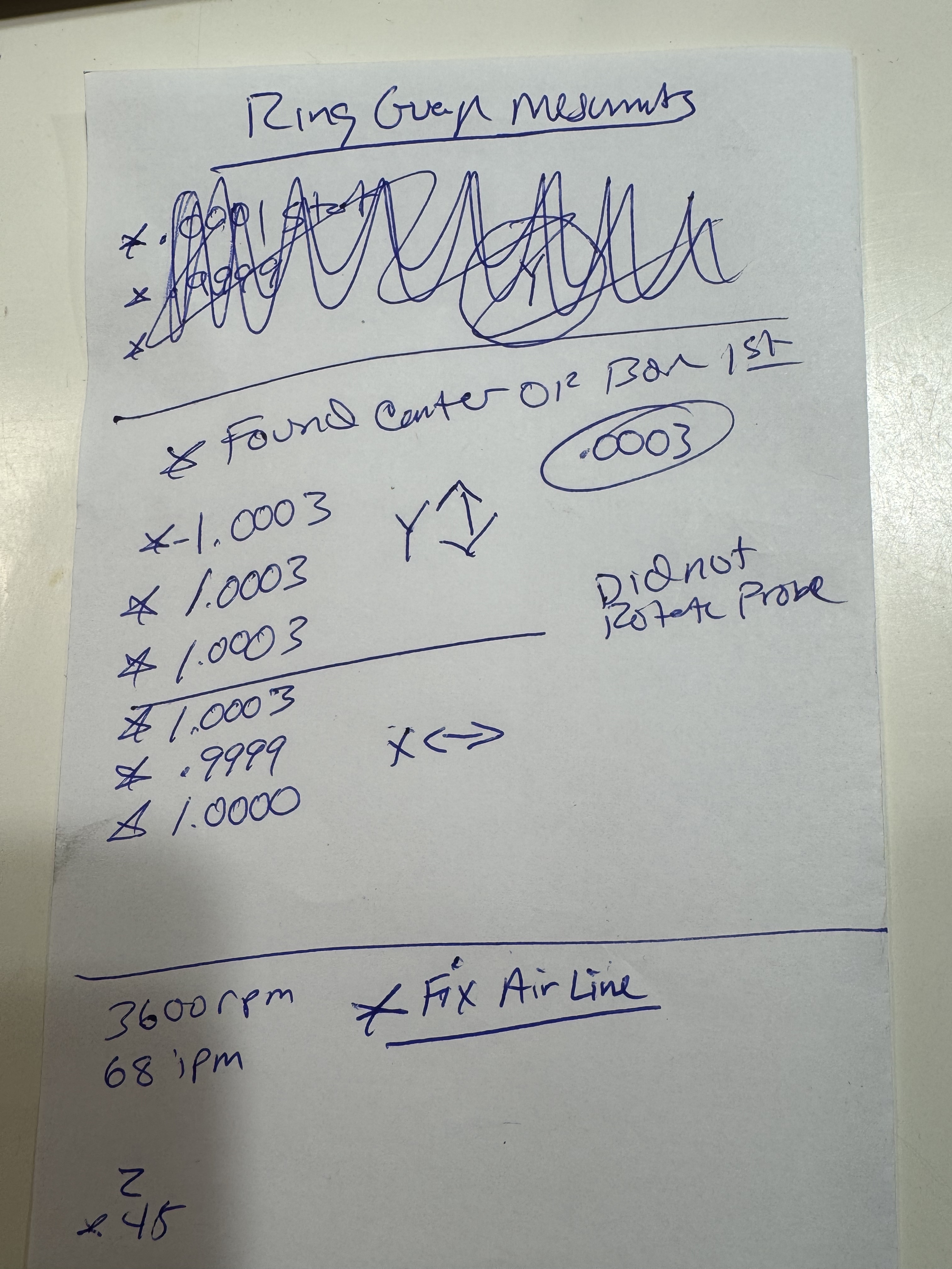

I ran a bunch of measurement tests probing a 1 2 3 bloodied and ring guage. Sorry to bore you guys but here are the results to compare testing you guys might have done in the past. These numbers look good to me, right? Comments?

Those numbers look good.
If you measure the middle of a side and then at the corner the measurements should be the same. When it’s not it can indicate loose vice movement or gib problems.
It sounds dumb but you would be surprised how often it shows inconsistencies.
