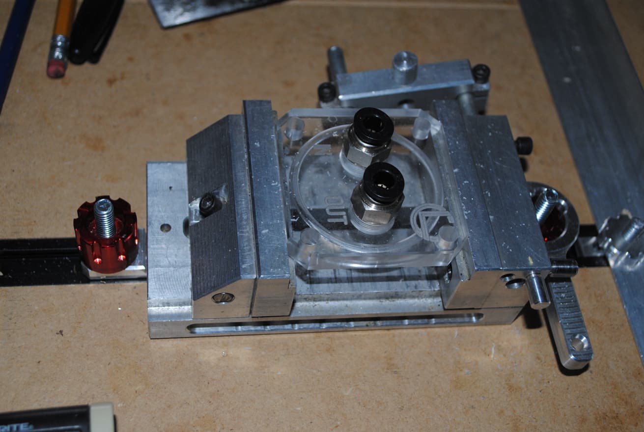

I have small custom vises that bolt down to the t-track for holding different materials

Picture below shows a small vise mounted in spoil board t-track.
I have designed and made a couple dozen of these in different sizes over the years to use on mill, router, bandsaw, you name it.

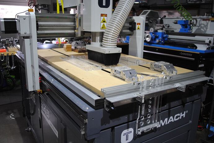

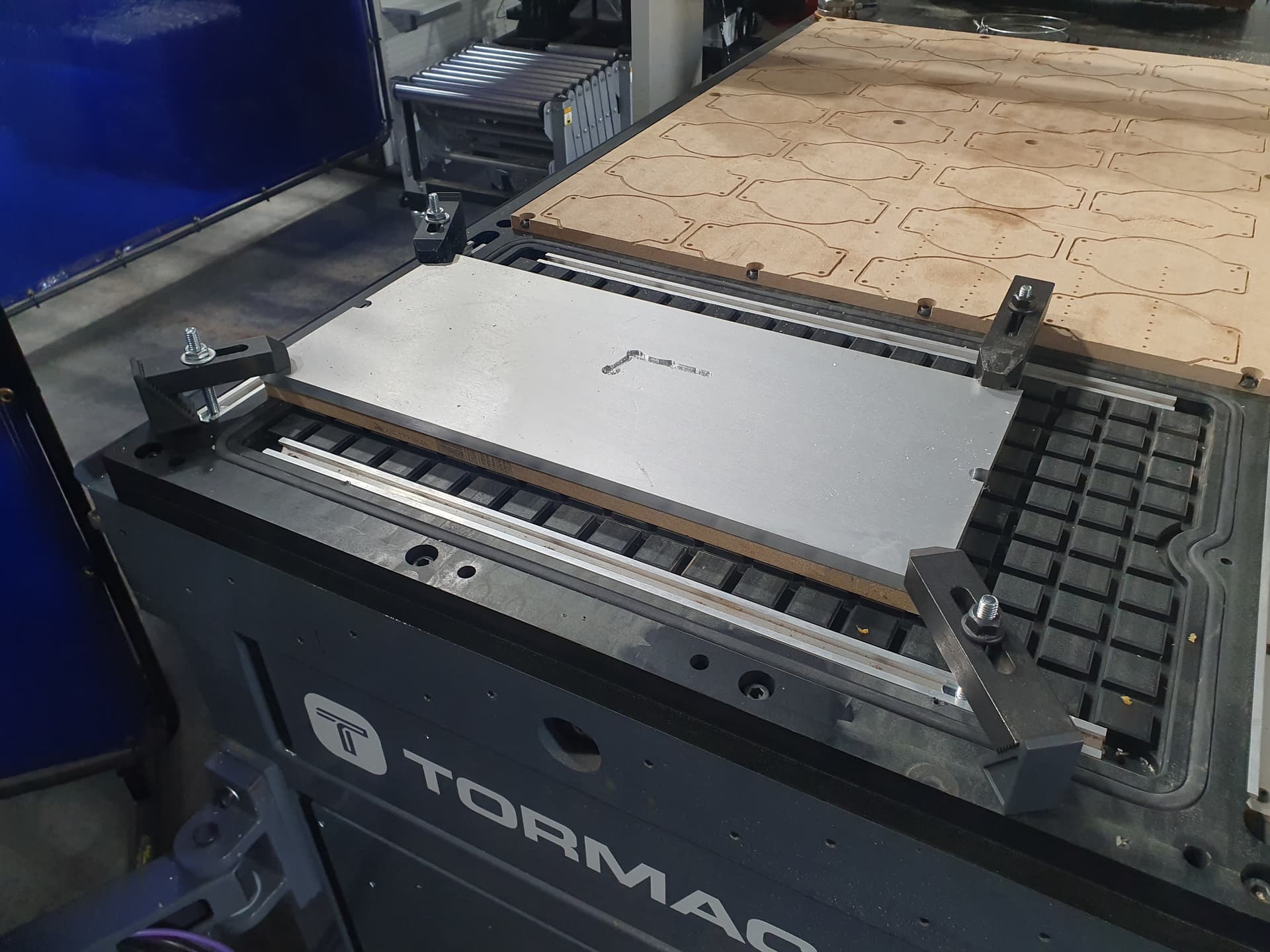

@Colin_Kingsbury the t-slot rails on the 24R are the same width as Rockler t-bolts and the 5/16 size bolts work really well with the toe clamp kit we sell with the 440.
Here is that setup in the showroom when I paused the machine to change the program.

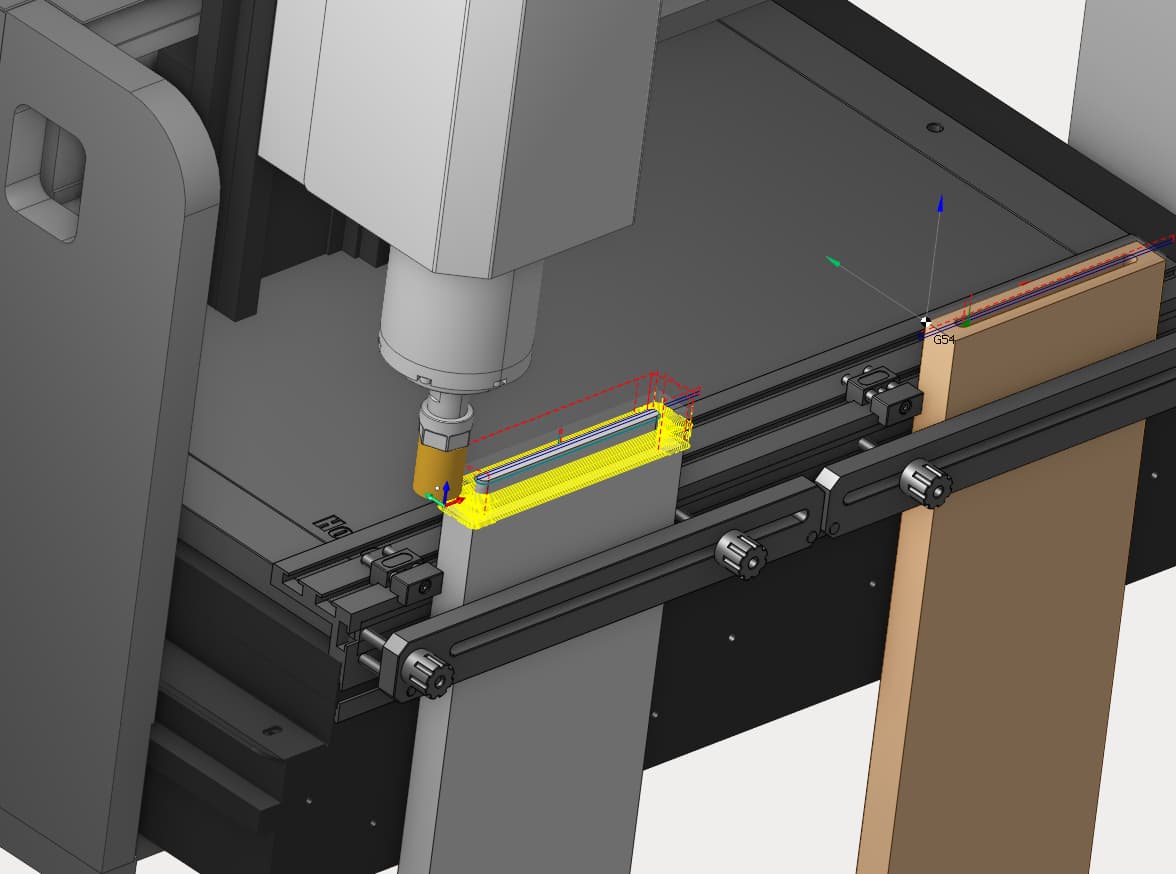

I also have a apron clamping fixture shown in picture holding some plastic sheet.
This allows me to perform router functions on ends of long material also
you only get like 1.5 inches on apron setups before you hit limits :rofl:

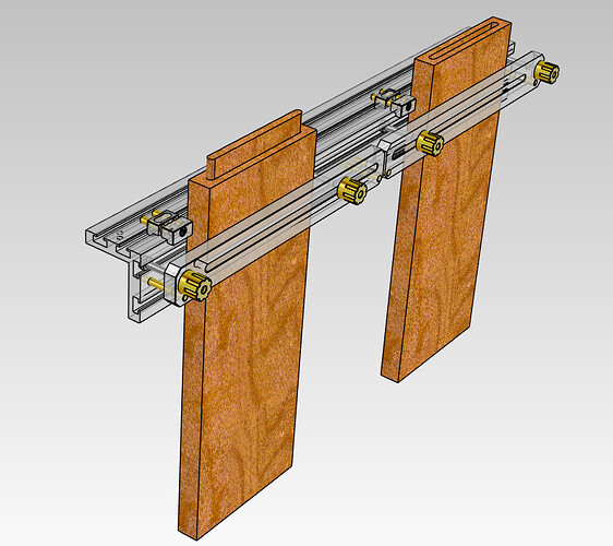

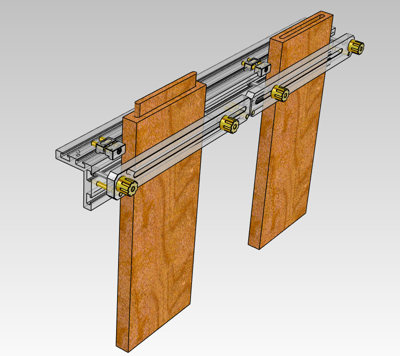

Here is the fixture template I use in cad that gets sent to Sprutcam for apron operation setup
A picture of the Sprutcam setup for milling on the apron fixture
more ideas for router material fixturing and how to setup in cad/cam to avoid crashing tools
