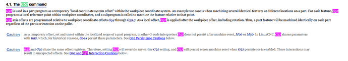

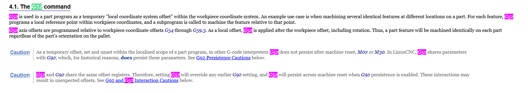

I’m somewhat confused as to why this would cause issues only in the case that I add probing routines, as runs correctly/repeatably otherwise. G52 operates similarly to G92, except the offset shouldn’t be persistent cycle to cycle, no?
Or is this a case where Tormach/Linuxcnc just doesn’t fully support G52?
I’d love to know what I’m missing here.
EDIT:
Okay, so the linuxcnc docs seem to be saying that G52 stores offset in the G92 registers, which do persist, so it functionally circumvents the intended behavior you’d see in other gcode flavors. Good to know, but I’m still not sure why the zero only shifts with probing in that case?
Past experience tells me G52 is the best way to break out subroutines for multi-step workflows where you have to flip or rotate the work piece, but if it doesn’t work here it doesn’t work.

Adding G92.1 and G52 X0 Y0 Z0 to the program right before M30 clears the state. If the linuxcnc docs are accurate, they should do the exact same thing (since they’d clear the same registers) – I’ll do an A/B test on which one fixes the issue (or if both do) when I have more time.
The program runs correctly now with the additions, but, oddly enough, the preview shows the offset that was showing up after running a cycle, (in reality, but not in the preview) prior to adding those lines, and visually updates at an incorrect position while running a cycle. Don’t know how to explain that, but it works as intended now.
