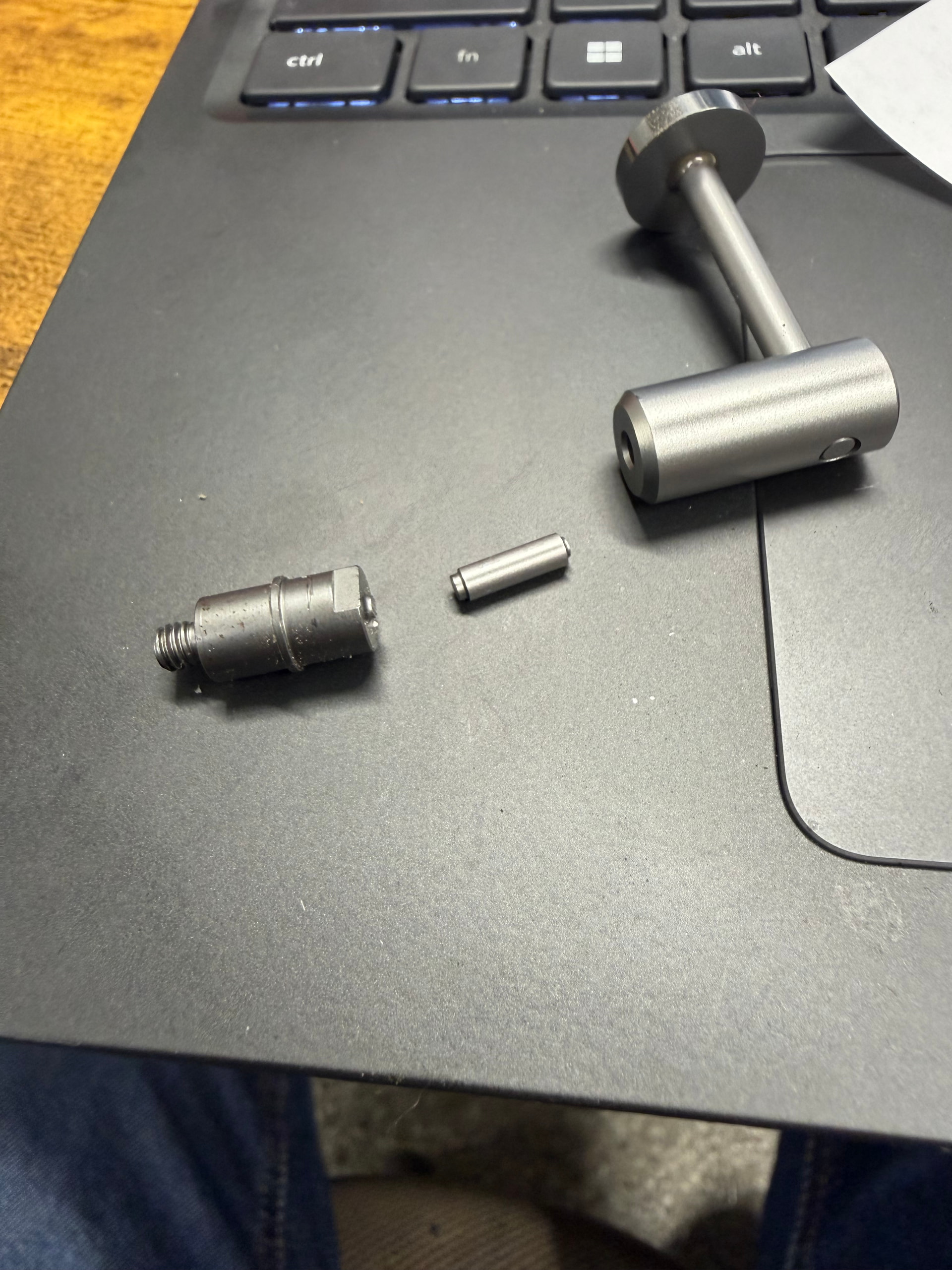

I have a Tormach 1500mx that was purchased earlier this year, along with the wireless probe and toolsetter system. Yesterday we had an issue with the ATC and it dropped a tool holder after a tool change, right on to the tool setter stylus. The ATC had a couple screws that had worked themselves loose so that the carrier was wobbly, I hadn’t noticed yet, and the spindle couldnt grab the tool holder properly which allowed it to drop onto the stylus. The part that broke is a part that is meant to break when something like this happens. I called up Tormach to see if I could get that replacement piece from them and unfortunately was told no, I would have to find a Marposs distributor to sell me one. All Tormach could do is give me the part #1027877527, which was helpful I guess. Anyways I started searching and was able to get someone on the phone at motionusa.com They had to look it up and said they would get back to me. Today I got an email saying I could get it shipped in 2-3 days for the low price of $150. Ouch, they must make them in very small batches to charge so much… So anyways check your ATC for any loose screws.

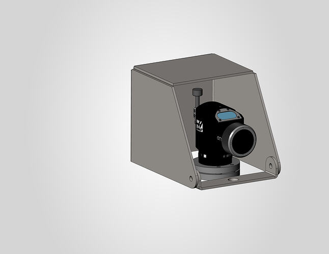

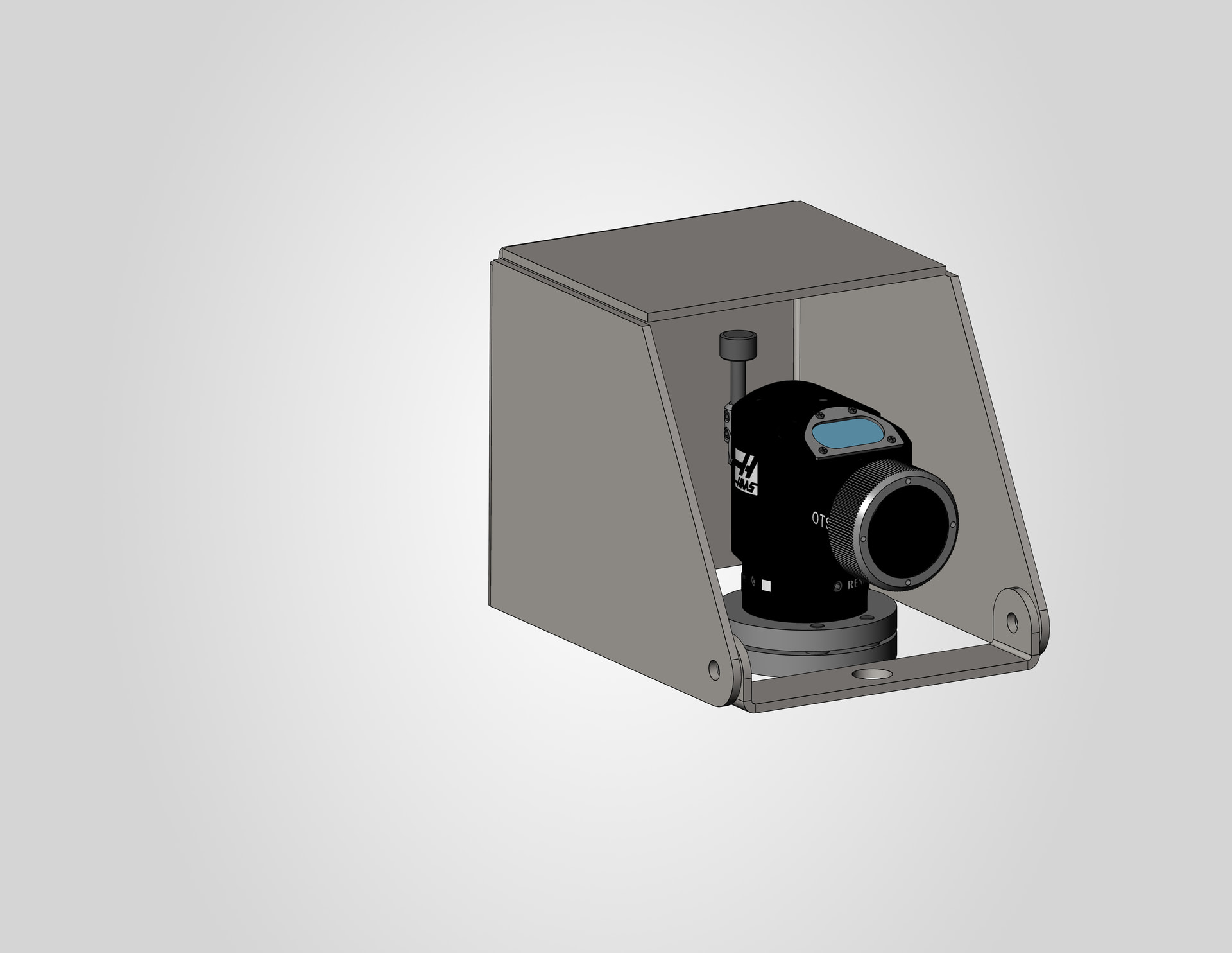

Tangentially, I need to build a shield for this thing. I used to own a few HAAS machines at my old business and I had built the protector shown in my attached image for it. It saved the tool setter quite a few times when employees chucked parts out of the vices at high rates of speed. It wouldnt have really helped in this situation unfortunately…

We started to send out a new model of gearbox for the ATC’s in late March that you would have just missed out on, the new gearbox is intended to address the wobbliness. We are warrantying them for all customers, just put a tech support ticket in: Jira Service Management

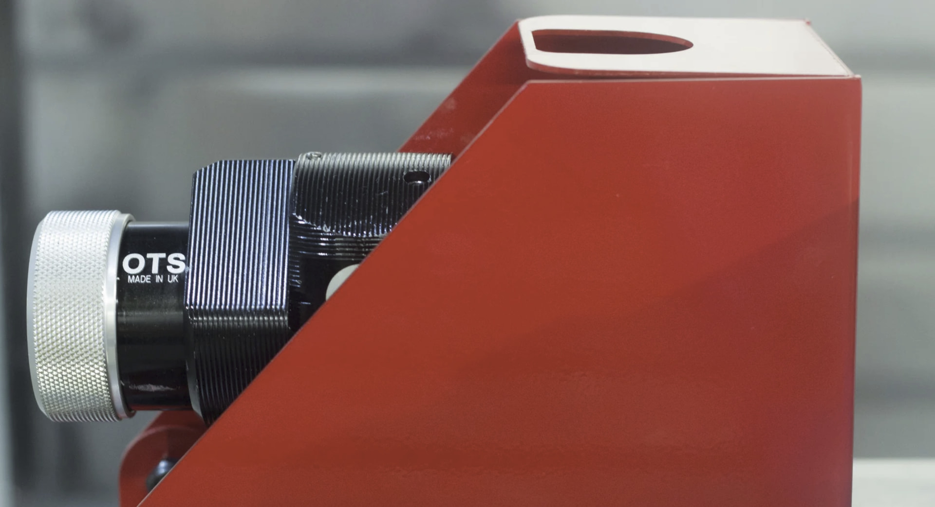

You can add a hole to the top of the cover for tool breakage detection and touchoff of small-ish diameter tools. A friend of mine sold a line of similar tool setter covers and I took it over at the beginning of the year. I’m getting modified baseplates for the Pioneer OTS very soon but the Marposs VOTS90’s base is just too wide to fit, I need to work on a wider version for it.

Thank you Norman. Waranty claim submitted. I probably copied your friends design from seeing it, I know it wasnt my idea. I just wanted it and had the design and manufacturing ability to make my own. How much does yours sell for or do you have a link for a product page?
Donald,
Renishield.com redirects to the page for it.
