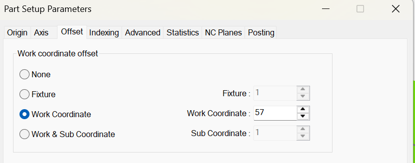

What does this warning mean: work offset 57 is all zeros (effectively G53)
I am using Work offset 57 for seconds ops in Solidworks CAM. I get this warning

The “xx offset is all zeros” error means that a work offset has not been set for that work coordinate.

Thank you for quick response. I was using PP simulator and then didn’t ref axis before running the code. Thanks again
FWIW. You this error isn’t related to not referencing the axes. This error is saying that you never setup G57 (touched off your zeros)
Thanks Davie, I received this error on PP pathpilot but on actual Tormach there was no such error. Thanks again.
