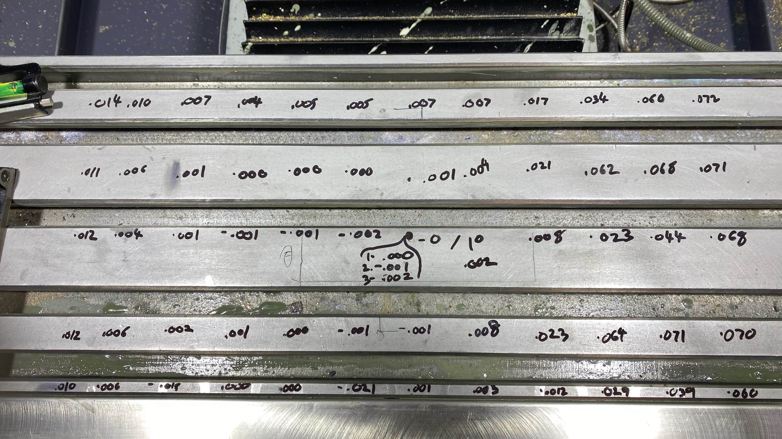

When I was having issues I mapped the table height along x and y. You could also map the edge of the t-slot as they are ground and should be refrence.

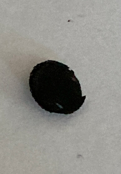

So I found two problems. Firstly, the bed surface that runs on the ways where totally dry with the rear one having a sticky feel to it. Cleaning both surfaces with denatured alcohol showed a hint of green which I assume is the bearing material.
I use the automatic oiler set to 12 seconds so I started checking oil lines, etc and everything looked fine… I took out the front oil galley plug in the bed and ran the automatic oiler and started to get way oil and chunks of black rubber (RTV?) .
Ran the oiler for about a minute until the little chunks stopped coming out… and repeated on the rear oil galley and also go a few tiny black chunks… Hopefully the oil grooves on the ways are not packed with this mystery rubber material and the bearing material isn’t too damaged.
I removed the X axis Gib and verified it wasn’t packed with rubber material and the oil passage was free.
I increased the run time of the oiler from 12 seconds to 20 seconds (It takes 6-7 seconds for oil to show up at the oil galley on the table) and now the sliding surfaces appear to be getting oil.
