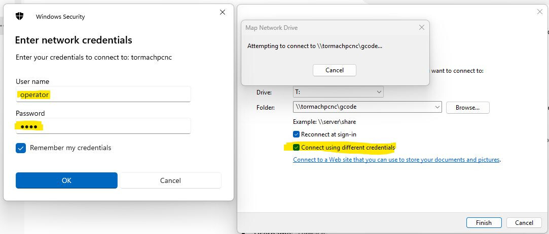

Unable to send posts to TORMACH since major windows 11 update
I send my posts to the 770MX from my laptop to my T: drive. It’s no longer seeing that drive since latest pathpilot update 2.12.2
Any ideas how to fix this please?

Hmmmmm. I thought I had solved this, but I haven’t. It appears my windows 11 pro version 24H2 seems to now require a credentials username and password in order to map the network drive of the tormach onto my laptop. Something about insecure guest login. I am totally out of my depth, so I shall start a ticket with Tech Support. Anyone else had this since updating their copy of windows?
@Steve_Dunthorne I had a previous customer that found a solution to this Windows issue. We were at our wits end on the machine side. Here is what this customer found:
“Changing the windows authentication policy to allow insecure guest logins allowed the network share to be mapped”
“…I did turn off the Enable Insecure Guest Logons again for security reasons and used the Connect using Different credentials to map the network drive drive. This, along with enabling SMB (and an assist from ChatGPT to find the default logon credentials, LOL) corrected the behavior.”
I will admit, this is a bit out of my depth, but I figured I would share it here, just in case it helped anyone else!

Sam, this is fantastic, thank you! I have set my ‘enable insecure guest logons’ back to ‘NOT CONFIGURED’ as that is how they were originally. Then I set up my T:\ drive again as a mapped network drive, this time, as you suggest, connecting using different credentials, and immediately have full drive access of the Tormach drive to both my computers.

The mapping issue was solved for me by using this… (Windows 11)
Enter network credentials:
User name: operator
Password: pcnc
There was no need to change the Windows authentication policy.
