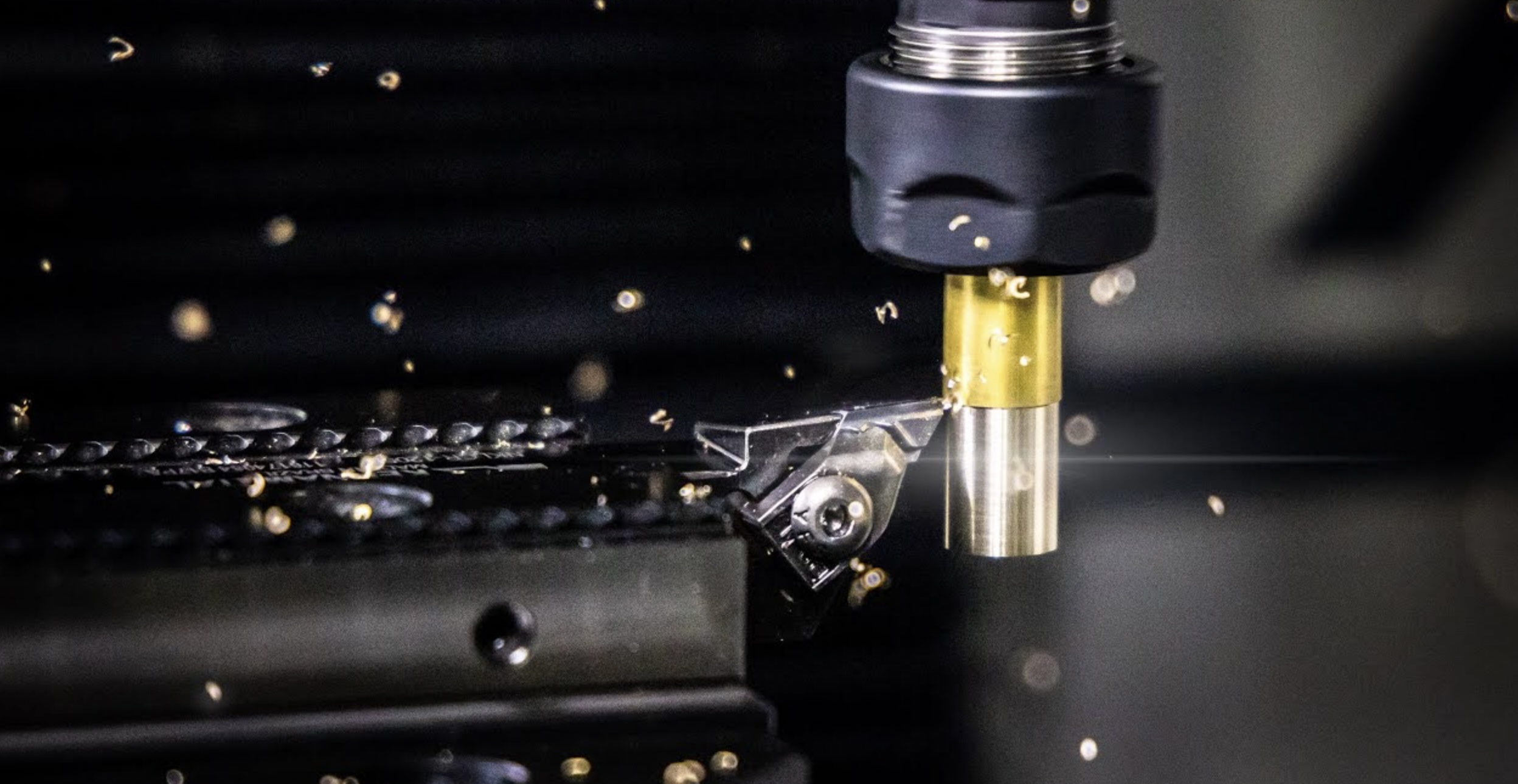

Turning an aluminum knob on a mill
Using the spindle to hold the stock and a vice to hold the lathe tool on X is there some way to trick fusion into cuting a profile? I’ve been working for days to get my lathe to do it but I just can’t get anywhere. (Sherline lathes apparently never had a working post processor).
It’s just a simple small aluminum knob and I was just thinking if I could set fusion up so it thinks the mill is a lathe I could be done.
I’ve never done this, but are you talking about millturning?
I don’t know? Not using a rapid turn.
Like this but turning a profile for a knob.
There’s several YouTube videos out there on this. Here’s one but there’s a lot more. https://youtu.be/XtnjgdB1ghU?si=osL72sjr90kvfxfN

We’ve done this on our Haas TM1-P mill and made spinning tops (before we bought our 8L). I ended up hand-coding it and becoming way more familiar with G18 than I had been before. Depending on your part’s complexity, that’s not a bad way to go with it. I bet that you could run a complex part through Fusion’s 8L post and utilize those X and Z movements. You’ll still have to copy/paste them into a mill program, but that’s most of the work done. Best of luck!
Yes. I used to do that quite a bit a while back. The most important thing to do is to add turning to the capabilities list in the post processor. From there, it’s “relatively” straight forward. Put Fusion in lathe mode and build your program. Tool changes are kind of a nightmare though, you need to use a separate WCS for each one. Back when I was doing this I built a gang block to hold a variety of tools and wrote a program so I could touch off on one corner of the block and automatically set all 7 WCS based on known offsets to each from that initial corner. It worked really well but was definitely a good bit of work to get started. I even wrote a modified post that enabled CSS in mill mode so I could get better surface finishes. That’s still posted over on cnczone I think.
Here’s a video of the gang block in use and showing the CSS function working: https://youtu.be/5Js1YjJoYyk?si=U2HAvc_vtDmXE57D
This was kind of the culmination of the whole project, and also, more or less the last time I used my mill this way: https://youtu.be/5L-7aJxUBK0?si=FdtWAQbT8dSuNVkr
I’ve since gotten a rapidturn which I rarely use either so I scrapped the gang block.

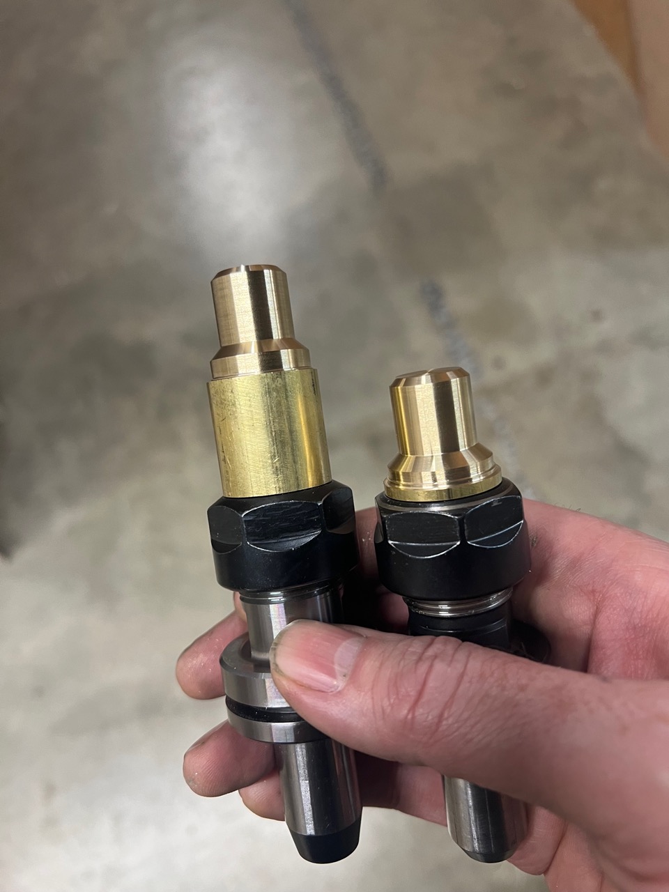

I’ve done a fair amount of mill-turning on my PCNC1100. Here are a couple of brass knobs as they came off of the mill. I set up the blanks to get 2 knobs per tool. Lacking a lathe, this is a very viable technique, especially for soft material like brass and aluminum. I can write it up as a separate community post if others are interested in seeing the steps.
