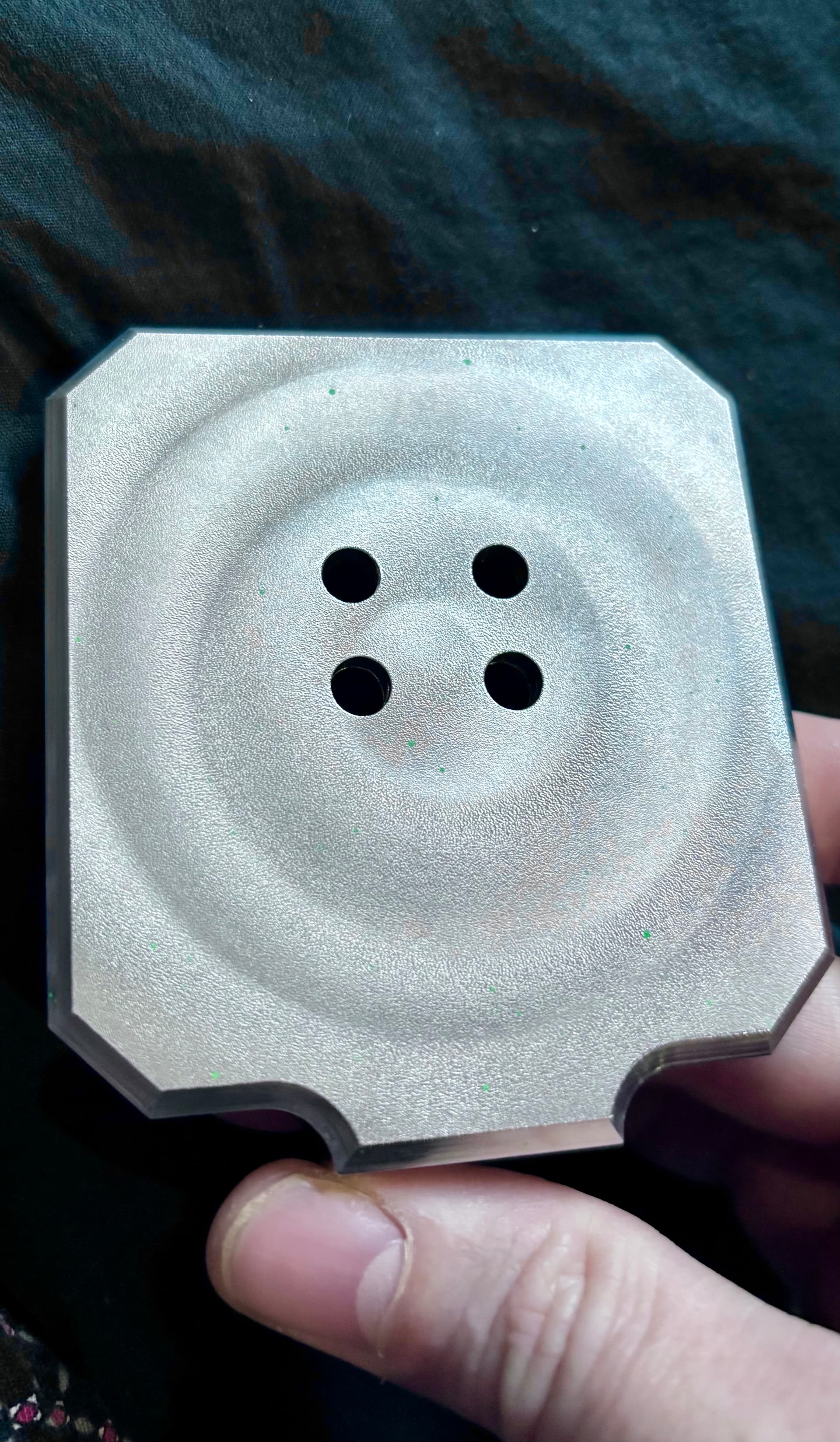

I’ve been working on spiral matte brushed finish for the Santa bases. Its some kind of magic, takes a brass brush, rubbing alcohol compressed air and lots of luck.
