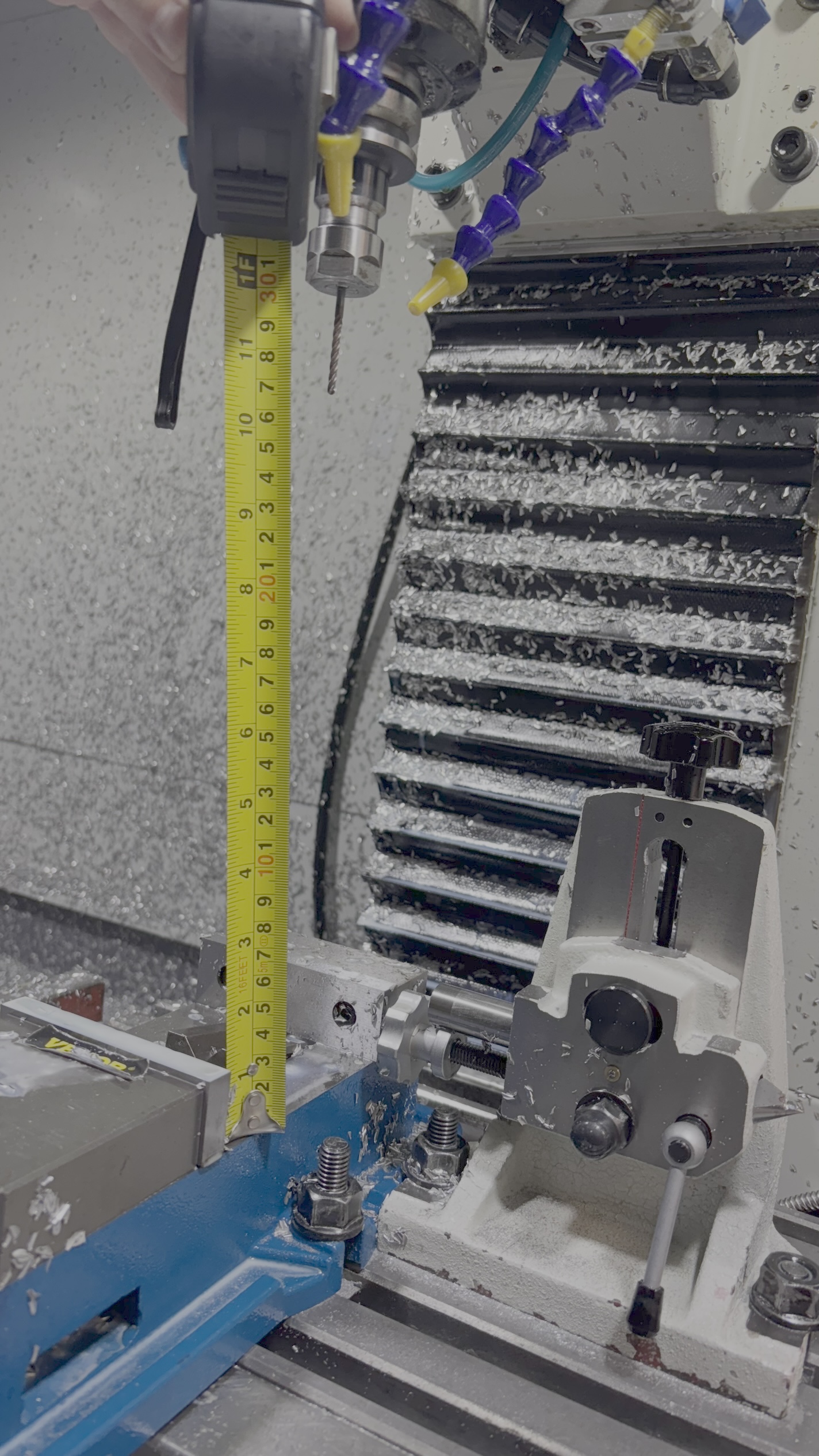

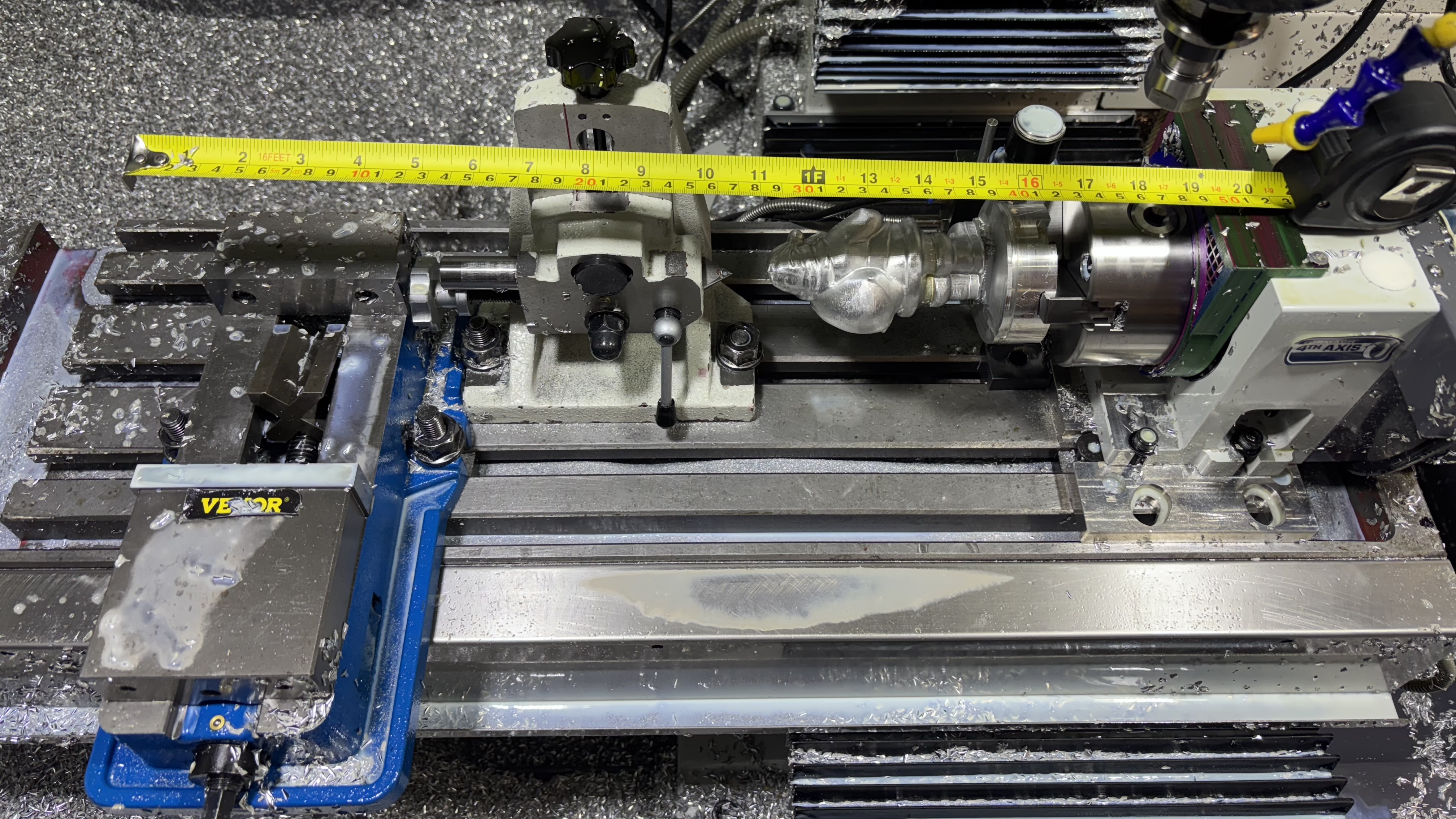

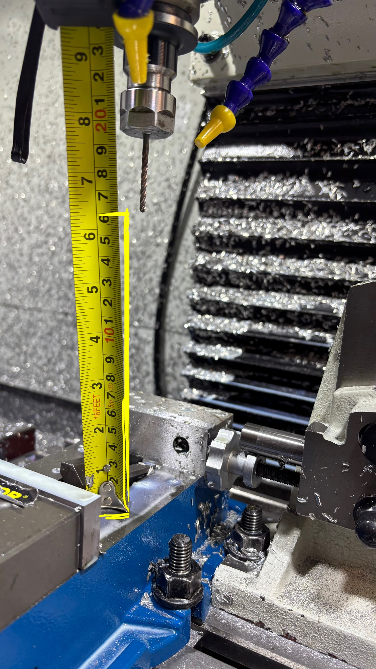

The Syil is really fast and all the servos and spindle are a lot more powerful than the tormach but the travels are tiny. 12” vertical with a 4” tool hanging out and a vice 1.5” tall minimum is 6.5” tall max! That’s really small. You could fit a cylinder head on there just barely. I’m hoping that they have a lot of table outside the machining envelope to put the a-axis on because if it takes up even 1” of machine envelope then you can’t even make a decent hoagie! My machine table is packed right now and I’m making 4” tall Santa Clauses!
That’s .03mm of clearance on the left side of the envelope that I had to fight for so I can run the body and the base without having to move the vice and tail stock between operations. I had to give the vice a little shave on side of the bolt hold down to get that .03mm. And on the right my a-axis hold downs are poking out the end of the T-slot.
So when your shopping and it says 12” wide table, that’s enough if you are making 2” Santa’s.
