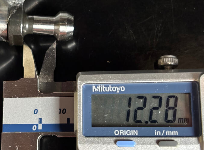

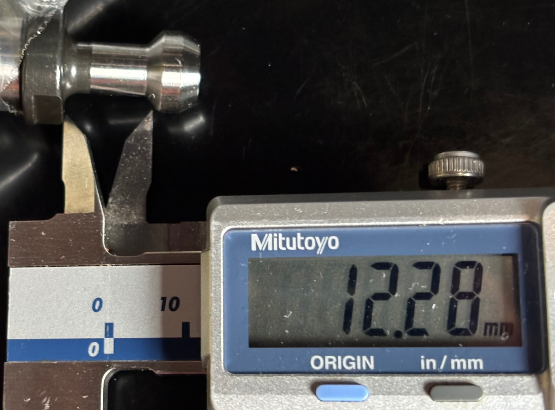

I’m asking if a couple people could post a video of changing the tool on their 1100mx BT-30. I went through a lot when it was new with the tool releasing like the kick from a shotgun. I am thinking of getting a tool changer and I am afraid the tool holder would blast right through the changer fork. Just want to se some for comparison. That way I can see if I can fix one problem before compounding.
That’s .483 inch.
