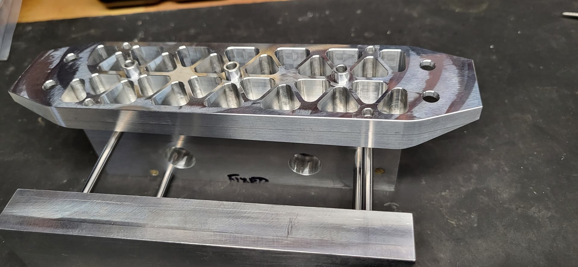

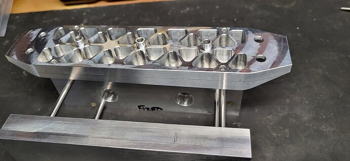

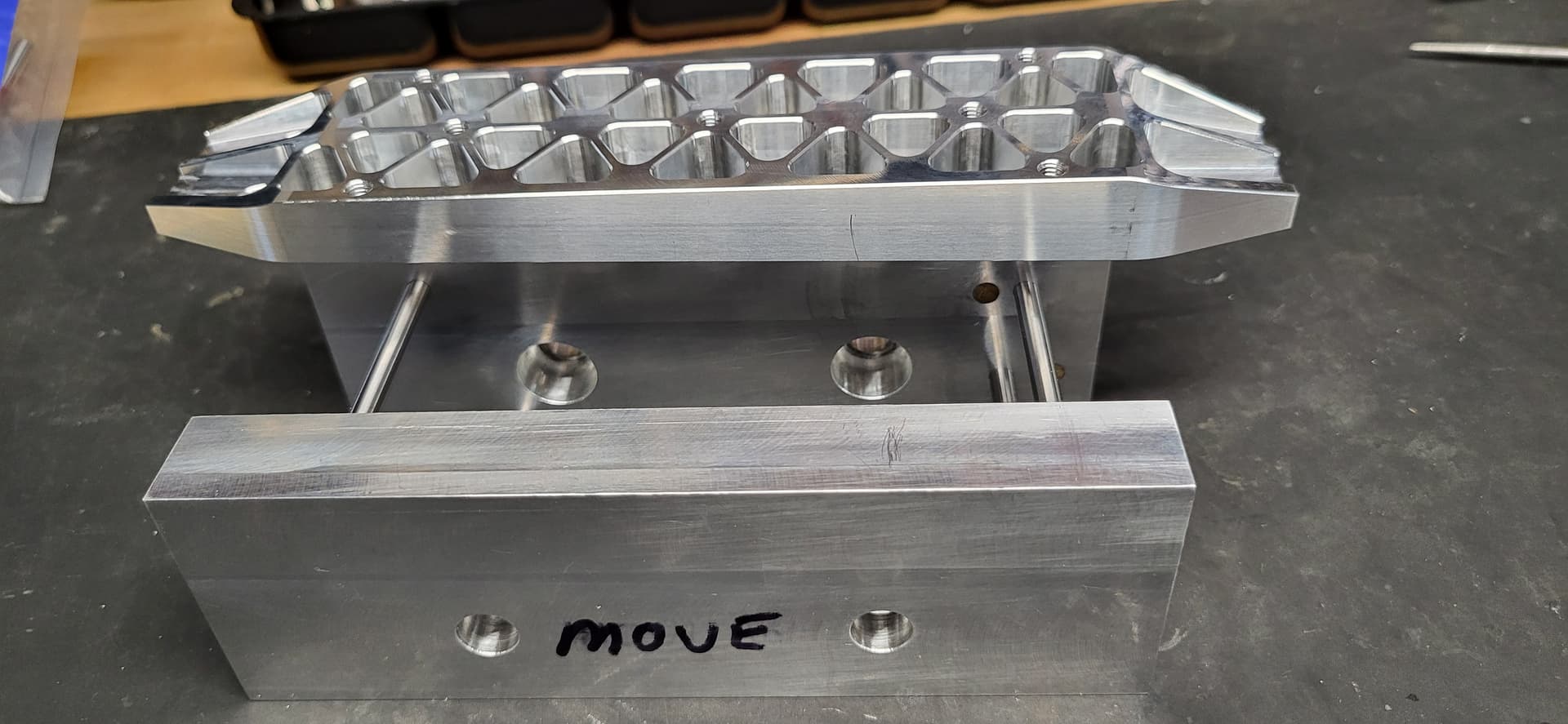

Went through Titans building blocks for fun, and experience. This is the T10M. Required a jig for angles. Probably try some 5 axis parts on the 4th plus additional setups. Maybe chess set.

What is it?
It’s a typical aerospace part, iso grid structure. Light, strong and yes, lots of time for pockets. Really good learning experience. Toughest part was chamfers on top end pockets at the radius and bolt pockets. Not exactly 45 deg angles.
