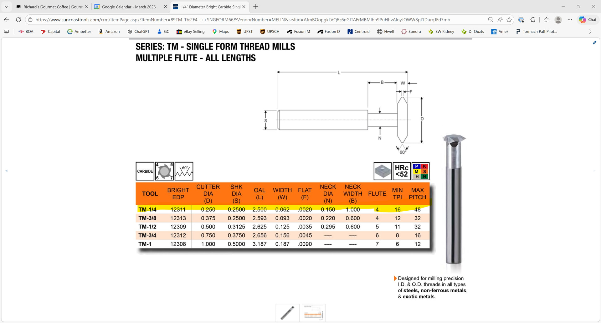

This is my first attempt at threadmill and hope someone can check it out. I would like to thread mill a 1/4-20 thread on a 1/4” diameter aluminum shaft. The details of the thread mill are noted below. I plan to use Fusion to set this up. Few quick questions:
  1. Setting up the tool in Fusion had a small error. I understand the flute length to be .062”. I got an error unless I entered .0625”. Not sure if this really matters.
  2. Pitch Diamter Offset. I downloaded the spread sheet from NYCCNC (see below). The first tab (Common Size Calculations) yields a PDO of .0713”, The “External Simple Tab” yields a PDO of .0824”. Looking at the simulations, the larger PDO value makes a thread with a sharp peak. The smaller figure yields a thread with a flat at the peak. Do you know which is correct.

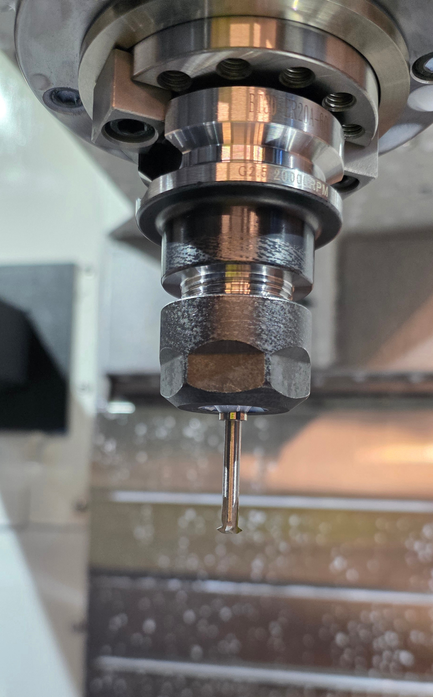

Thread Mill Details:

  1. The WOC is simply the 5% of the thread mill cutting diameter.
  2. Number of passes should equal ((PDO/2) / (Cutting Diameter * .05)) rounded up to the next whole number or the (PDO/2)/WOC
  3. There are two tabs on the spreadsheet. “Internal Simple” and “External Simple”. Use the one corresponds to your internal or external thread, enter the Major and Minor diameter, cutter diameter and the width of the flat section of the thread mill and your done… is outputs the PDO.

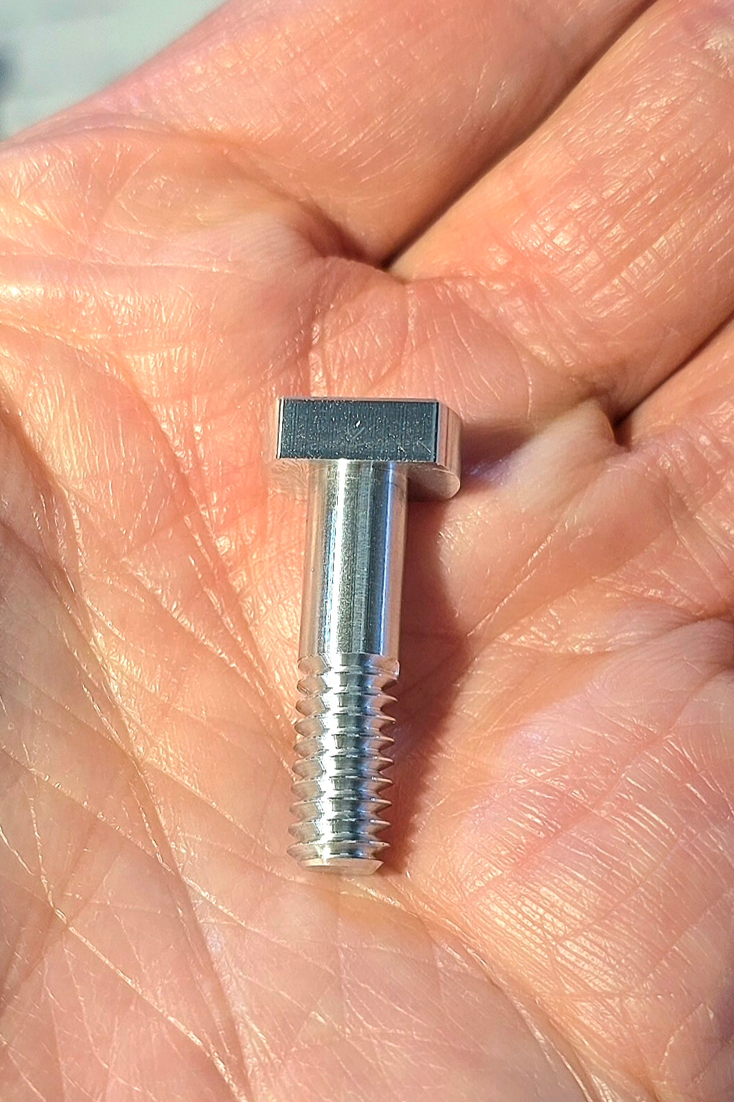

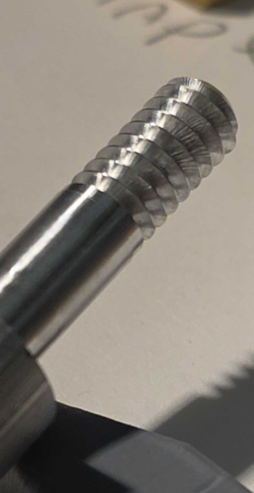

My first attempt at thread milling was to use PathPilot conversational. I attempted a similar part as below, but it only had .25 inches of thread as opposed to the .5” of thread below. When I cut the threads, it sounded fine and looked good, but the threads did not work. Norman at Tormach suggested I try it with Fusion.

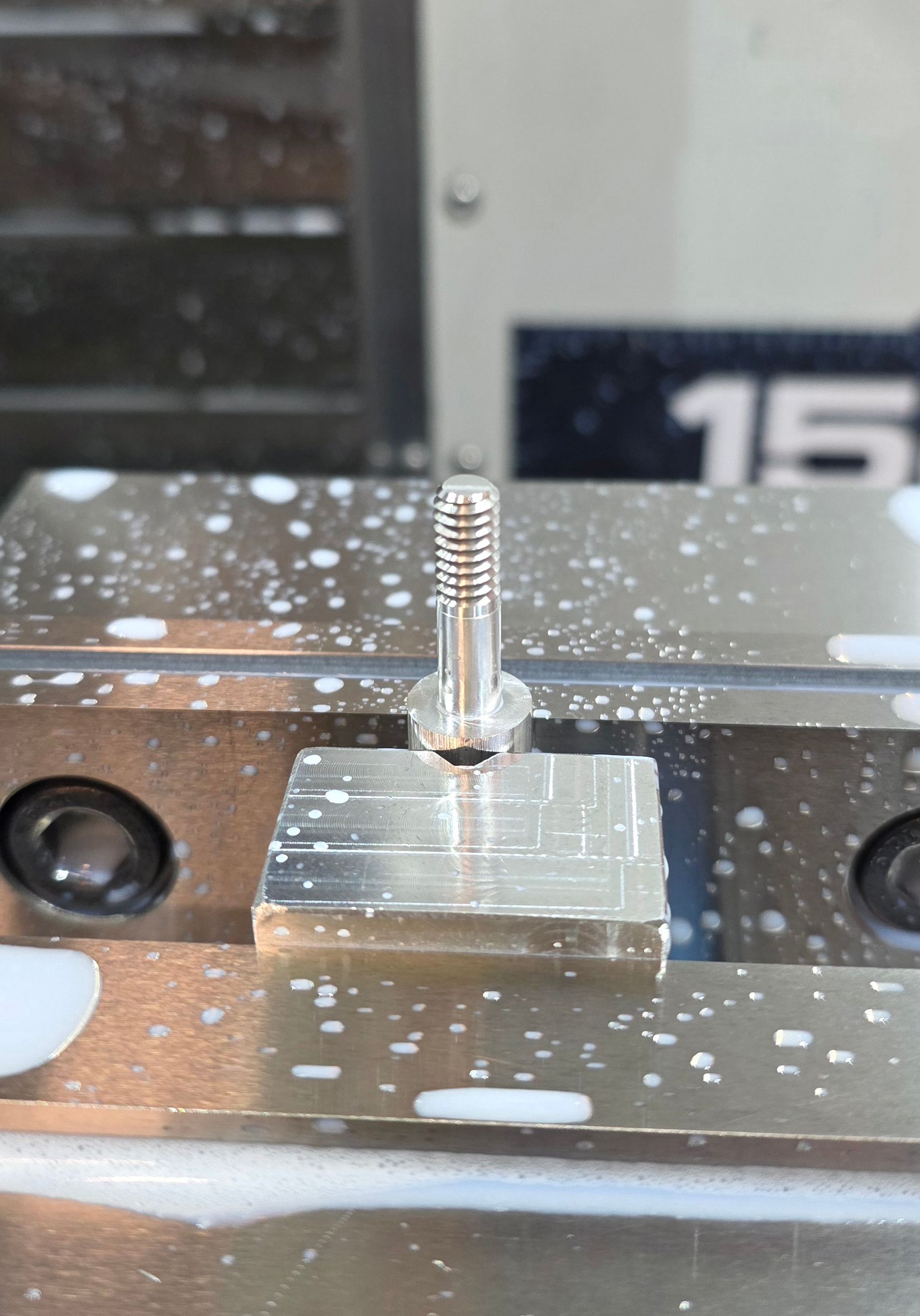

ran the 1/4-20 threaded 60601 aluminum part show below using Fusion with the same feeds and speeds and depth of cut per pass x a total of 3 passes. For some reason while running this with Fusion, I heard a fair amount of noise while machining. I did not hear that with conversational. Under magnification, I see what looks like chatter to me. I am a bit lost here because I am attempting to replicate what I did with conversational. One thing I noticed was that the first pass did not cut almost anything.
Any idea what is causing the chatter? Is it because the threaded area is longer? I tried lighter passes as well and had the same issue.
Details: PDO = .077”. 3 step overs of .018”

Is the part aluminum and the v block aluminum? Try a bigger groove to get the round bar in there farther. Because it’s aluminum it’s going to flex. If you can cut just the thread part and then threads and then the rest of the shaft. If it’s steel you could do it the natural way.

Before commenting on the surface finish or “chatter” you mention I would ask what the speed and feed were for the cut.
I’ve noticed similar marks in internal threads I’ve cut and always attributed them to just running the tool too fast for the spindle RPM. Tool vibration could be a cause but definitely not part deflection in that case. The threads work fine and pass go/no go testing but I suppose it wouldn’t hurt to have a smoother finish. For reference in a 10-32 internal thread I’ve been running 40 IPM at 10k RPM. I’ve switch to rigid tapping for the most part now and haven’t thought much about going back to revisit the finish. I’ve read that form tapping in aluminum is the best approach, of course that doesn’t help external threading too much.

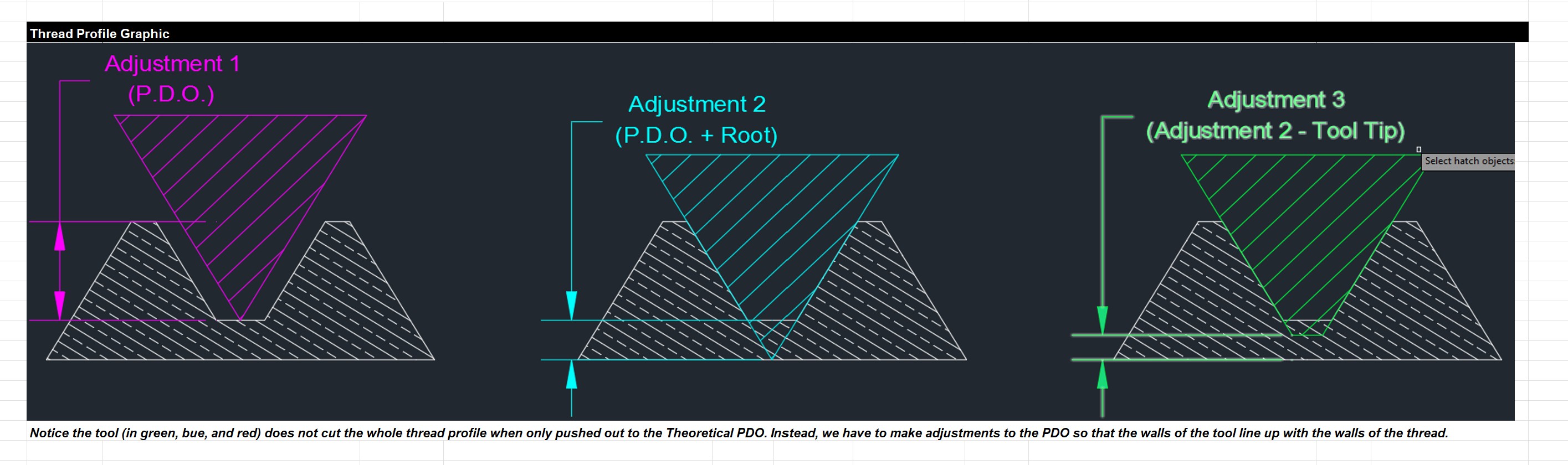

You need to remember that all thread dimensions and definitions are not for sharp, V shaped tools - like all treadmills. The definitions are to the thread flat ( or what you called rounded). You need to calculate the root and crest distance and ADD that to the thread dimensions if you want an accurate thread.

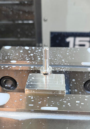

Hey guys, thanks for all the great tips. I modified the tool paths to machine the threads first, dropped the rpms from 9720 to 9000 and it came out great.
Dan, for what it is worth, the NYCCNC spreadsheet does exactly what you described. You input the major and minor diameter, thread mill cutting diameter and the thread mill flat or crest dimension and it outputs the pitch diameter offset that accounts for the fact that the thread mill does not in fact come to a sharp point. Check it out if you are interested.
Graphic from NYCCNC:
Finished part:
