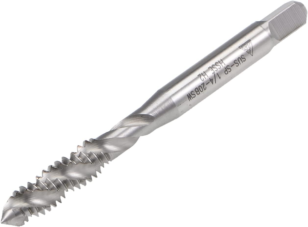

I’m looking to get your guys recommendations for the strongest and most reliable CNC taps for 6061-T6. I’m tapping 1/4-20 threads. I’m on a Tormach 1100M using the ER-20 Tormach tension compression tapping head. Holes I’m currently needing to tap are full threw holes, but I’d like your recommendations also for blind holes. The coolant I’m running is Blaser Synergy 735. I ended up scrapping a part I had quite a bit time into machining, went to tap the holes and broke the tap on the 3rd hole, so would like to avoid that again. Up to this point I have done a bit of tapping but nothing larger than 10-24 and have only used spiral flute taps, I know they are not the strongest.
I used a #7 drill .201, @500 rpm 32.7249 ft/min. Ive always ran tapping at 500. to .800 deep full through hole.
Do you guys use and like ER “Tap” collets and do you feel they are necessary? I do have 1 of them in 10-24 collet, and I like the fact that the tap can not spin in the collet because of the square hole at the bottom.
This is the tap I used and know it was probably a bad choice so I guess Ill take my beating now. I was in a hurry to get them, but as we all know hurry is not the best when it comes to CNC machining. LOL!

The spiral flute should have worked but Amazon tap is only guaranteed for one hole. Also how deep is the hole?

Your strongest threads will be from a roll form tap. Those also have an advantage that there’s no chips. to mess things up . They do take more HP to run effectively but an 1100M should be OK in Aluminum at 1/4-20 (check this if you use slow speeds and high belt). You have to drill a different size hole and it needs to be a good hole where it’s supposed to be (as do other taps, but even more so), so center drill, skip the cheapy Amazon drills and use a good stub length bit.
I use spiral flute for blind holes and spiral tip for through holes. Usually anyway, sometimes I only have one or the other so I use them in the “wrong” hole type, just have to be very mindful of leaving a gap at the bottom when running a spiral tip in a blind hole. I’ve also run form taps in through and blind holes. All have worked well for me and I’ve yet to break a tap (knock on EVERY piece of wood I can find).

Overall, your parameters are more or less the same that I’ve used for hundreds of holes spread across three taps, all of which are still in my tool crib waiting to get used again. My best guess is you just ended up with a junk tool. Get something better and you are likely to have much greater success without changing anything else.

Thanks for the input the tap I used was HHS, and my feed was 32.7249 ft/min. Is this to fast.
1/4-20 @ 500rpm should be 25in/min feed. I think you’re confusing surface footage (which would be roughly 32.7ft/min) with feed rate. Assuming thats the case, no I wouldn’t consider that too fast. I run my 1/4-20 taps anywhere from 250-1000rpm depending on the material but for aluminum, I would be on the higher side. All of my taps are HSS, I’m too cheap for carbide taps.

Thanks for the input on this guys, I got new Shars taps and ran several tests last night with good results so problem solved. It must have been the cheep quality tap or trying to tap to deep OR both.
I ran both #7 & #6 drills at multiple depths from .5-.75 with a plug tap in full through holes. All worked fine. Was told by Shars sales that max depth for bottom tap is .65.

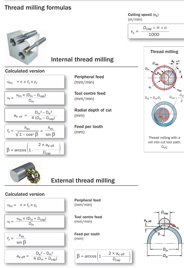

I use the Sandvic Cormorant tools reference!
I think they still have it to download, Just go poke around their site to find it.
It has formulas for about any machine tool operation.
quick clip of one page of many
