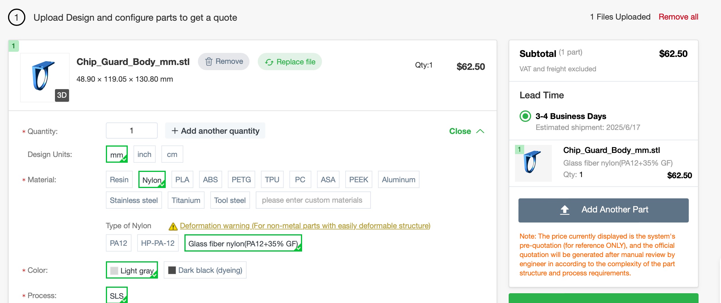

I could mill the guard from a solid $400 block of delrin, or have it printed for $500. Problem is I don’t trust the 3d printing websites to use the right plastic and I don’t want to spend $400 for plastic and mill 87% of it away.
You could buy a cheap 3D printer and print your own for way less than $400. There ought to be a schoolboy or two around with one not too far away.

$500 to print? Out of what material? For that price it better be metal! According to my slicer printing in Prusa brand ASA that should run about $2.21 in materials with 4 perimeters and 25% infill, and use 63g of filament. Now if they are charging you $497 in labor that is way, excessive. Even SLS printed in nylon-G this comes out under $65 on PCBway…
I am in the UK so shipping adds $50. If it’s a single
