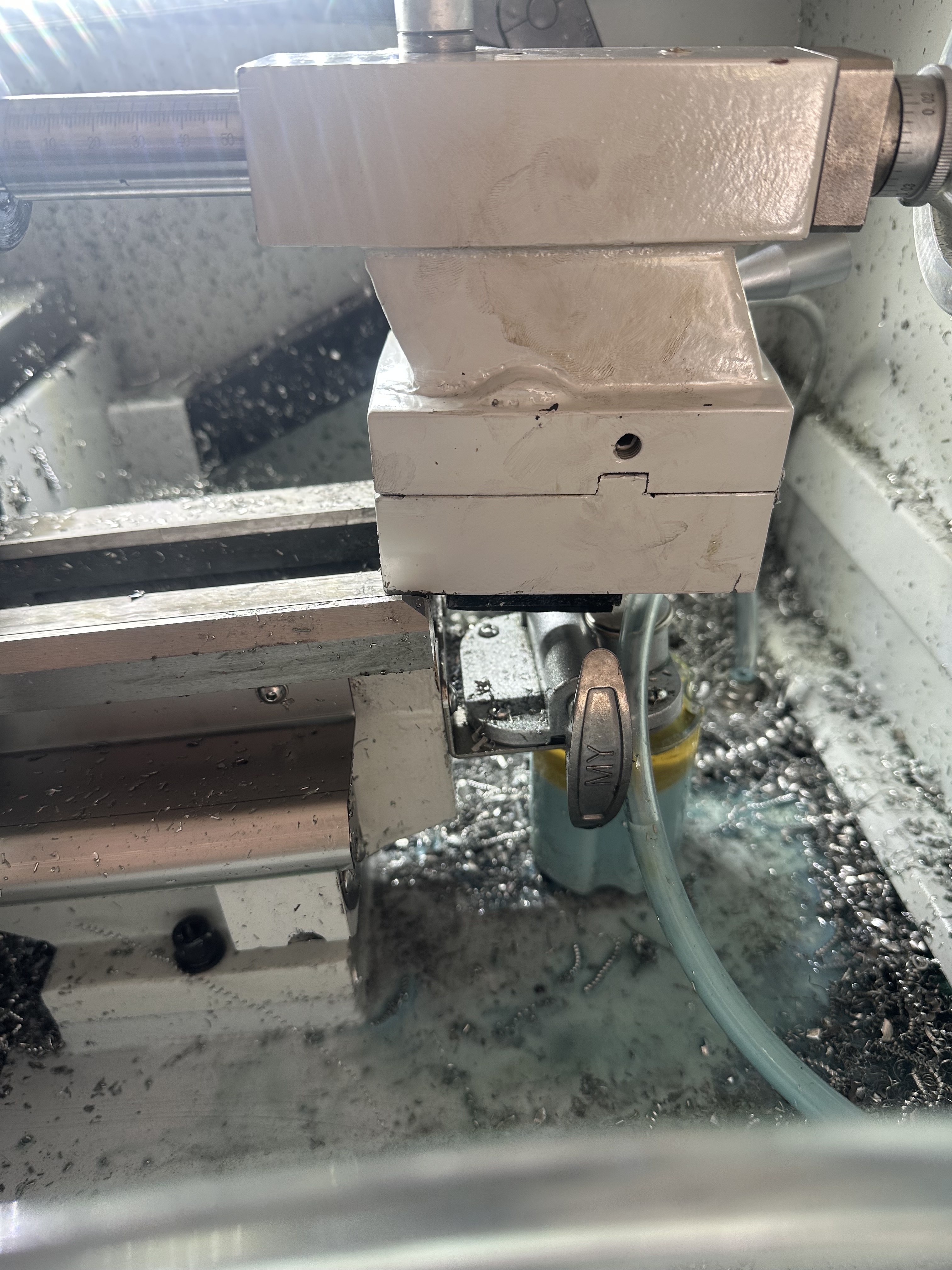

So my tailstock lever was not catching and locking down the tailstock so I took it off and found the problem! The bolt that went on the T nut at the bottom was a little loose so I tighten it and fixed it however I can’t get the tailstock back on because of the T nut
This is on the 8L lathe by the way
Hey it looks like the way oiler reservoir is off the pump and full of ?
It’s coolant but I don’t need help with that I need to put my tailstock back on
Turn the T nut 1/2 a turn less and slide on tailstock. You might need to align and hold t-nut flat while you slide it on. I had to adjust my tail stock a couple years ago and had no problem. You just have to fiddle with it a little to get it right.

Yeah. I had to fiddle with my tail stock a little bit by taking it off, making a small adjustment to the tension bolt, and putting it back on. After a few times I got it right where I want it and haven’t had to mess with it.
