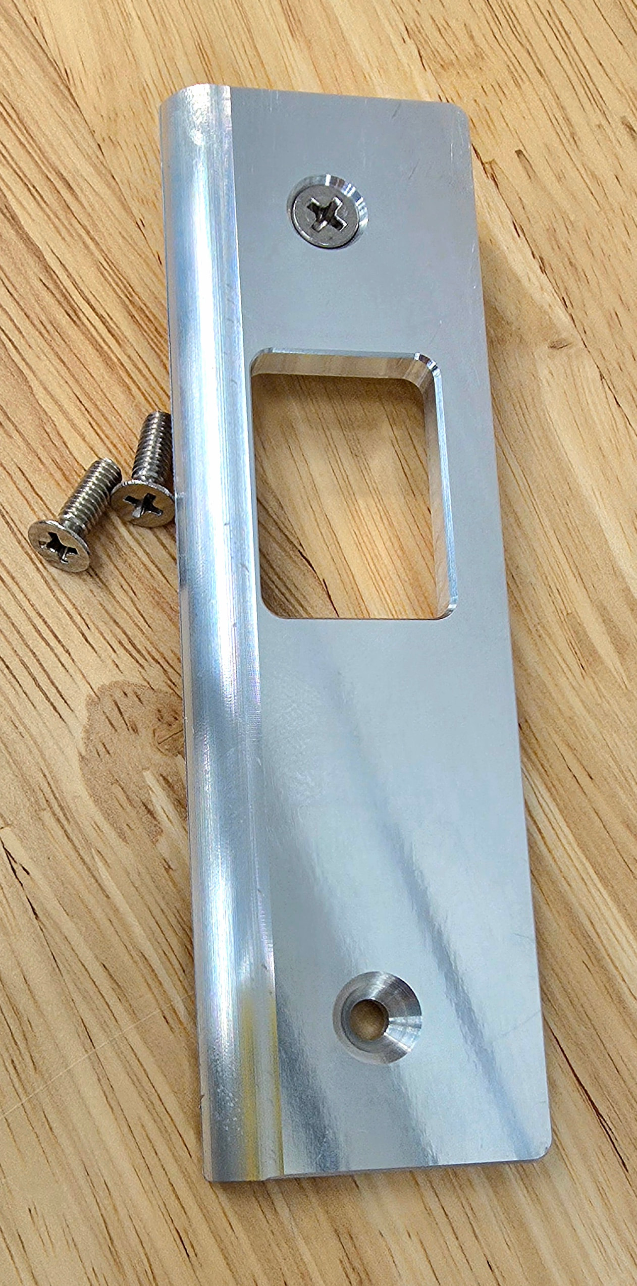

As for the Loctite professional vs the Loctite 480 which is many times more costly, I am going to use it tomorrow on the actual part I am machining just to be on the safe side and because it is a small part with little surface area…. and I’m just not in the mood to break another end mill. But I honestly think in the future on larger parts I will definitely stick with the Loctite Professional.
Best… Richard
PS: I did find both samples fairly hard to separate. I heated one corner with a butane torch for a minute or two and pried a chisel between them and then they came loose.
Ok, the final verdict. I made a number of these parts using the green tape and inexpensive Loctite professional. This combination works great, even holding down the thin areas of this part with no problem at all. As a test, I soaked the base that was holding the part for 48 hours in flood coolant and the tape did not break down. I would be comfortable using this combo anytime.
