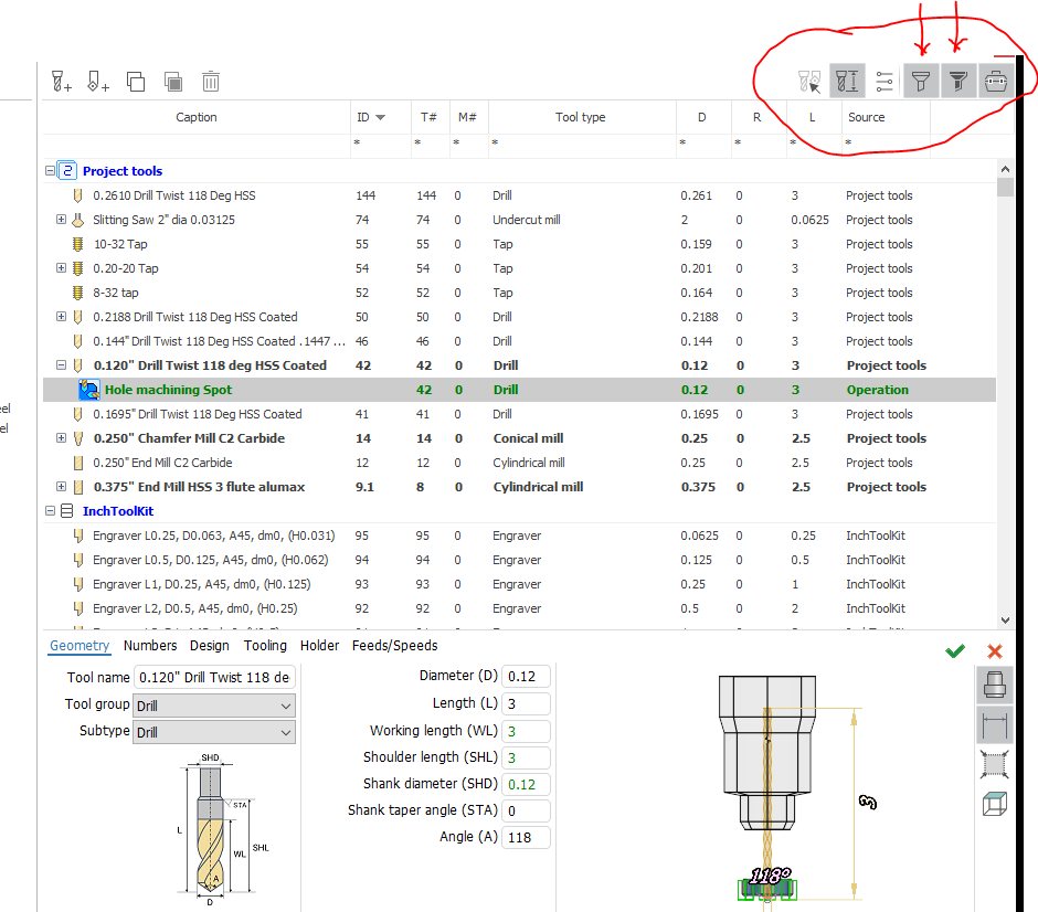

I am setting up SC to run a project. I decided to create a tool library for this job, most of which are standard tool that I regularly use. Four of the tools are drills in drill chucks. When I enter these tools they stay until I click add a tool then they disappear. Is a drill not a machining tool? Can it only be entered In conjunction with the drilling job in the part being drilled, but not my tool library?
Art
you have filters set to show used tools but you have not setup operations with any tools yet.
At any rate fiddle with the buttons circled in red until you see what you want. I tend to show all tools and not filter at all
Thanks Lane, simple enough solution. I tend not to mess with stuff when I don’t know what it does, as well as being able to extricate myself from what I’ve done.
