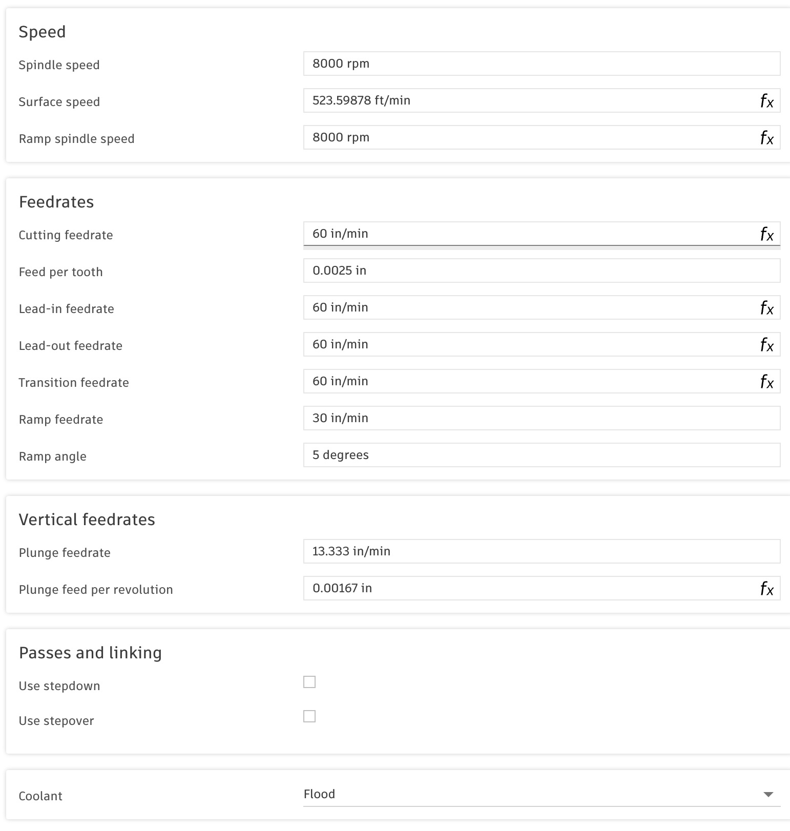

Thanks for all your thoughts. Most of these comments are what I have been experimenting with. Two questions:
  1. Let’s talk 6061 aluminums (most of what I run). I use mostly YG1 bright (Uncoated) end mills circled on the attached. As a starting point, what percentage of the diameter would you use for the WOC. Typically, I use a smaller percentage on smaller tools. What do you reccomend for lets say 1/2”, 3/8”, 1/4”, 3/16” and 1/8”?
  2. If you are ramping down into a hole let’s say with a 2-degree ramp angle, do you slow down the feed rate more than for normal milling?

For shorter end mills like the ones listed, I would go with about .25 x diameter maximum for radial DoC and whatever axial depth up to the flute length. Less for finishing passes, perhaps .15 x diameter maximum. More axial engagement might be a cause to reduce radial depth. All cutter sizes would get the same percentage of engagement at least in these ranges. With the 1/2 inch cutter you will find the machine struggling with full radial and axial DoC so act accordingly. Watch the spindle load on larger cutters as a guide to what limits to use.
The part that I find most important is the chip load, which I didn’t see mentioned on the attached PDF. A rule of thumb I would start with for end mills like these (3 flute, short in aluminum) is 1/100th of the diameter per tooth. So a .25 inch cutter would need a chip load per tooth of about .0025. If the manufacturer lists a chip load, definitely start there. In Fusion, I usually enter in the feed per tooth and then an RPM that gives me the SFM I want. Feed is calculated automatically to keep the chip load as specified. 6061 could be anywhere from 750 to 1000 SFM depending on cutter and machine capabilities. I’ve attached an image from Fusion that shows cutting parameters for a tool I use frequently. It is the Tormach 1/4” 3 flute, part number 37370 if memory serves. I find this gives a good quality finish with no apparent machine or cutter distress. I haven’t tried to push this harder, but I would guess there is room for improvement.
I would recommend ramping more than 2 degrees or use a faster feed. My experience is that slow ramping leads to horrible noise. The image contains that information too, so you can see what I use as a default. At least for the cutter mentioned, in aluminum.
I’m always tweaking the speeds, feeds, and approaches to get a better finish, but this information might help with a sane starting point.
