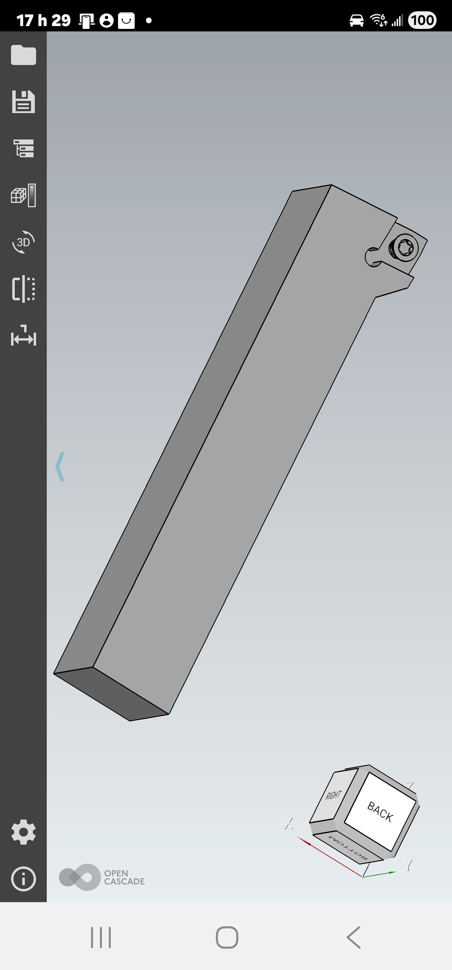

3288A814_Turning Carbide Insert Holder.STEP (1.1 MB)
You can download many models from McMaster and many tooling companies. This one come from McMaster

My apologies for the delayed reply. Here are a handful of our lathe tools in STEP format. If these work well for your modeling in CAM I can get the remaining models of the tooling we sell posted on the forums and listed as related documents on the tormach.com website.
36058.STEP (215.2 KB)
35650.STEP (188.6 KB)
33134-HOLDER.STEP (203.6 KB)
33134-BLADE.STEP (163.5 KB)
