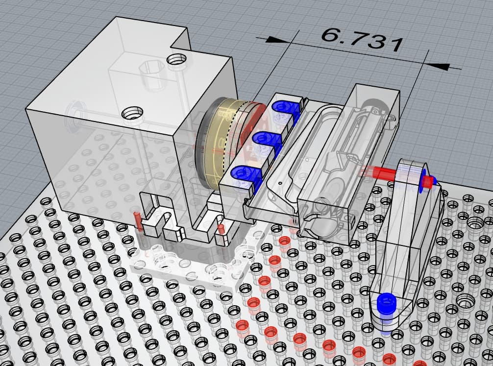

Also, has anyone used these China & Taiwanese (Amazon) tool stocks to aid in additional support for 4th axis work? Need to support my next part (an airsoft carry handle upper receiver) on the Micro Arc. I feel like this import, Amazon tail stock, would work just fine. Im also considering a custom-made one as shown in my screenshot, but trying to avoid it if possible, would rather just buy one. ?
