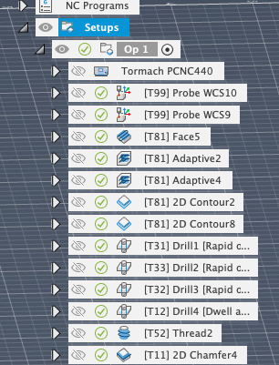

For instance… on this Post it is
Face op - adjusts to tool and working as normal
Adaptive - pulsing up and down
2d contour - pulsing up and down
Drill - adjusts to tool and working as normal
Thread - adjusts to tool and working as normal
2D chamfer - pulsing up and down

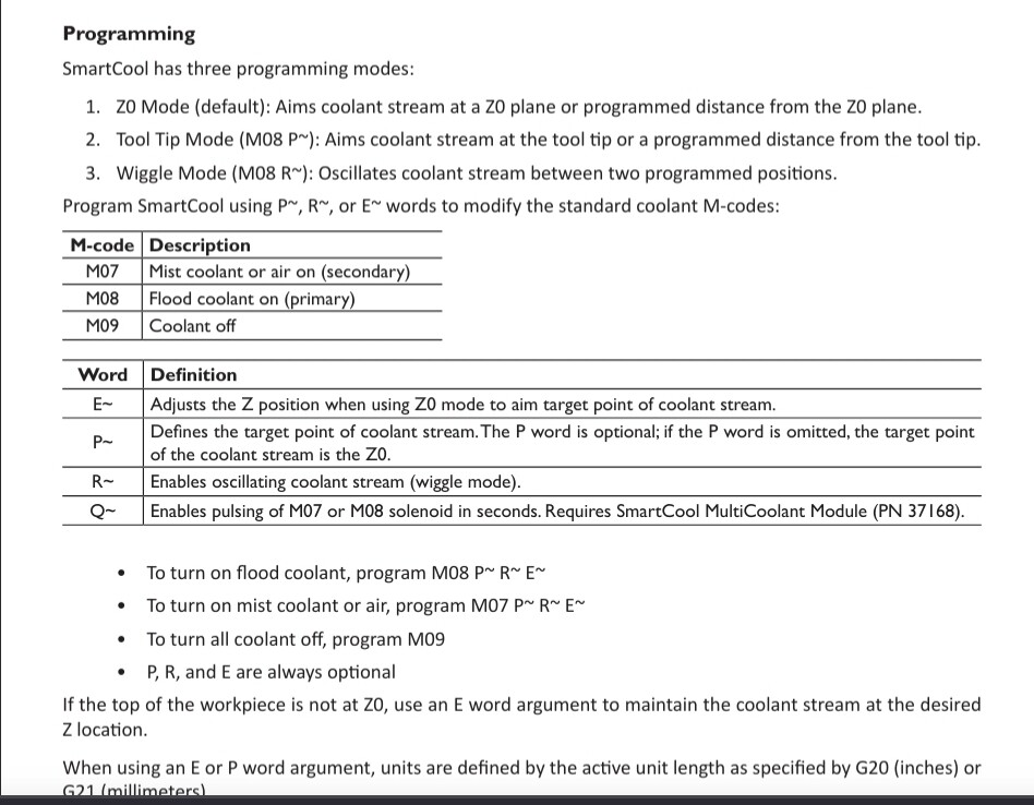

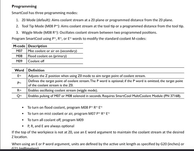

I saw this as well recently. It has to do with the way fusion is posting, not a PP update. This wiggle is an optional mode in the smart cool, nothing to cause concern.
Check your post configuration for one of these programs. I don’t remember the relevant option but it was pretty obvious when I dug into it a few weeks ago

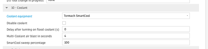

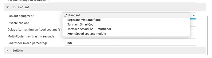

Figured it is something to do with Fusion or PathPilot updates… been looking but all I see in Post is
a SmartCool “sweep percentage”… and not sure what that is or what to try.
Then, because it is only doing it on half the tool ops and not on all of them…it has to be a setting in each tool op specifically…and not overall in post I’d imagine…?

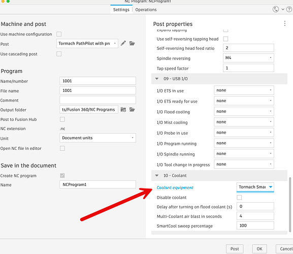

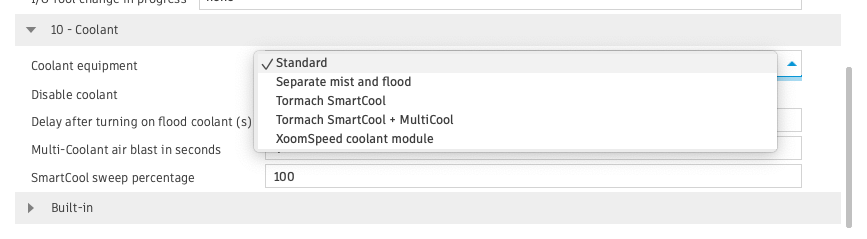

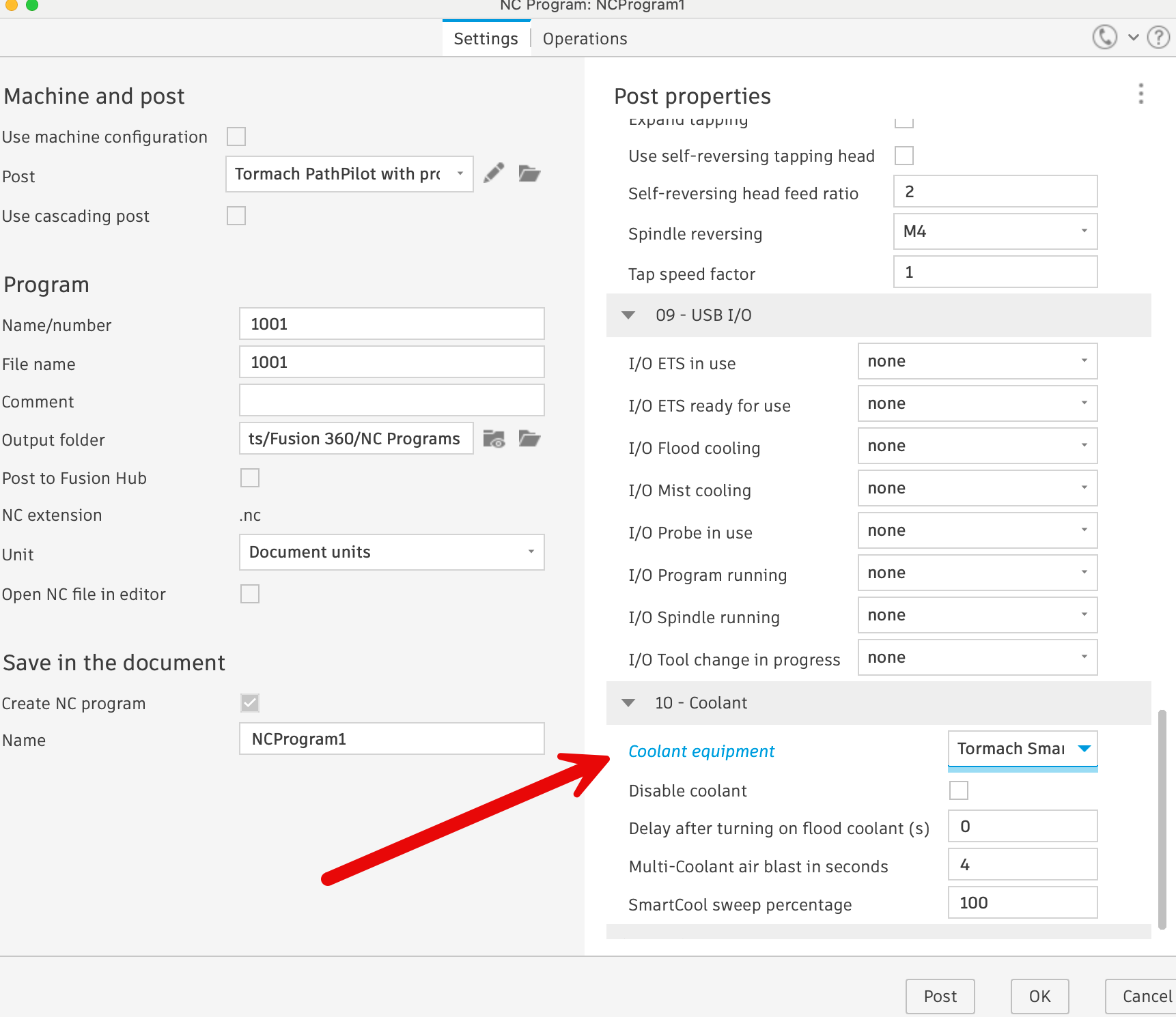

Is this what you are referring to?
Oops you beat me to it!

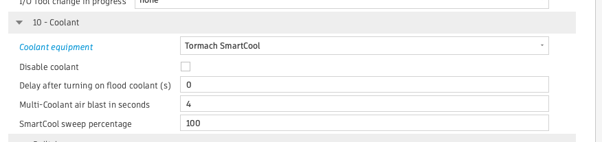

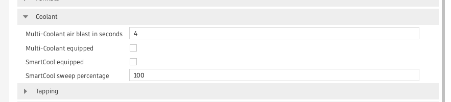

And looking at the difference between Tormach post and Xoomspeed…
Tormach
XoomSpeed
So must be either the Coolant Equipment field is a conflict or Multi Coolant air blasts…
So finding out it is in fact the XoomSpeed Coolant equipment…it no longer likes if you choose “Tormach SmartCool” as I had… flipped it to “Standard” and no longer doing it. :+1:
Elusive, yet in the end an easy fix
Glad you figured it out
The field to pay attention to there is the “sweep percentage” which is referring to wiggle mode.
