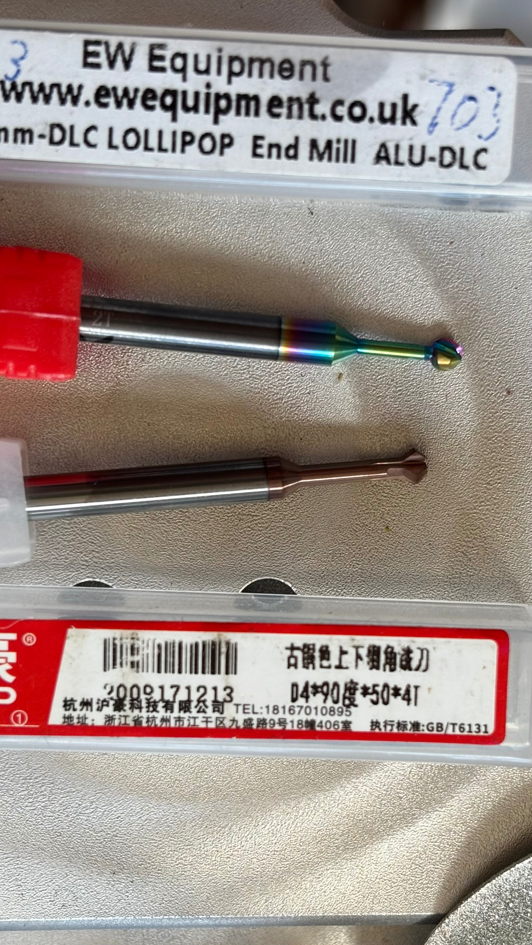

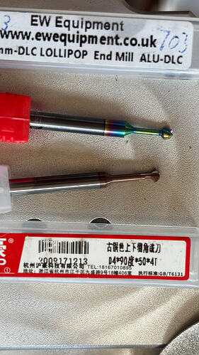

I have an 1100 but I’m making watch parts. I don’t think power will ever be your problem unless you’re singing thick slitting saws in hard metal. I’m assuming if you’re cutting o-rings you don’t need much depth. Have you considered t-slot mills or a form mill instead of slitting saw? Maybe even a lollipop or top/ bottom chamfer mill.

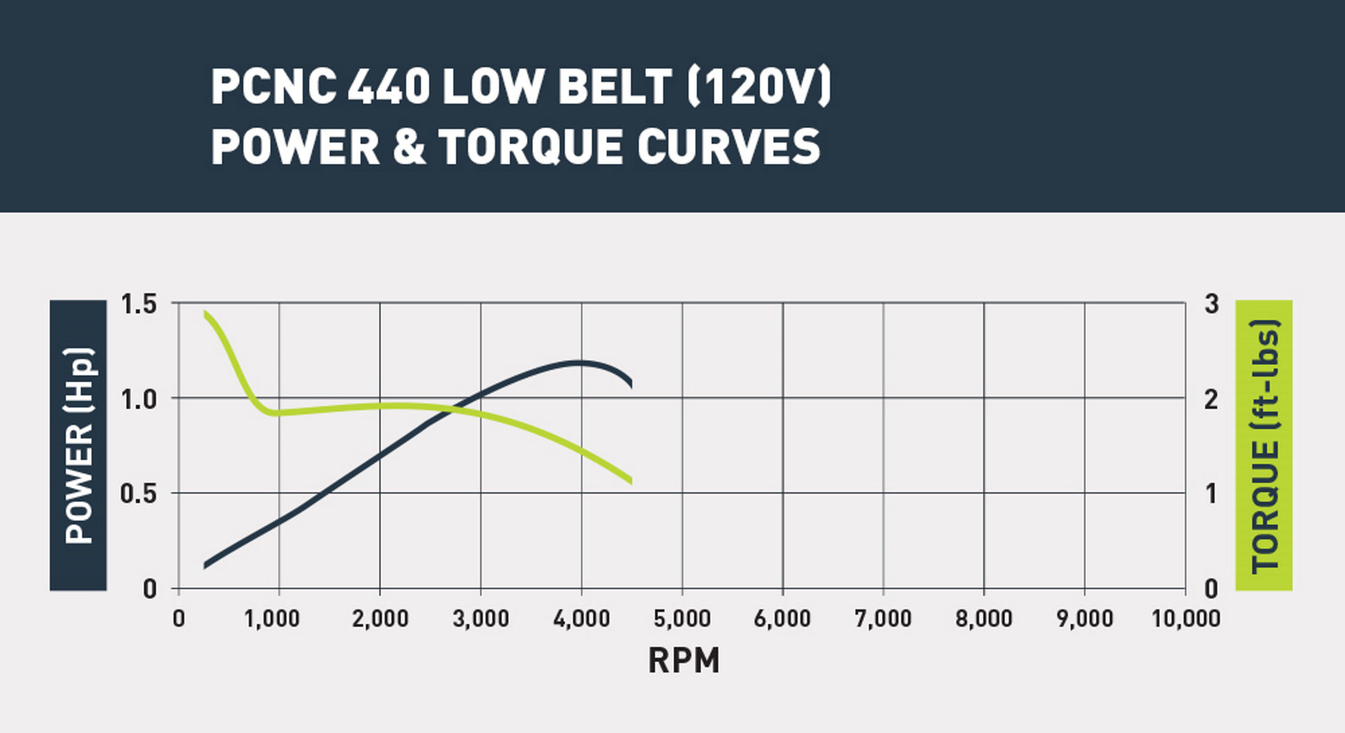

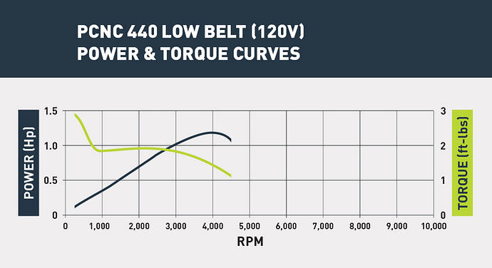

440 has 3/4 hp, so 600 rpm i expect to be pretty wimpy. 600rpm is minimum i believe on 440. Hence the request for 440 owners to share.
I have thought about tslot cutters but it seems like oring sizes fall in line with saws better & you can stack saw blades to get the width you need. It seems like tslot cutters dont have the depth needed for orings. With saws you have ample blade so oring depth isnt a problem.
From: PCNC 440 Torque Curves | Tormach Knowledge Base
I’ve got that chart but I dont know how that translates to real world.

Using the chart to program F&S and how I’ve found it translates…
The 1500MX has curves for running over 100% short duty. I find that I have to treat this curve to already being above what it can deliver at 100% for extended periods of time. On high belt, if I try to program to the limits of the chart (using FS/HSMWizard), it gets “sketchy” in that it may run for a while but I may have to watch it while running and may have to feed hold as I hear it stall and then have to back down the overall parameters down if I was to run production (which means that part could have bad finish). It will run but then stall over multiple passes or length of an adaptive pass that doesn’t “breathe” for less engagement/move without cutting given they are generally adaptive Fusion paths and would need to back down the rates.
I’d like to hear if a more experienced machinist has a different opinion or process of this curve on the 440. I consistently hear that Tormach want fast, light and NOT wide.
Not knowing how aggressive you have tried in the past, where I’ve had this chart front and center since I first started programming mine and was always trying to reach the maximums, I wouldn’t recommend using more than 80% of the advertised power/torque if you want repeatable and hands off. Maybe 75% at most.
If you haven’t been using the chart when programming, I would suggest taking the F&S of an operation you are confident of and are using in production. What is the calculated torque/HP for the F/S/DOC/WOC? Compare the calculated value to the chart relative to how close to the limit you are pushing it in percentage. I would then program the slitting saw with that % of comfort against the power/torque curve.
I would probably spend some time with FS/HSMWizard to see if there is a combo of F/S/DOC that will run on high belt. Probably not possible to stretch that one given your F&S is calling for close to minimum RPM, though…
