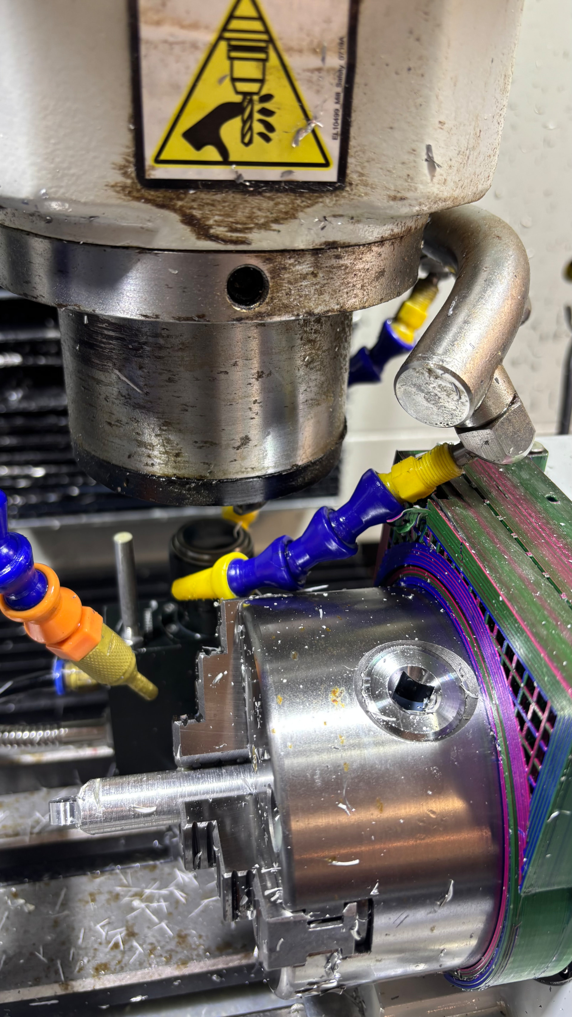

After a near miss on my tool setter / MicroArc today (because I forgot to load the tool) I thought of a suggestion.
Have a minimum safe height for the head when measuring tool length. Could be helpful if the tool doesn’t load from the tool changer, if the tool breaks, or if you forget to load the tool like me and the head is stopped only by a quick operator that hears crushing 3D printed MicroArc chip guard. I got lucky and it didn’t hit the ETS but it was close.
It could be a button on the ETs setup page. You just crank the head as far down as you can over the ETS (without touching anything ) and that’s as far down as the head goes when measuring tool length and then throws an error if it gets there.
We can enable this ourselves right now but it requires we modify the ETS probing routine file that I noted in the other thread for adding an air blast to clear chips off the surface
