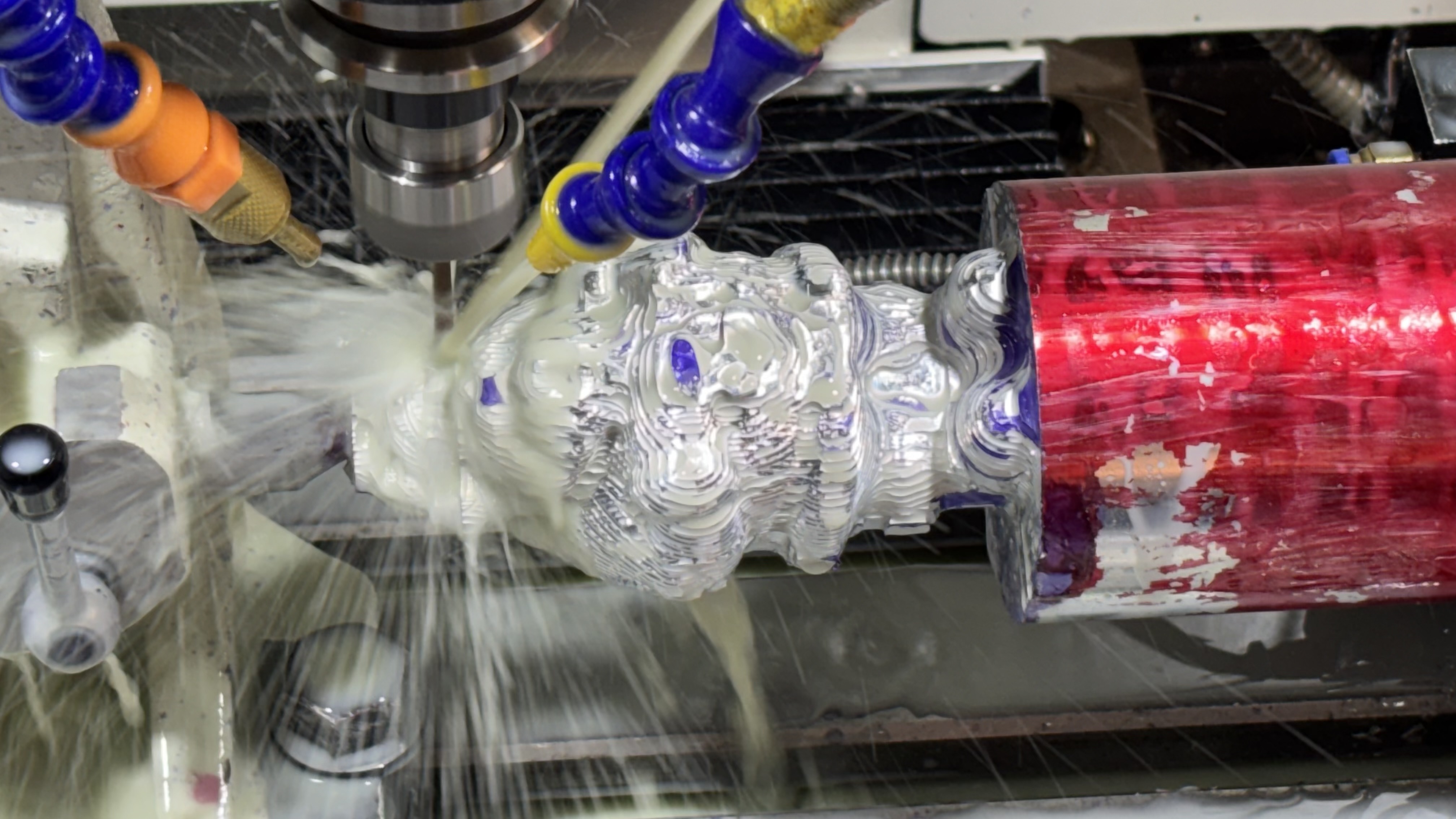

Running the first one today.
I changed my program down to just 3 tools for the Santa. Also using a 4flute ball for the last operation. Also I don’t have the extension for fusion to alter the spiral path so I had to try and find a 1/8 inch end mill but no one sells them here in the UK.(except Amazon,) so we will see how it looks.
The final spiral pass is 21mb.! 6 hours.
I also decided to use the tail stock on the first one. Will figure out how to finish the top of his head if the end mill makes it to the end and has a good finish.
Maybe I’ll put a little hat over the hole?

In the code for the final pass with the ball mill there are these
||617048 G1 Z1.0529 A-584995.597|
||617049 G1 Z1.0485 A-584996.091|
||617050 G1 Z1.0386 A-584997.083|
||617051 G1 Z1.036 A-584997.455|
=====> ||617052 G1 A-584997.467| <========
||617053 G1 Z1.0424 A-584998.084|
||617054 G1 Z1.0447 A-584998.334|
||617055 G1 Z1.0498 A-584998.832|
||617056 G1 Z1.054 A-584999.329|
||617057 G1 Z1.0608 A-585000.319|
||617058 G1 Z1.0628 A-585000.813|
||617059 G1 Z1.0641 A-585001.797|
||617060 G1 Z1.0652 A-585003.271|
||617061 G1 Z1.0649 A-585004.253|
A lines that for some reason the feed runs at (1.2 to .2inch per minute.) Each one takes from .5 to 3 seconds to run and there are thousands of them.
There is no z move with them as you can see and all the other lines run at the programmed feed rate. Here’s the first lines of the program. (I copied the text from a photo so disregard the weird lines and 0 that are O.

I’m just wondering why the feed slows down. Also I was thinking of just doing a text search and remove all of them.
There are 16,000 of these sandwiched between lines that have moves of less than 2-degrees and Z move less than .002in. If I removed all of them I could save almost 2 hours.
Any ideas?
Here’s a video of one.
@Dr_Harold_Jones I suspect that if you remove all of those lines then you are going to break a tool or at best have a sketchy looking part. Those moves have a Z and A component so deleting them will result in some other cut happening at that time. FWIW, when I surfaced this Santa it took around 10hrs but looks great. I didn’t tweak the F&Ss for a turbo fast cut so I might be leaving something on the table.

This is what I mentioned in another thread where a person was having problems with 4th axis feeds and speeds.
Thousands of micro moves
I ended up just running it at 70% and walking away overnight. There were to many thousands of the slow parts and I didn’t have the rotary tool path add on for fusion so I couldn’t reprocess the path.

I use sprutcam and remember certain conditions cause this also.
I wondered if it was stressing the drive was also apart of my concern.

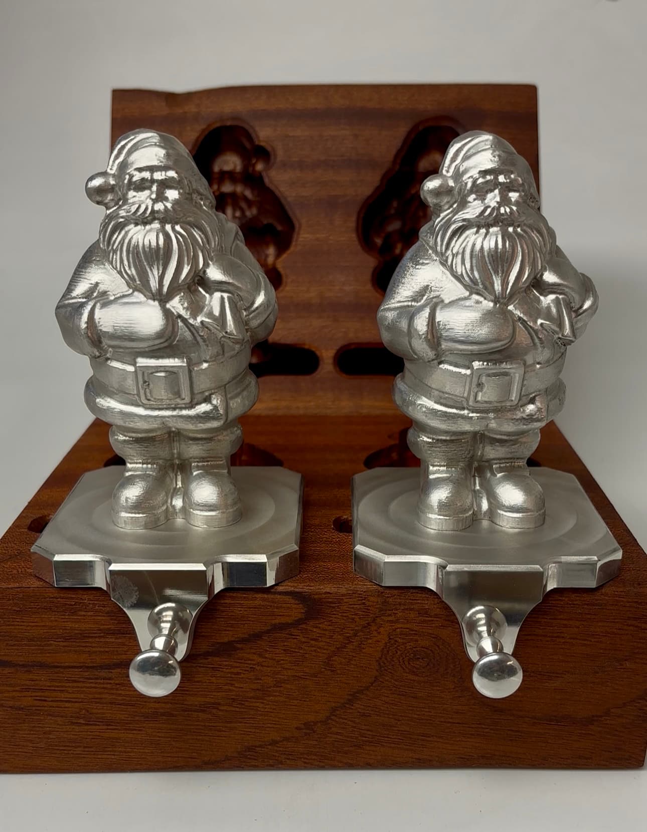

I also added a hardwood box for mine.
Wowza! Those look amazing!
I’m curious to hear your order of operations on turning the knob. That was tricky for work holding at first.
Did you carve Santa into the box lid as well? Very cool
That knob was actually mill turned on another spindle that I mounted to the table. I never found a post that worked for fusion for my sherline lathe.
