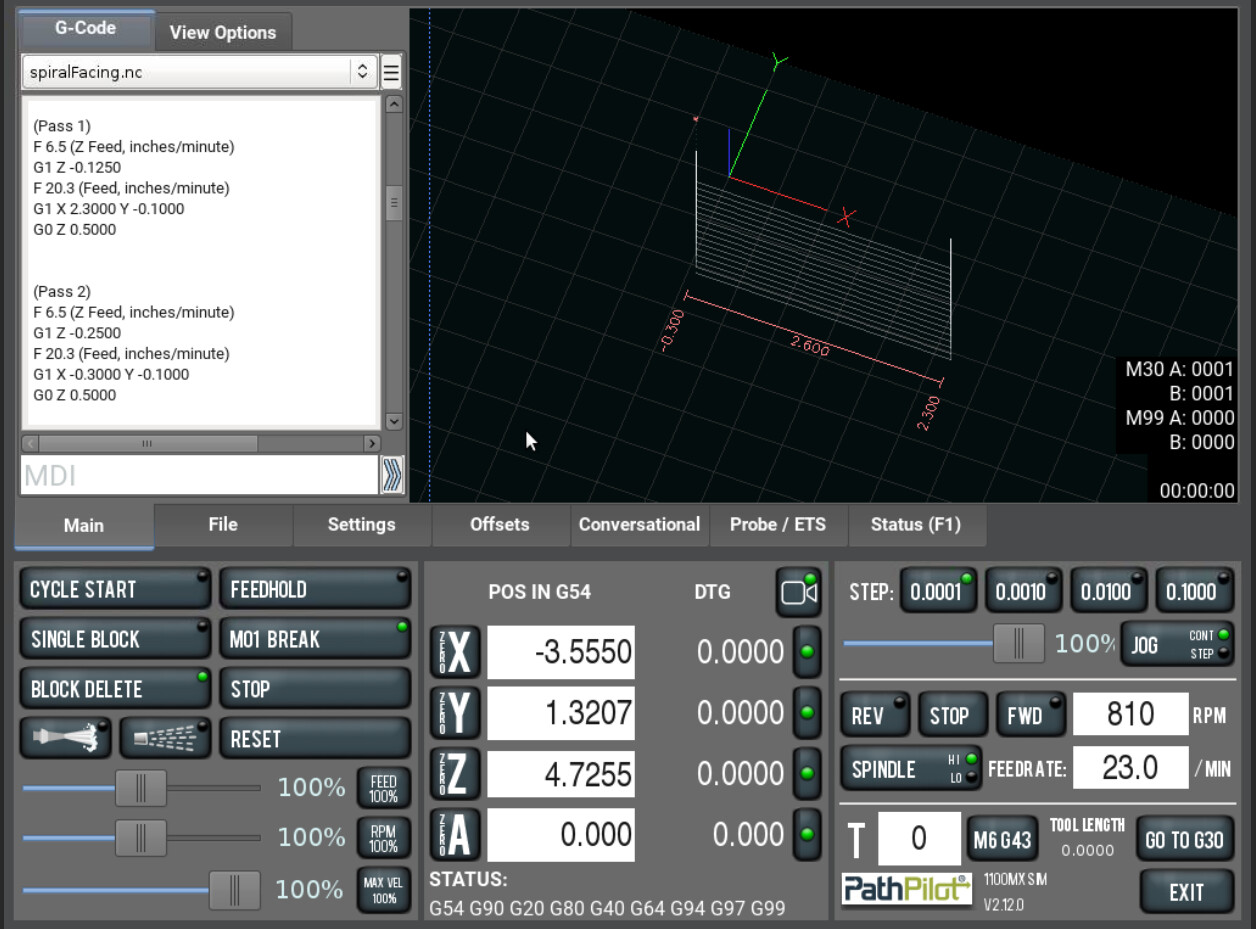

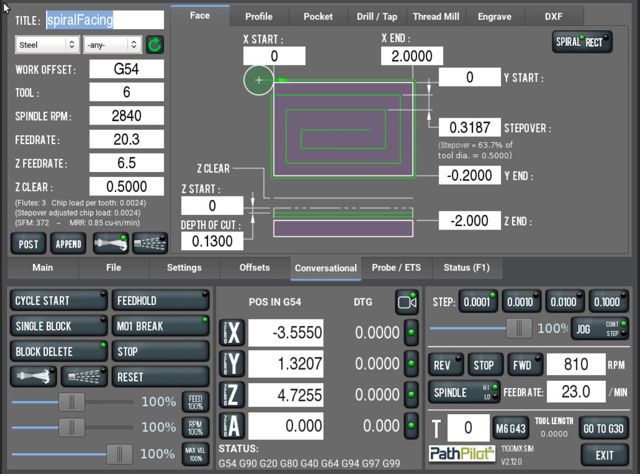

What is the point in retracting to clearance plane in conversational facing if the part is narrower than the cutter and the toolpath is just back and forth movement in either X or Y axis? That happened on 1100MX running PP v2.12.3, but can also be reproduced in the virtual controller on the PP hub (v2.12.0, see the screenshots). The z retract to clearance immediately followed by z move to the next z level doesn’t make much sense to me.

The general spiral retracts only 0.1" from the finished Z level before rapid XY move to the start of the spiral. In addition, the back and forth move goes to the next Z level at both ends of the travel without XY rapid to the beginning. So, it does differentiate.
