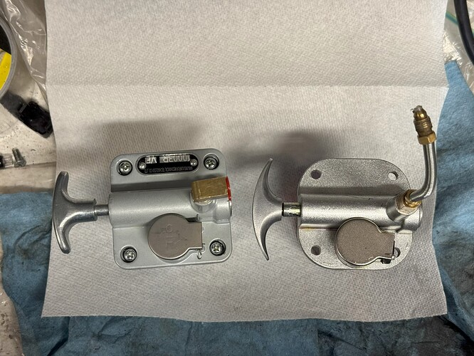

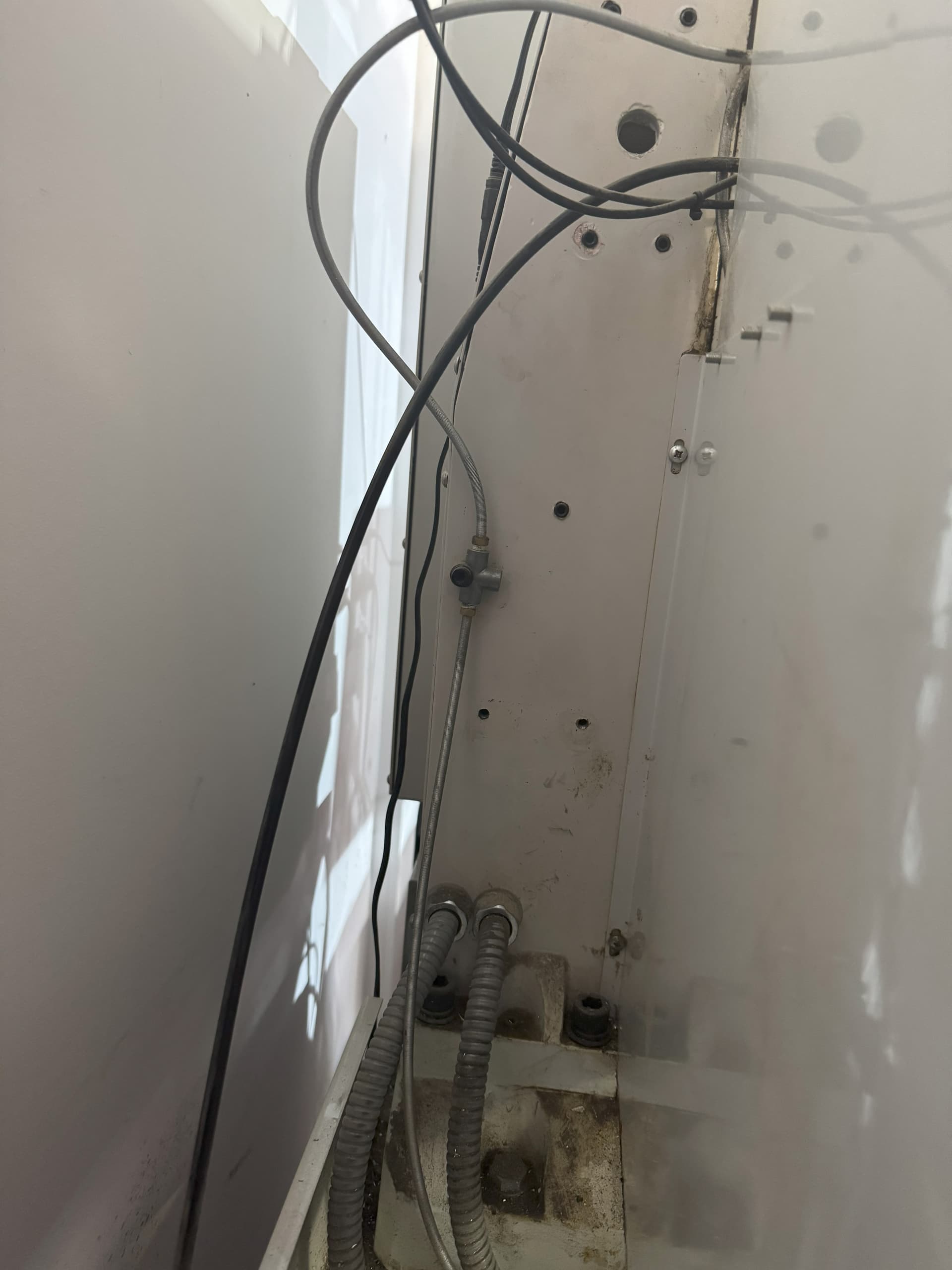

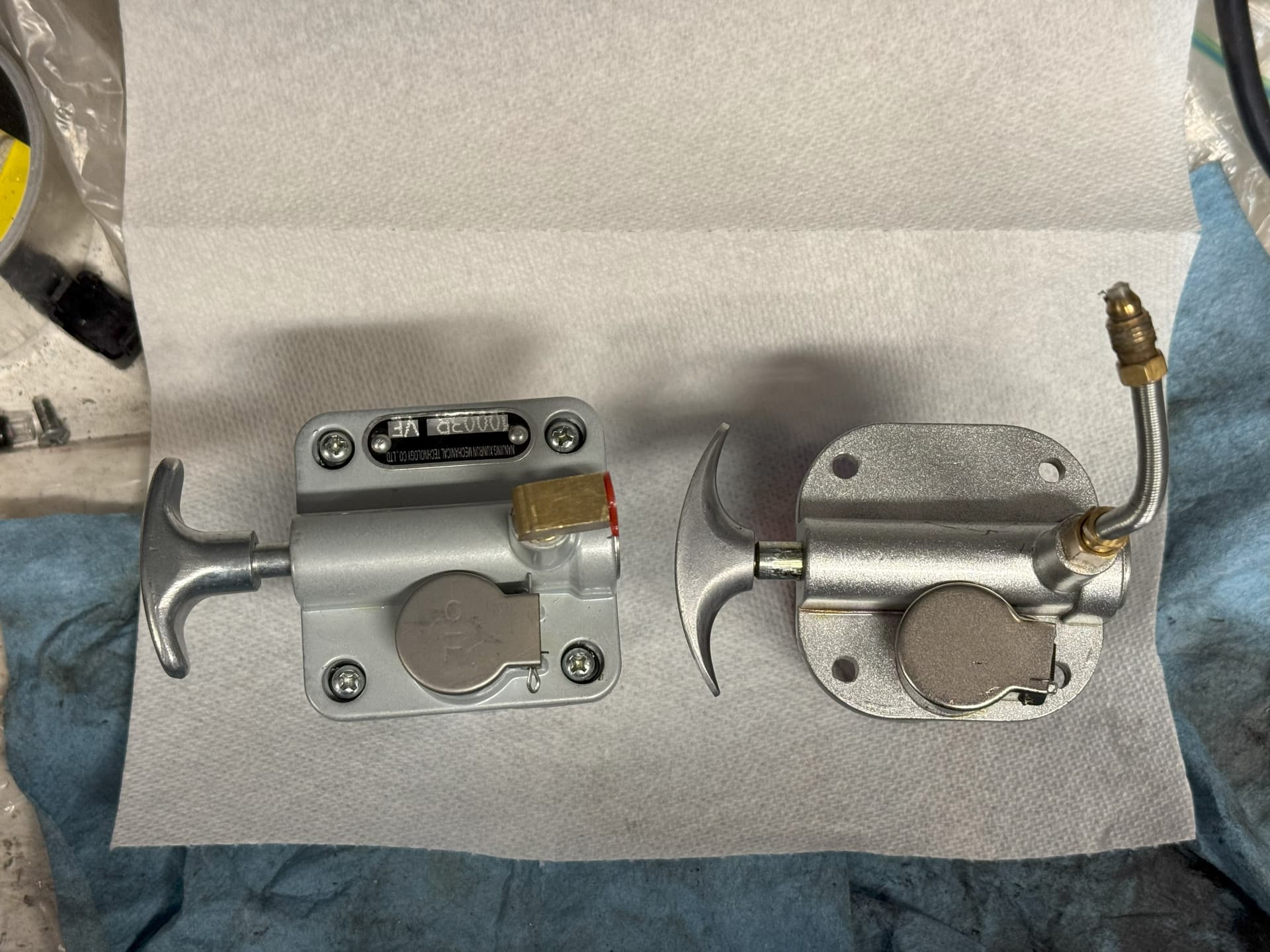

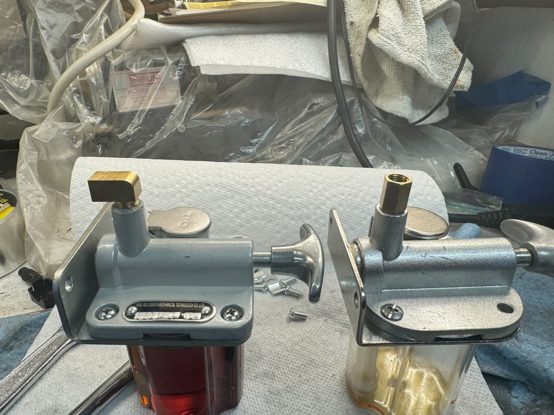

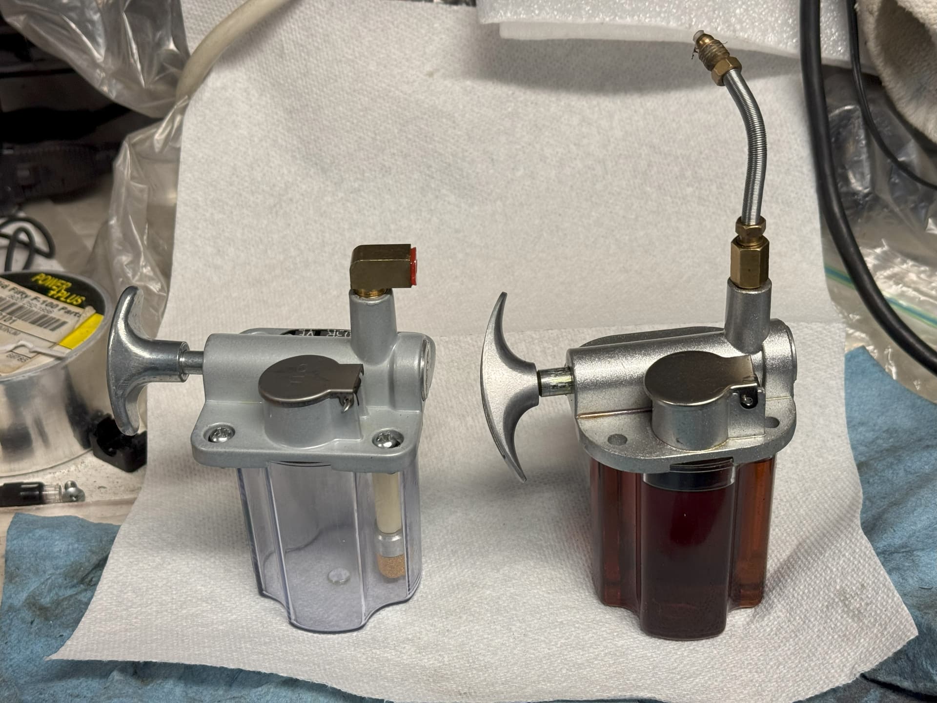

I purchased a replacement manual oiler (PN 38953) because the original one does not work. I received it yesterday and tried installing it today. It does not match the old one and the oil line fitting does not work with my existing oiler T-fitting. I am not sure how this is supposed to be run now, but the 90-degree bend on the top does not work with my mill. I included pictures to show the difference between them. I cannot use the original top straight check valve as it is smaller than the new one and won’t screw in. Not to mention, the check valve is now built into the main part instead of separate like the old one. I cannot find any diagrams (besides the not helpful one in the manual) on how to mount this and connect it to the T-valve on the machine. Are there instructions on how this connects to the T-valve, and can anyone share pictures of what it should look like installed? Otherwise, I cannot use this and will be stuck with an old broken one and an incompatible new one.

I replied to the Service ticket you submitted on this subject. Please provide the information in my reply and I’ll get a replacement out to you. The issue is that he 440 actually uses a slightly different configuration pump and is listed under part number 35722 (see the manual). That part number is not on our website and has to be ordered by either calling or emailing. The pump on the website erroneously lists being compatible with the 440. We are taking actions to correct that. Thanks!
