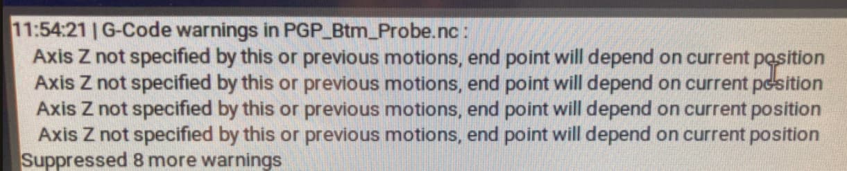

Well still chasing this down. When the machine is turned on from cold shutdown the probing routing works for the first part probed then the error trips on the second part.
Resetting the program and running it again will cause the error every-time after that.
I’m also getting an warning I’m trying to understand now when importing my fusion code… I’m not sure if they’re related but they might be.
I’m probing X/Y for my parts as the Z offset is set by the jig. I’m not sure if the lack of a Z probe operation is the issue here.

** Switching from a “partial circular boss” probe routine in fusion to a full circular boss took care of the warning messages **
The XY circular boss probing function is working properly. Using the “XY circular partial boss” option is not working and causes the unexpected contact error and associated warning messages.
