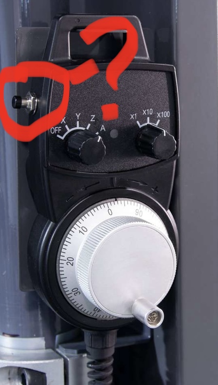

PPconsole Jog pendant button?
Anyone know anything about the button on the jog pendant button
? I can’t find anything.
That is a hold-to-run switch for CE certified machines sold in Europe
Is there a way I can use it? My machine was purchased in Europe in the UK. I would really like to use this button for an air blast or another user defined action. Is there any way to do this?
I guess you could get pretty crafty and use the USB m-code module to watch for this button and act on it but you works have to re-wire that jog pendant.
