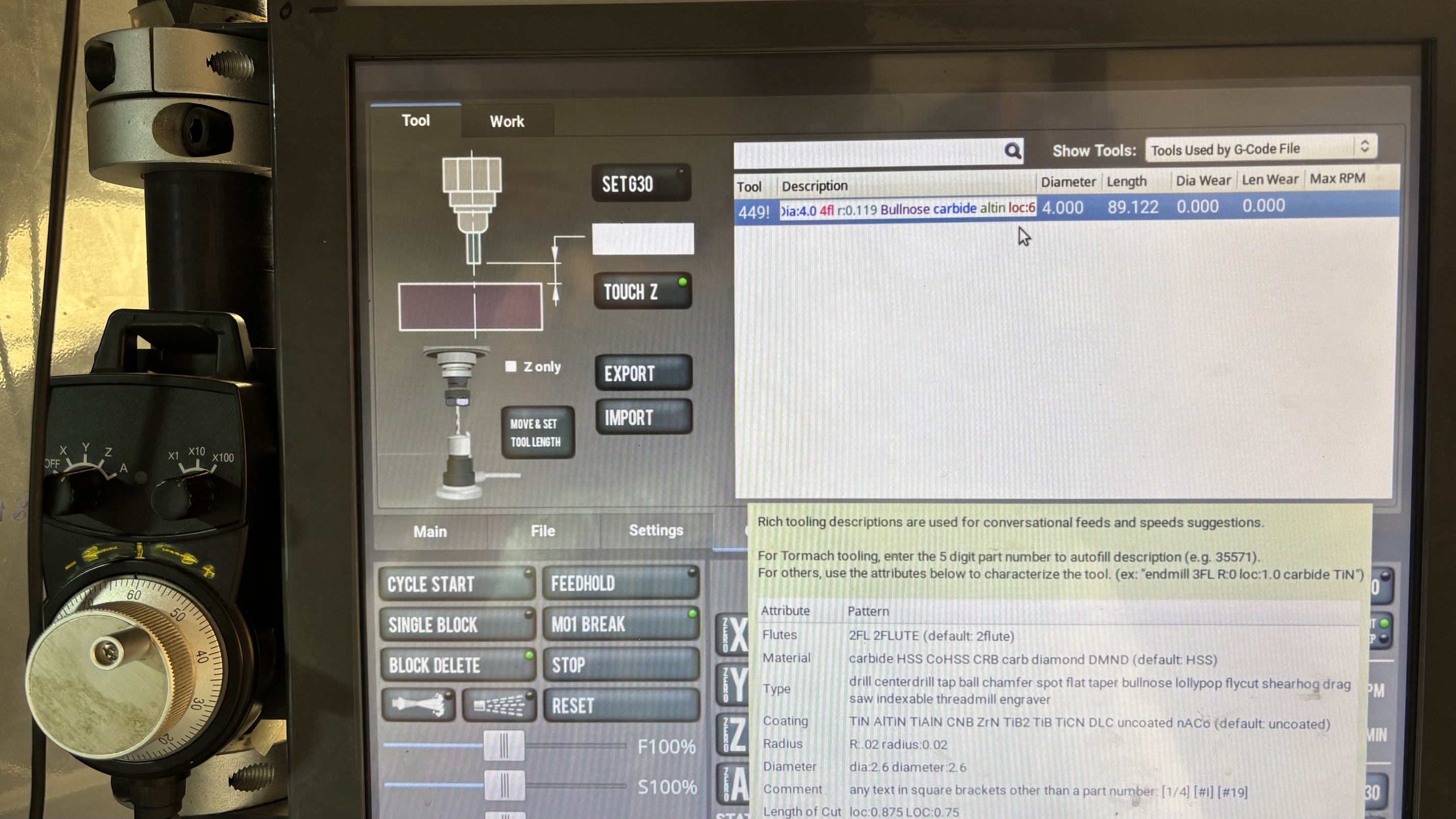

Footnote question.

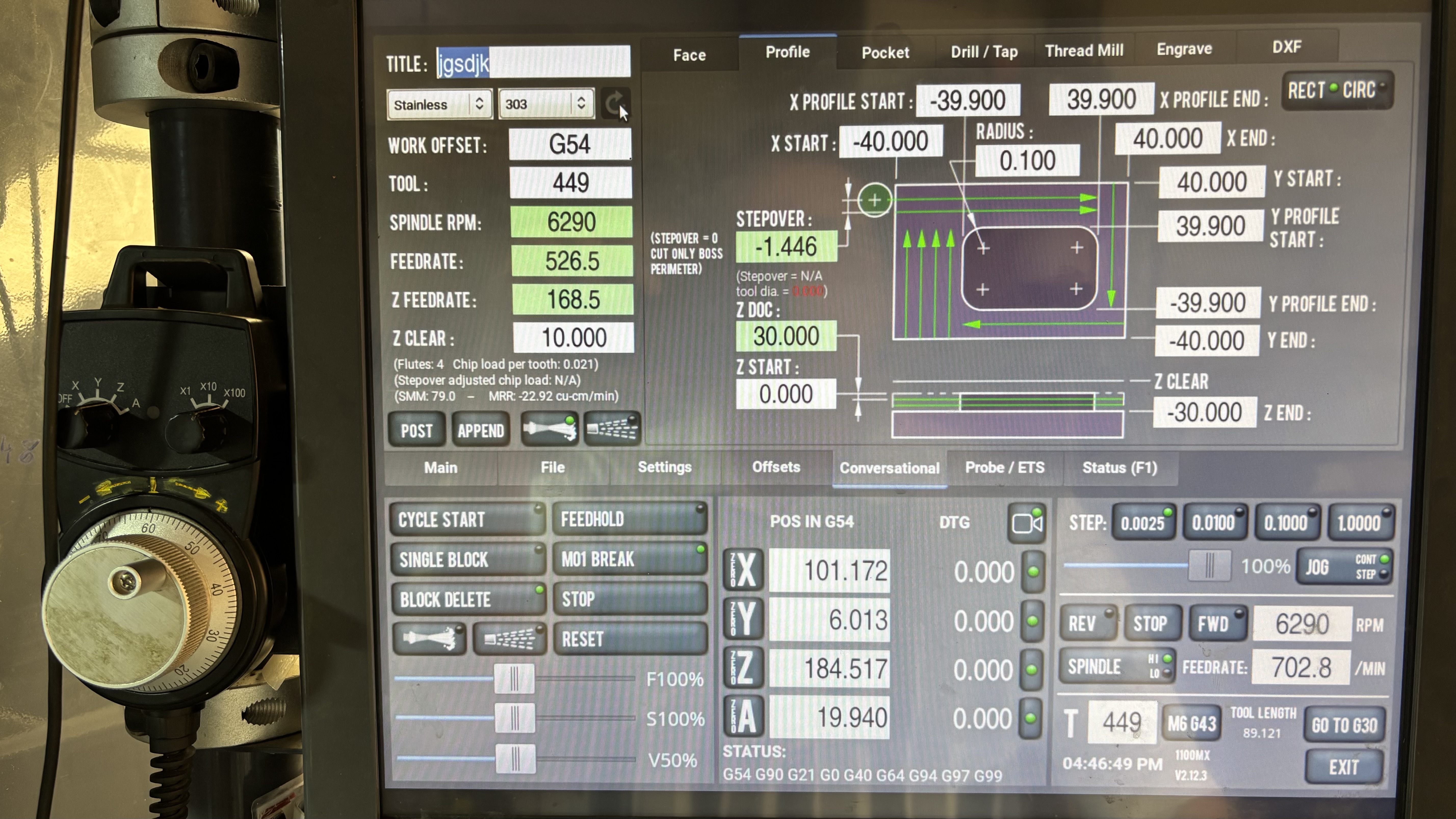

Conversational doesn’t seem to care about Loc:## at least in metric.
On the tool table if I set Loc:4 on the tool, conversational always sets the cut depth as the entire depth.
