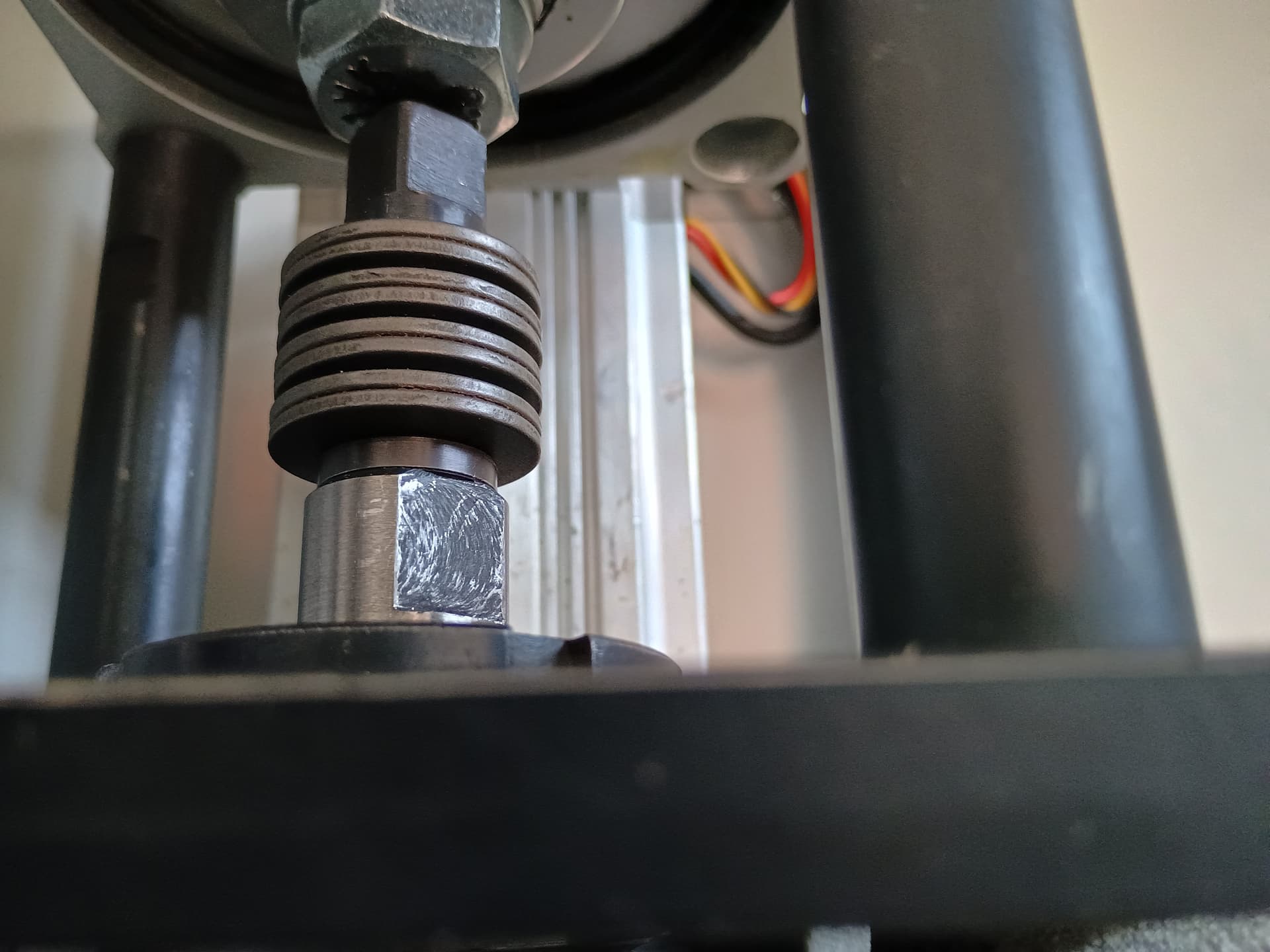

Question about the pneumatic cylinder. I am guessing that the 3 extend ports along the length are because it has multiple pistons in the cylinder? 2 of the retract ports (I am only guessing what those are) are not hooked up. Only the retract port at the bottom of the cylinder has air plumbed to it. The 2 higher retract ports are open. The issue I am having sometimes is that when I press the pushbutton to extend (and release a tool) air blasts out of the upper return port right at the end of travel. When this happens you can see the top of what appears to be the pistons passing the opening of the orifice, creating a gap for the air to escape from. Most of the time the tool releases. Should this be happening? Do I need to adjust something like reduce the travel of the cylinder? The cylinder is mounted on its shoulder bolt; with the qr pin on the other side, and floats vertically like it is supposed to. One thing I notice is that the large hex bolt on the cylinder shaft is not centered with respect to the drawbar. When I pull the qr pin out and rotate the cylinder to roughly center it over the drawbar the system works without any leaks. But I need the qr pin installed to prevent the thing from rotating on its own over time. . Is the piston rod supposed to NOT be centered over the drawbar? Thanks

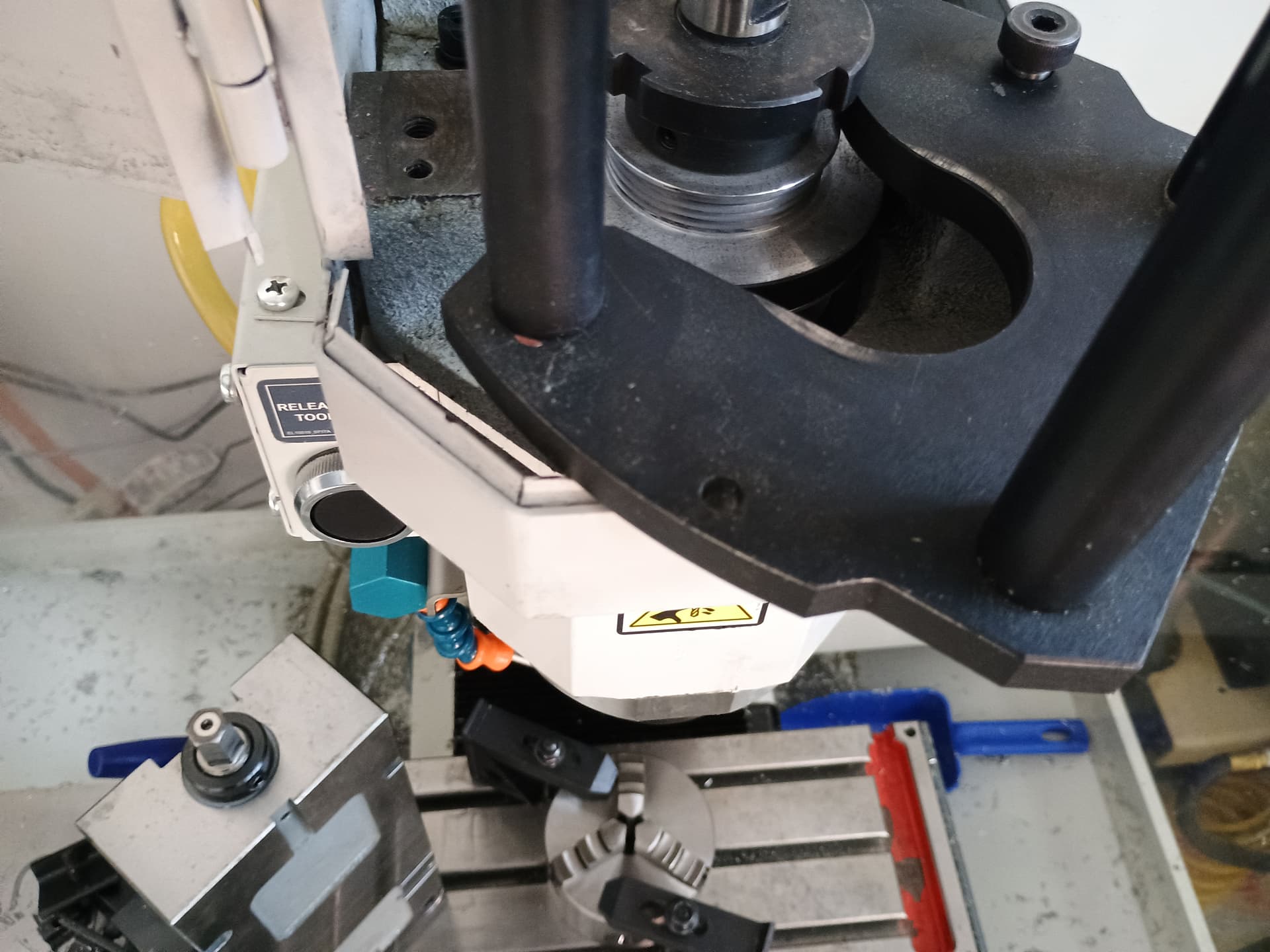

Here is a photo of how the drawbar axis is misaligned with the center of the cylinder. This is with the QR pin inserted thru both the black plate and the hole in the casting.
If I pull the QR pin out and rotate the cylinder about the shoulder bolt to align these axes, the air leakage does not happen. But then the cylinder floats not only vertically, but also rotationally about the shoulder bolt.

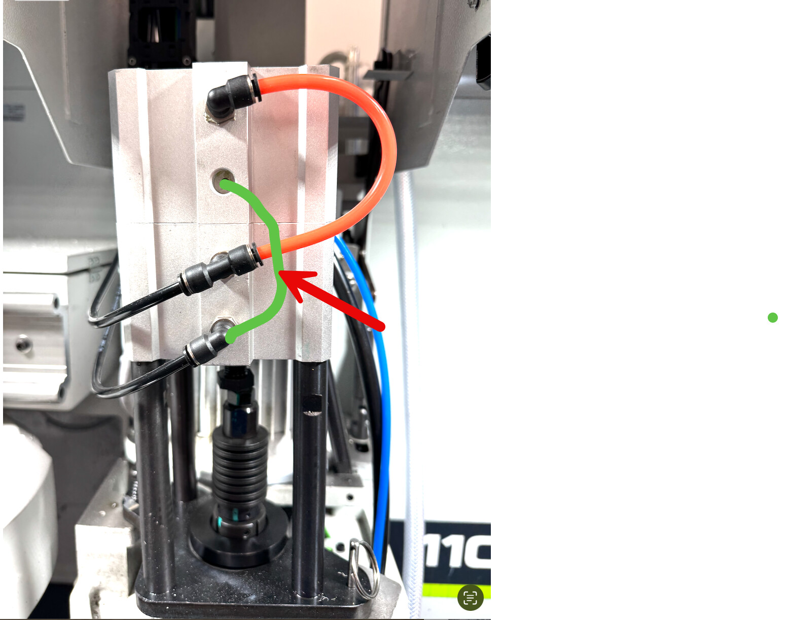

@Ian_Vivero here’s a diagram of what I was talking about. I believe this is what @jwallner was talking about but it was when I first got the machine and I had all I could do to get the basics of the machine figured out. The green line I drew in would tee into the bottom port and then connect to the open port of the top stage.
@Drew_Miller that amount of misalignment wouldn’t normally concern me except that you’re saying if it’s corrected, the air leak doesnt happen which I find odd and can’t explain. Hard to tell from the picture but perhaps you have too much gap between the bolt head and the drawbar allowing the cylinder to overtravel? Even that seams odd though as I would expect the cylinder to be internally limited to prevent that kind of thing from happening.

@Scott_Dube yeah I don’t see how that could cause any issues. It would increase the pressure applied to the retract motion which doesn’t require any real pressure but it’s nothing the cylinder isn’t built to handle.
It’s working fine now that it’s centered but the qr pin doesn’t line up with the mating hole. I am the original owner and the cylinder hasn’t been taken apart or anything.
Looking at my casting there are 2 holes; one’s larger than the other. Neither align when the cylinder is on center and the qr pin only fits the larger hole. I think this could be taken care of if I can modify the floating plate with a hole that lines up. Is there a drawing of the part I could look at to see a)if the hole is in the right place and b)to use to make the change and put the hole in?
Regarding a leak when it’s off center; if the cylinder is pushing with for example 1000lbf, and it’s skewed, it’s conceivable (not likely) that there is a force component lateral to the cylinder axis or even some weird bending that could overcompress a rubber seal on the opposite side of the cylinder, allowing air to find a way out. Seems far fetched but something is happening. I don’t think it’s overtravel; because when it’s centered everything stays airtight. If it is overtravel, it’s probably slight and also related to the fact that it’s off center and might be moving a slight amount more due to a more “glancing” contact with the drawbar.
